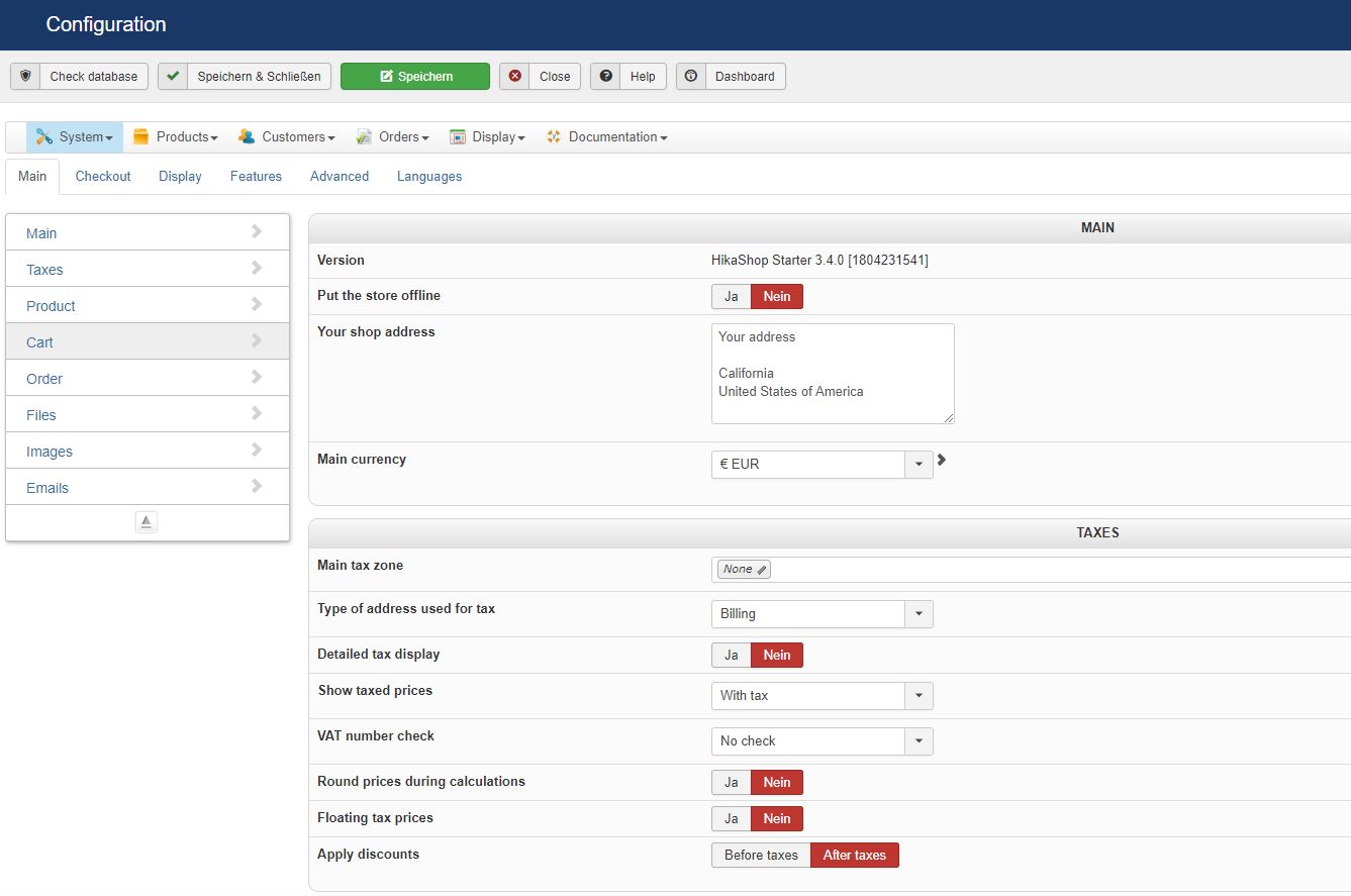

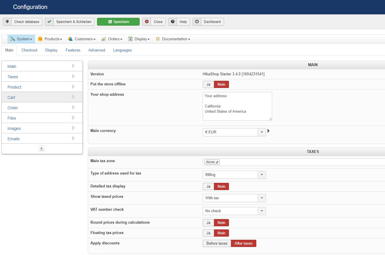

7 years 7 months ago #302931
Your issue is coming from the fact that the Hikashop "German" language file is missing, you'll just have to load it via "Hikashop->System->Configuration->Languages".
For more information : www.hikashop.com/download/languages
Kind regards,
Mohamed Thelji.

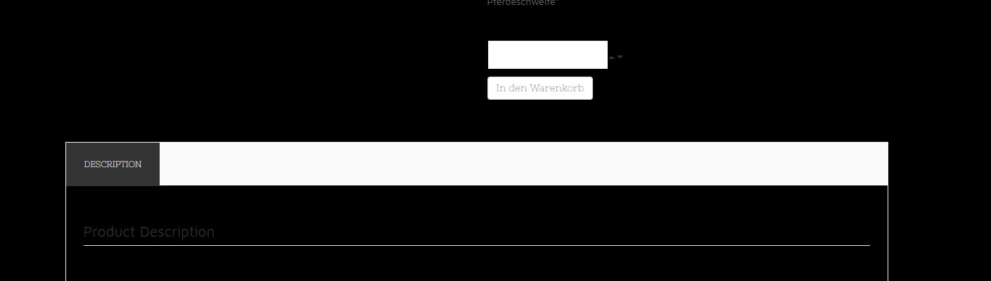

How can I not show the box on all products "Add to cart" and "Quantity"?
I also do not want the label field, how can I hide it?
because I would like to request the persons by mail.

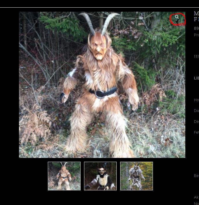

  • Posts: 10
7 years 7 months ago #303022

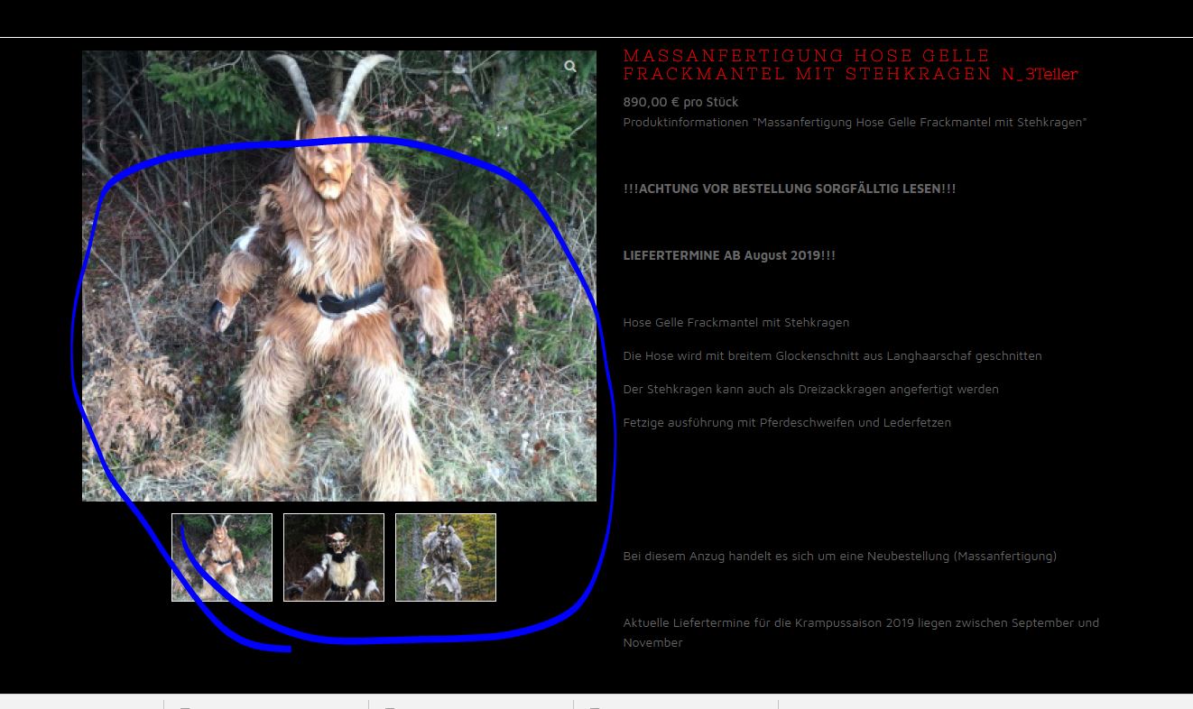

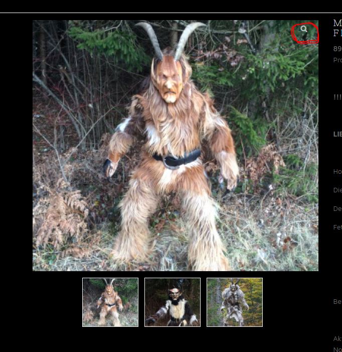

what do I have to adjust so that the picture can be magnified? At the moment I can not select the image below, so it will be displayed in the upper window.

What "box" are you talking about ?
And which label field are you talking about ? I don't understand what you mean.
Please provide more information on what you mean.
  • Posts: 86081
  • Thank you received: 14190
7 years 7 months ago #303035
There should be nothing to do, but maybe I don't understand exactly what you mean.
Could you provide a link to that page ?

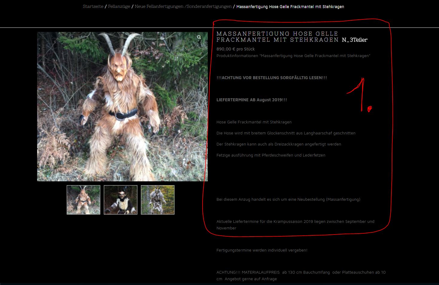

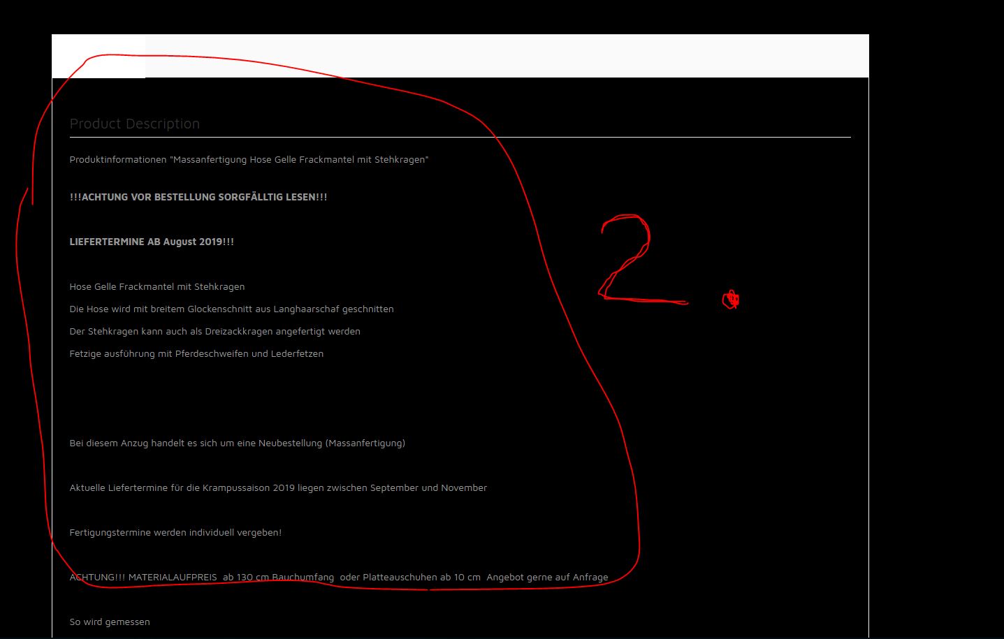

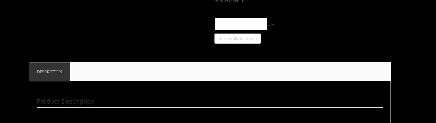

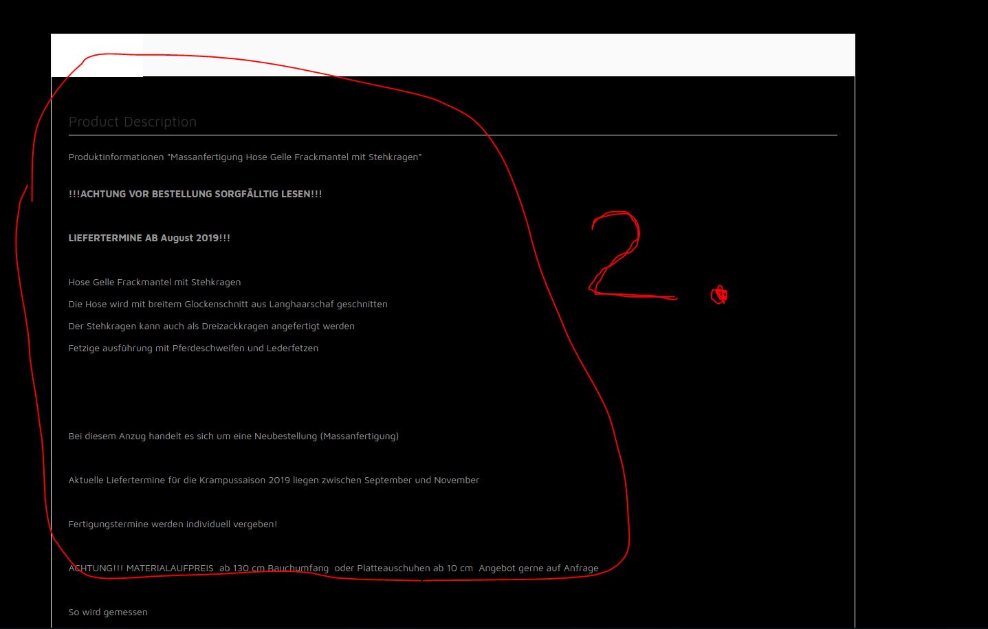

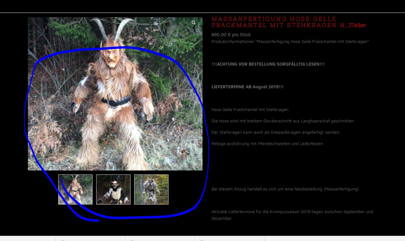

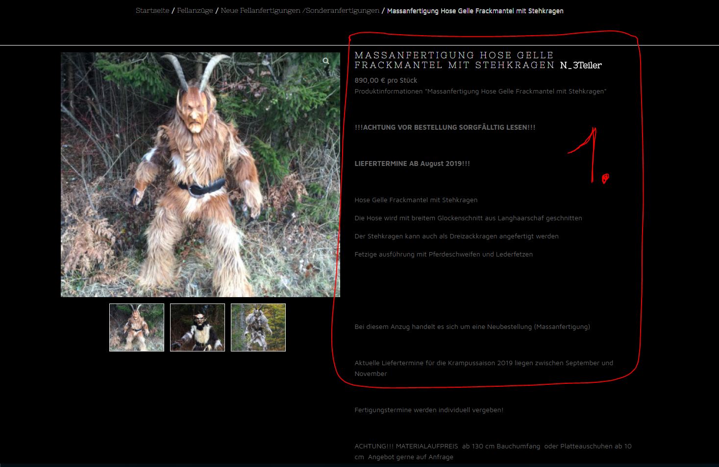

  • Posts: 10
7 years 7 months ago #303080
I'm sorry for my not so good english.
I want to disable the lower box "Description". So the name is only once. Safe Screen:
1. Designation
2. Name (this should not be displayed anymore)
My second problem is that in the live demo the pictures in the shop enlarge.
With me all stay rigid what is the reason?
www.spitz-teufelsdesign.com/index.php/fe...antel-mit-stehkragen
best regards
Manuel
  • Posts: 86081
7 years 7 months ago #303093
1. That's something you should check with your template provider as the product page layout is customized by the template.
I guess, you could add such CSS to remove the bottom description:
.product-details-bottom{ display:none;}
2. There is some custom javascript code added there which has an error. Apparently, this comes from a view override of your Joomla template. The best would be to check on that problem with your template provider.
What you can try is rename the file templates/YOUR_TEMPLATE/html/com_hikashop/product/show_block_img.php via FTP in order to disable the view override on the image area and that might help but you might loose some of the styling added by the template.
