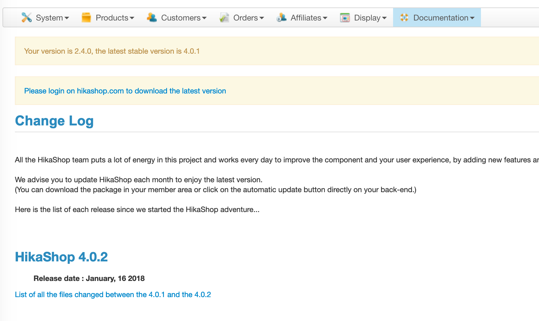

I have just taken over a website with Hikashop installed. It's on an old version number, but it doesn't say what version of Hikashop it's using, ie starter, essential or business...
I have attached a screenshot so that you might be able to help me tell.
It's obviously a big update, 2.4.0 - 4.0.1 - is there anything I should know about making such a big jump. I'm thinking I should do it on a test site first.

7 years 9 months ago #303564 by nicolas
Replied by nicolas on topic Version upgrade query
Turn on temporarily the "show footer" setting of the HikaShop configuration and you'll see the edition name at the bottom of each page displayed by HikaShop.
Note that with HikaShop 3.x and forward, the first setting of the HikaShop configuration is actually the edition and version of HikaShop you have so once you update, you'll be able to easily know which version you have at any time.

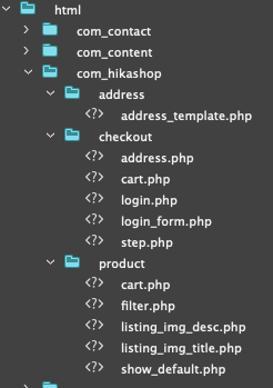

Check if you have the file templates/YOUR_TEMPLATE/html/com_hikashop/category/listing.php
If you do, rename it in order to deactivate that view override and it should fix the problem.
7 years 8 months ago #304721 by dunxmax
Replied by dunxmax on topic Version upgrade query
Thanks for your reply - I appreciate the help you are giving me on this.
I don't have that file in my html. I have added a screenshot of the com_hikashop directory so you can see what's there. There is no category folder.

7 years 8 months ago #304722 by nicolas
Then I'm not sure what is the problem.

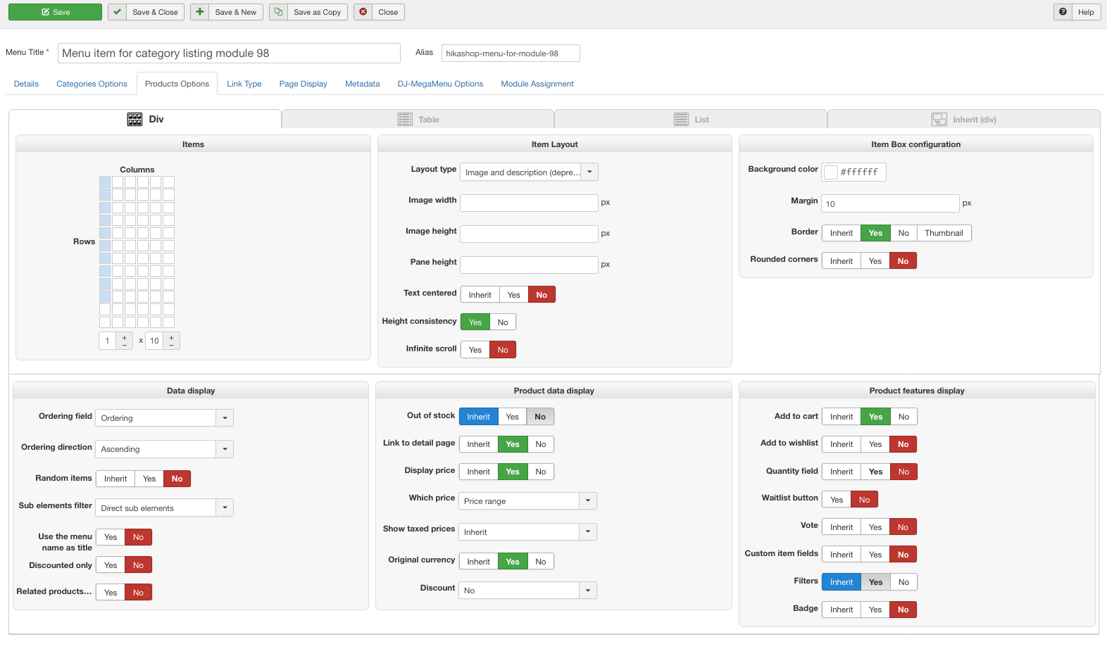

Please check the settings of the menu item with the alias "hikashop-menu-for-module-98" via the menu manager of Joomla.
Please provide screenshots of the settings under the products options tab.
7 years 8 months ago - 7 years 8 months ago #304846 by dunxmax
Screenshot of menu item/product options attached.
Duncan

7 years 8 months ago #304851 by nicolas
The settings look good and it's not an override, so I don't know what it could be.
Please provide a backend access, a FTP access and a link to this thread via our contact form so that we can have a look at the situation directly on your website.

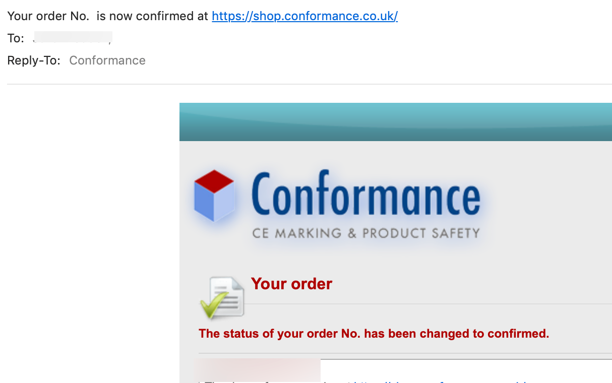

I have now upgraded hikashop on the live version of the site. A problem has been spotted.
The problem is with emails.
The order number is not appearing in the places where it should appear. This was working before the upgrade.
I took a look in the languages and found the various lines, which set the email content.
For example for "subject" it looks like this: ORDER_STATUS_NOTIFICATION_SUBJECT="Your order No. %s is now %s at %s"
I'm not sure how %s is determined, but the %s for order number is not being returned.
I am sending a screenshot to show you the resulting email.

7 years 6 months ago #306104 by nicolas
The %s in the translation
ORDER_STATUS_CHANGED_TO="The status of your order No. %s has been changed to %s."
of your screenshot is generated in the preload of the order status notification email. You can see it in the menu System>Emails at the bottom when you edit that email:
monosnap.com/file/4c4aNxcF2O0R8ZpSxHr1xU6s1ubnhf
However, I don't see how the order number would be missing there and all the rest of the information present. At least not with the code of the preload of recent versions of HikaShop. So either you have modified the preload in some weird way or you have a really old preload override (you can check whether you have an override or not on the listing of the emails) which has a bug preventing it from displaying the order number properly.
