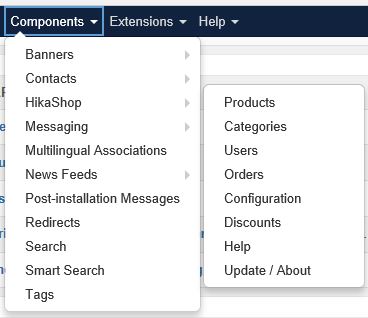

I am new to HikaShop. I have followed instructions for installing HikaShop and I can see it listed under Components:
HikaShop > Products | Categories | Users | Orders | Configuration | Discounts | Help | Update / About
I have entered one product as part of the installation but It is not appearing on the website frontend. Do I need to do some more configuation before it appears?
