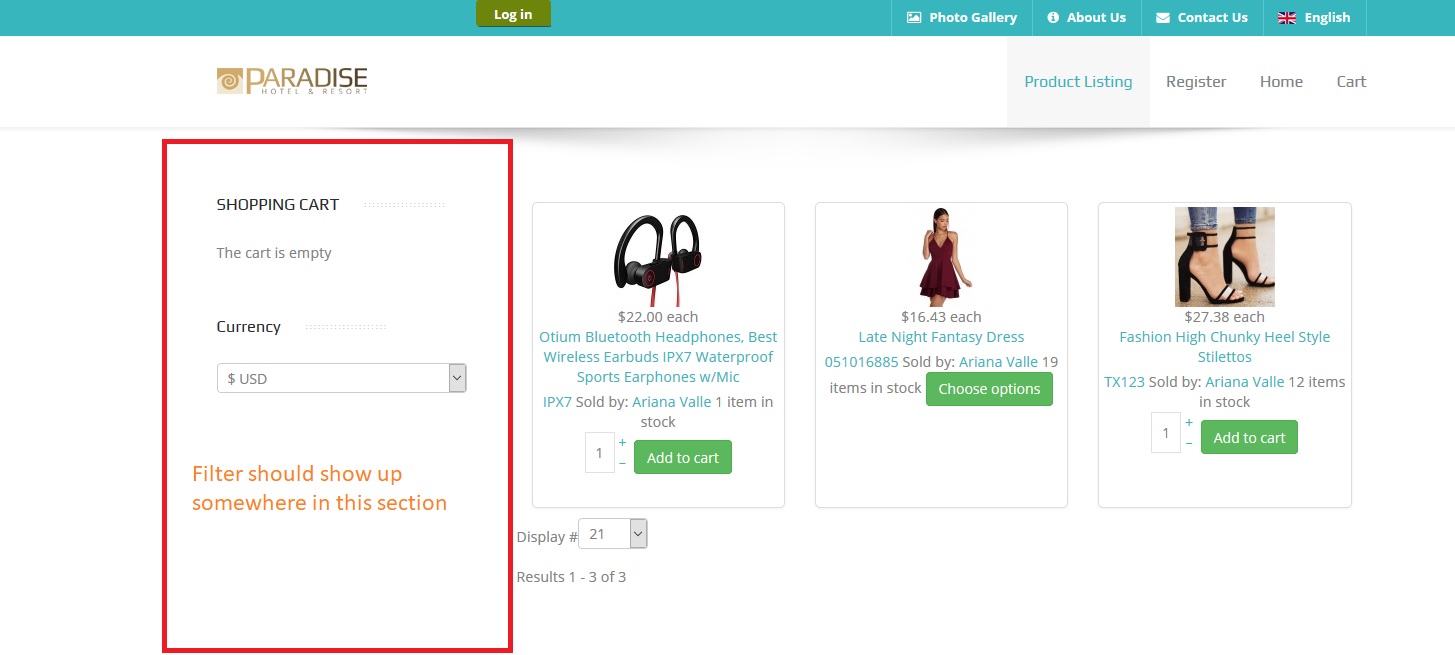

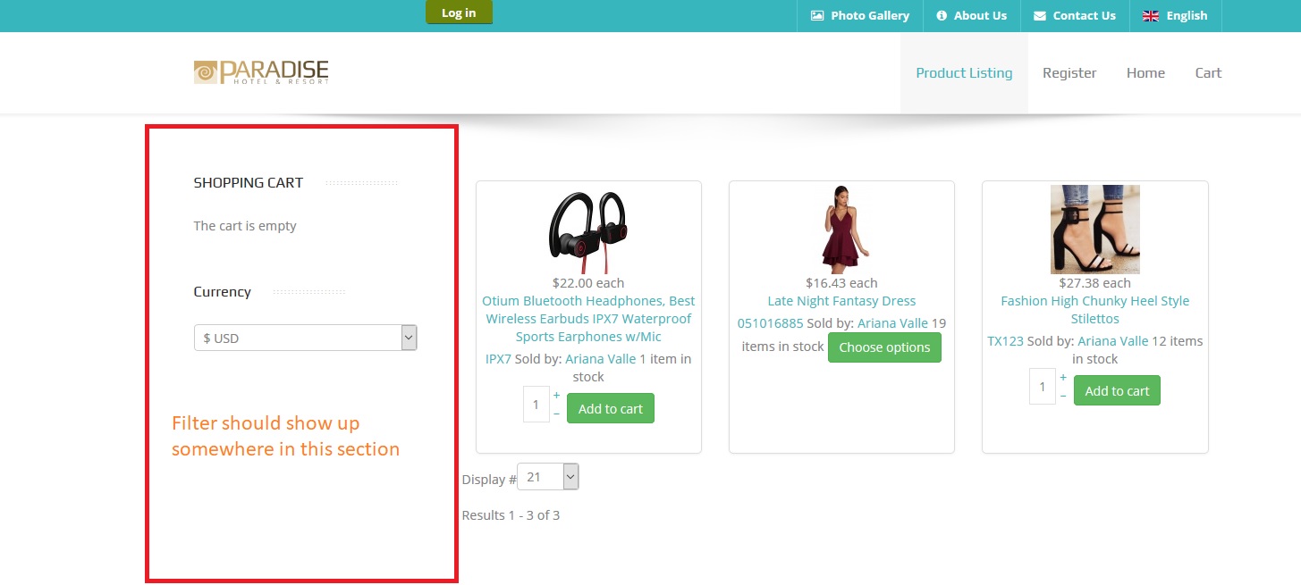

-- Error-message(debug-mod must be tuned on) -- : "HikaShop Filter Module" Does not show.
Hello, There
I have finished my installation and configuration. I have an issue with the filter module/ Search, it does not show on front page. It is published and assigned to all menus.
All other modules shows up fine. Is there an update or a fix for this module or am I missing any special configuration requirement?

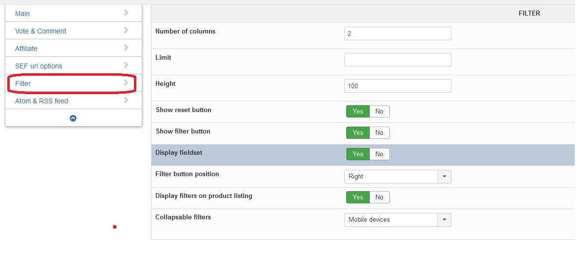

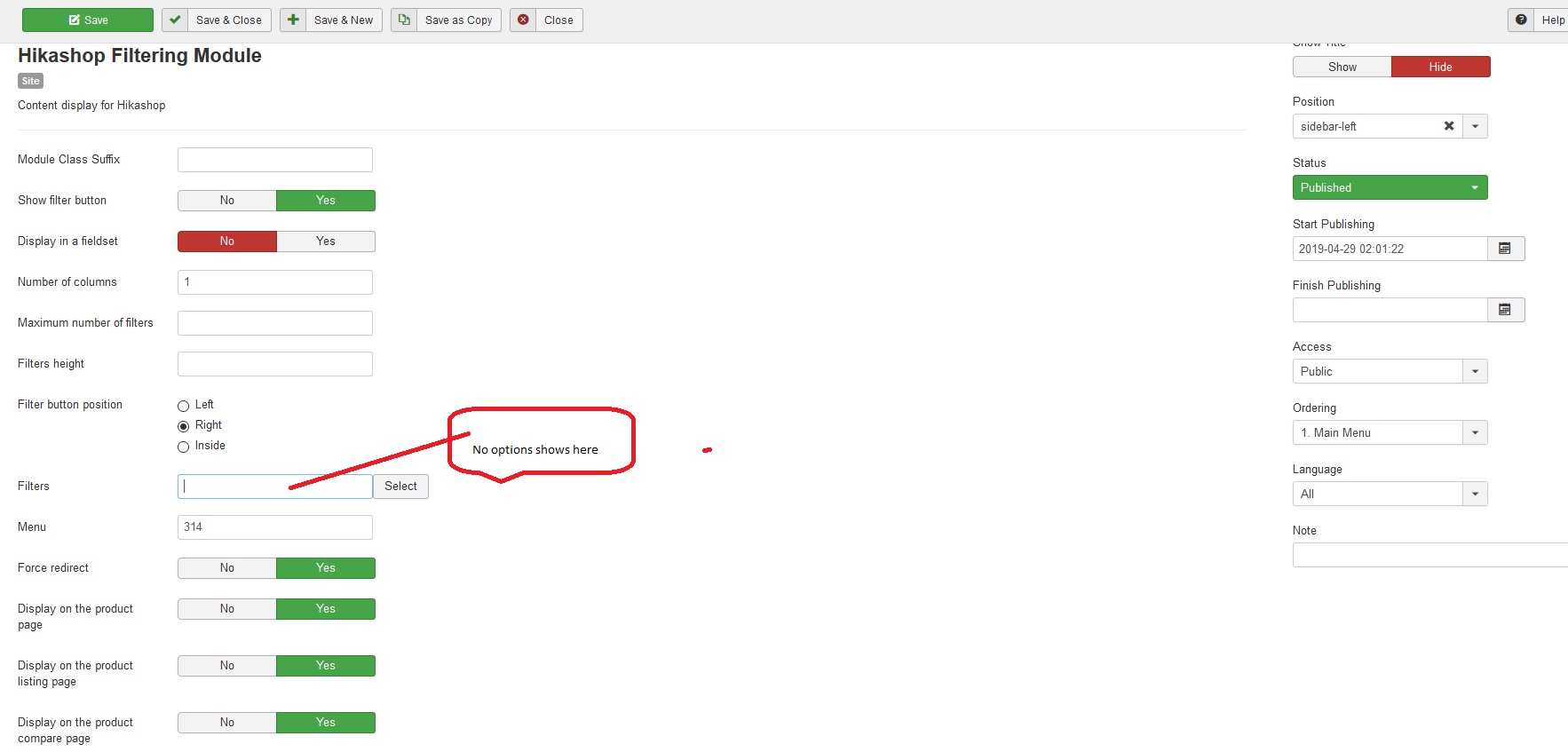

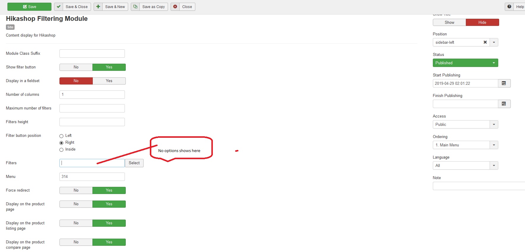

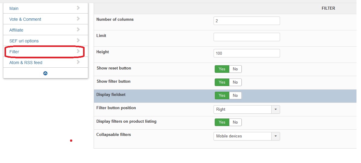

Could you provide screenshots of all the settings of that module as well as a screenshot of the settings of the filter displayed in the module ?
  • Posts: 21
7 years 4 months ago #306113
Attachment of configuration for search filter module
7 years 4 months ago #306121
then I think that you have to create filters, maybe you expect to find default filter options.
You have to create them, have a look on this tutorial to see how to proceed.
The module filter won't be displayed if there isn't filter associated to your module.
Hope this will help you to solve your issue.

Effectively. Yes I needed to create a filter.
Its working now
