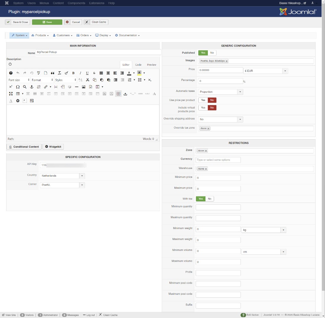

I don't get MyParcel Pickup working.
I have configure the shipping methode.
Filled-in my API (same as the other myparcel plugin)
But at the checkout the shipping methode is not visible.

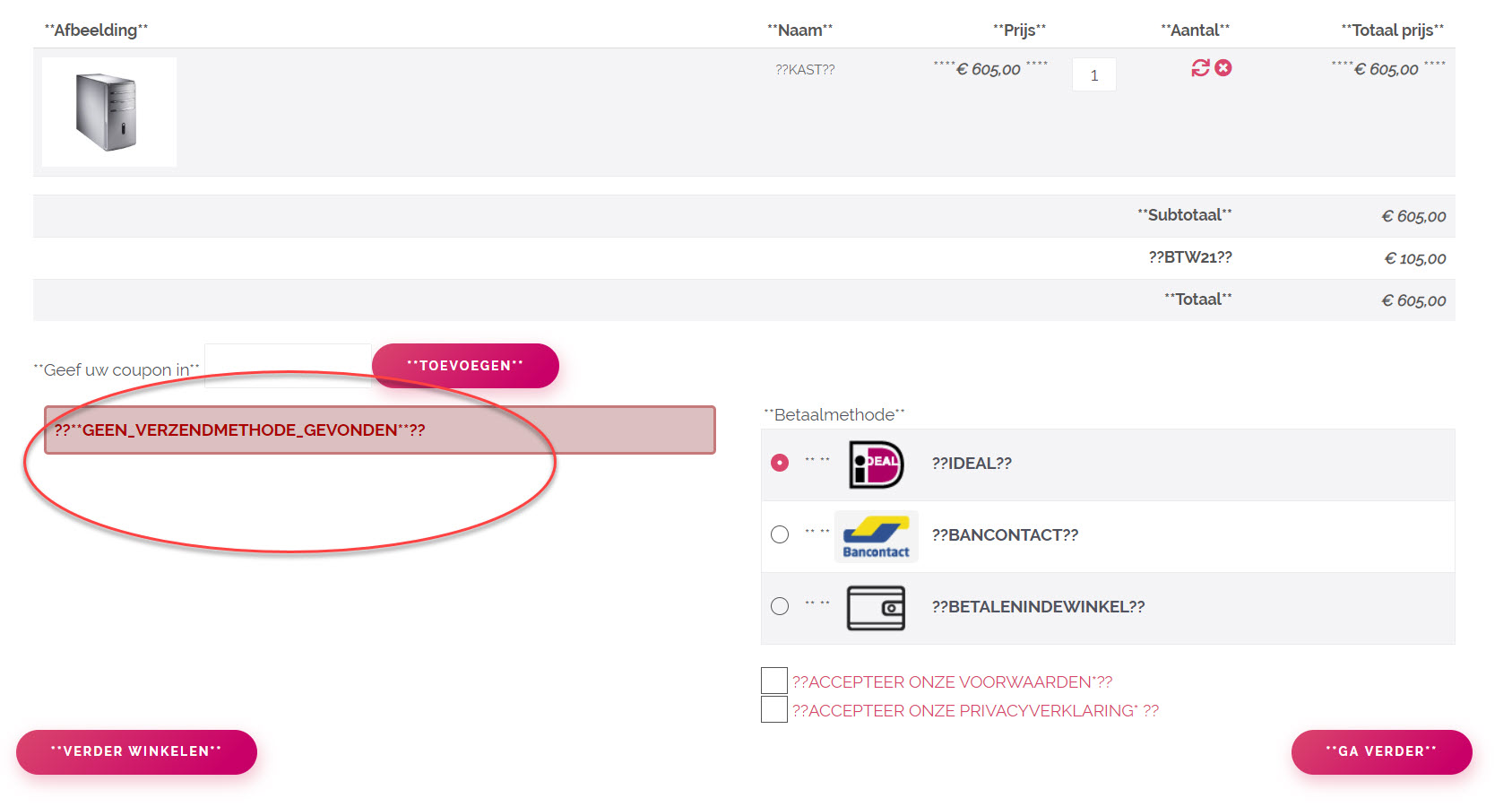

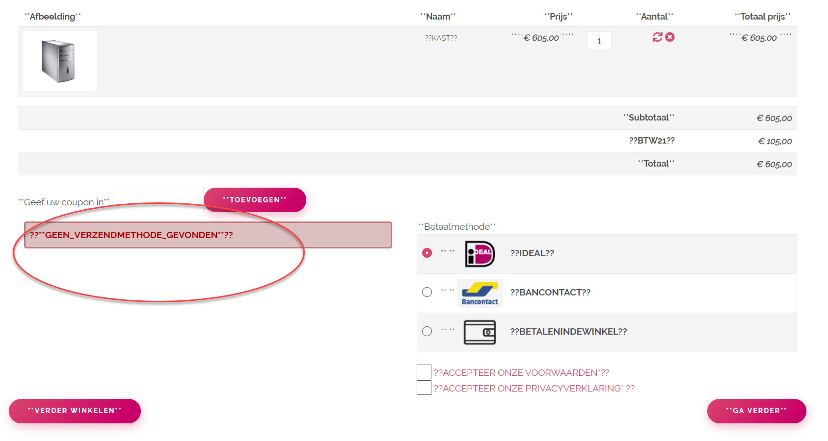

6 years 4 months ago #317683
Sorry, but when I deactivate all other shipping methodes I get the message:
NO SHIPPING METHOD FOUND
I have no restrictions in the shipping methode so the shipping methode should be visible.
See screenshot!
Hope you can help me.
Kind regards,
Lumiga
Kind regards,
Lumiga

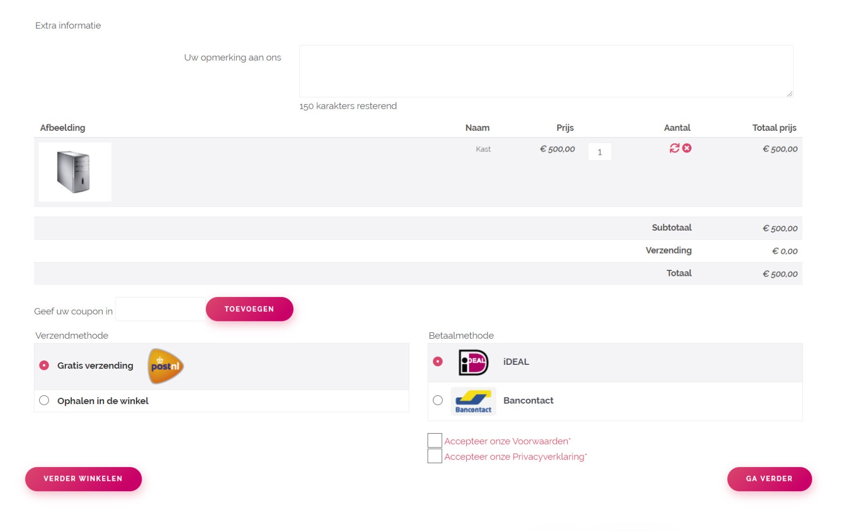

6 years 4 months ago #317704
I did a test and it works fine:
monosnap.com/file/1mUskam0gHpWs5Iwzvc7ITxxcxF7K5
I suppose that the issue comes from the address you're using for your test.
Make sure it's a valid address.
Also, I remember you said recently that you used the address_street2 field for the house number:
www.hikashop.com/forum/install-update/89...nd-track.html#317649
And you have modified the track and label MyParcel plugin to support that change.
But I suppose you didn't modify the MyParcel Pickup plugin for that.
You should edit the file plugins/hikashopshipping/myparcelpickup/myparcelpickup.php and change the line:
$street = SplitStreet::SplitStreet(@$order->shipping_address_full->shipping_address->address_street, $src_country, $dst_country);
to:
$street = SplitStreet::SplitStreet(@$order->shipping_address_full->shipping_address->address_street.' '.@$order->shipping_address_full->shipping_address->address_street2, $src_country, $dst_country);
I've also added a patch to the MyParcel pickup plugin to display an error message when no pickup location is found because of the address.
