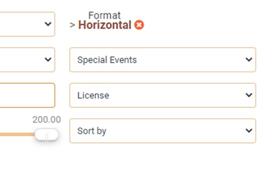

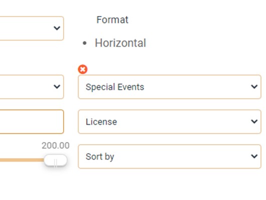

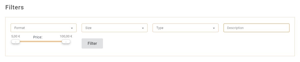

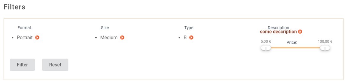

Hi, After Hikashop Business update from 4.2.3 to 4.3.0 I have noticed problem with formatting of deletable filters – proper formatting is lost. Please find enclosed image 1 with proper formatting in 4.2.3 and image 2 with unproper formatting in 4.3.0.

We indeed changed the HTML code for the deletable filters so that it is now easier to style.
The delete icon moving below the text and the point displaying instead of a caret depends on the CSS of your Joomla template.
You'll be able to change that back with some CSS code.

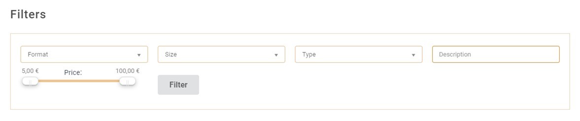

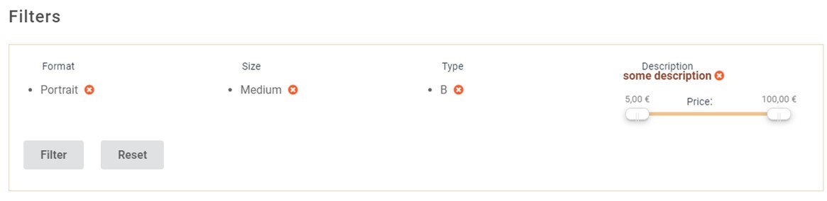

Hi Philip, Thank you for the information – this code solved only part of the problem. I noticed following problems:
a) for filter type single dropdown the line is still added between filter title and filter value and for me is important to have no line here as it was before Hikashop update (for filter type text is ok - you can see on image 2 no line between filter title and filter value)
b) for filter type single dropdown my css settings for filter value font are missing (for filter type text is ok – you can see on image 2 font formatting: brown color and bold weight)
Please find enclosed how the problem looks like on images – first image 1.jpg shows filters before they are set and second image 2.jpg shows filters after they are set.
Greg
6 years 2 months ago #321954
you just have to add this kind of code to correct this with :
.hikashop_filter_main.hikashop_filter_main_Format_1 ul.hiakshop_filter_selected_list {
    color: brown;
    font-weight: bold;
    margin-top: 3px;
But note that here, we correct css command from nucleus.css most for selected dropdown height.
And so, if you find other elements that needs correction, the best is to contact Template creator, like this the template will follow HikaShop necessary evolution.
