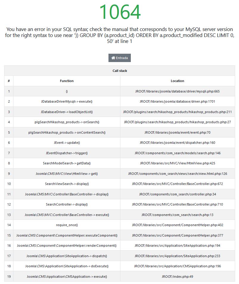

After update to Hikashop 4.4 i get the folowing error when anyone search a product in the module search (frontend):
Error 1064
You have an error in your SQL syntax; check the manual that corresponds to your MySQL server version for the right syntax to use near ')) GROUP BY (a.product_id) ORDER BY a.product_modified DESC LIMIT 0, 50' at line 1.
Any idea to solve this?

  • Posts: 45
5 years 10 months ago #324838
This is what I get when i do a search (see the attached image).
With Hikashop 4.3 works fine.
Best
Best regards

I see that there is an error with the MySQL query to search for products in the database.
But I'm still not sure why as it doesn't happen on my end (or anyone else so far).
Could you also please do this modification in order to know the exact MySQL query which creates the error ?
www.hikashop.com/support/forum/product-c...eld-list.html#304882
