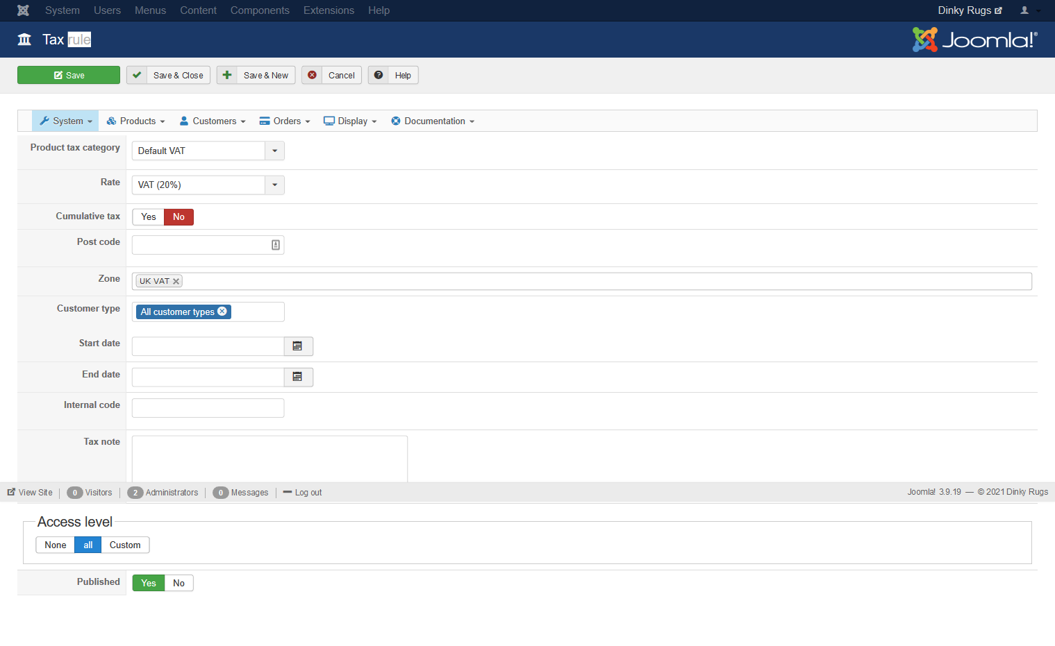

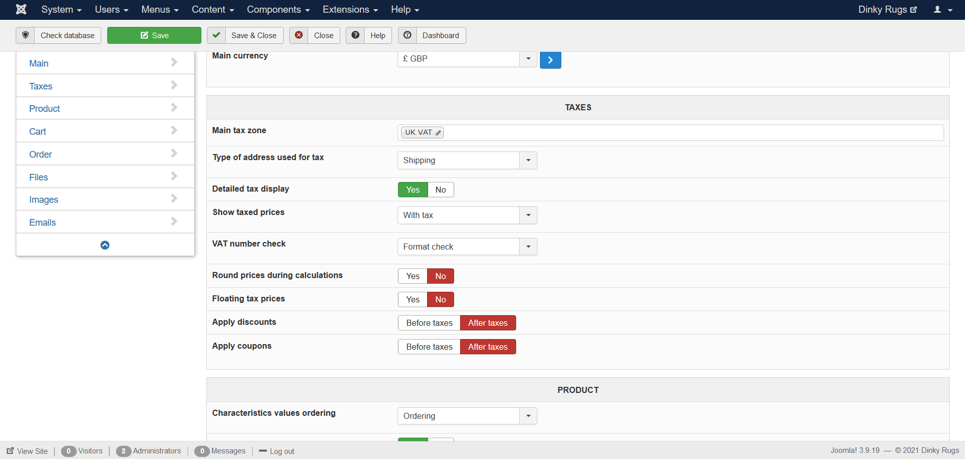

The goald is that the channel islands do not pay VAT even though they are a state in the UK. This has been covered a number of times and I have followed a numebr of different methods all without success.
I have checked:
www.hikashop.com/support/documentation/3...ion-listing.html#faq
www.hikashop.com/support/forum/taxes/882...for-some-states.html
www.hikashop.com/forum/taxes/887259-no-t...everything-else.html
Please see attached images for configuration.

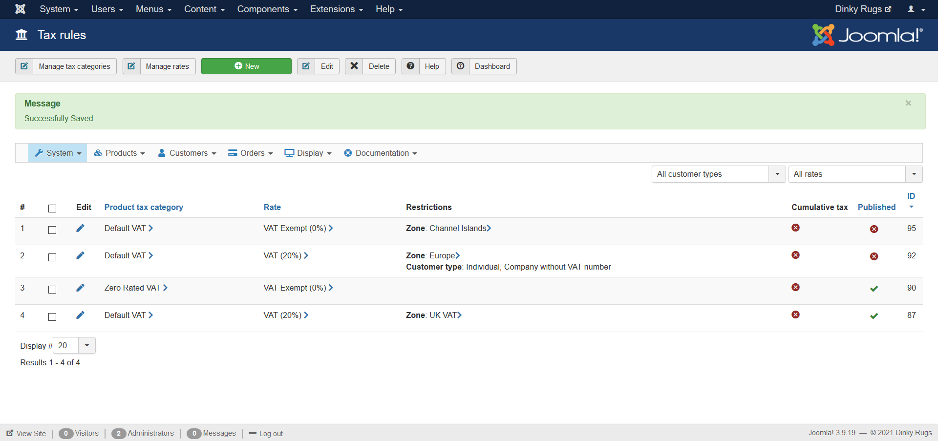

Take care, maybe you have switch it off on purpose but your Tax rules restricted by Channel Islands (ID=95) is unpublished, for process some test this must be published.

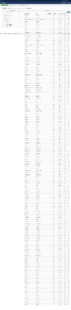

Plus, note that your last screenshot the resolution makes the image frankly unusable.

the unusable image is to show I don't have the zones / states unpublished - they are all in the UK VAT tax zone bar channel Island

From your first message, what I can propose is this:
- in the "main tax zone" setting, you're normally supposed to enter a country or a state. So maybe the "UK VAT" zone is not well liked by the code. Try to select there one of the states you've added as sub zone of your UK VAT zone, it might help
- it could be that the products listings are configured to display the prices without taxes. And thus, even if the tax is applied you don't see it there, and you see in on the checkout as there is it always displayed in the cart view. So check the taxed price display setting of your categories/products listing menu items / HikaShop products listing modules. It's that setting which controls the display of the prices with or without taxes overridding the setting in the HikaShop configuration.

In the "main tax zone" setting, you can and should only select one zone. The zone you want to be used for tax calculations when the current user doesn't have an address yet. So it should either be a zone linked to a tax rule (a state in UK) if you want the prices to be taxed on your products listings, or a zone not linked to a tax rule (another country zone) if you don't want the prices to be taxed on your products listings.
That means anyone signing up from the channel islands will not find their state?
The list of states you see on the registration form depends on the country selected by the customer, and before he selects one, or if you disabled the "address country" field, it's the "default" value of the address country field which is used to get that list, not the main tax zone.

I checked your website and I can see that you still have the "United Kingdom" country zone selected in your tax rule instead of the "UK VAT" tax zone:
monosnap.com/file/tRq2gXDh4pPDgHZqd4I3Ajz2wm0kQw
Because of that, both tax rules match for users with an address in the Channel Isles state.
So change the zone to the "United Kingdom" country zone in your tax rule with the id 87 and it should work like you want.

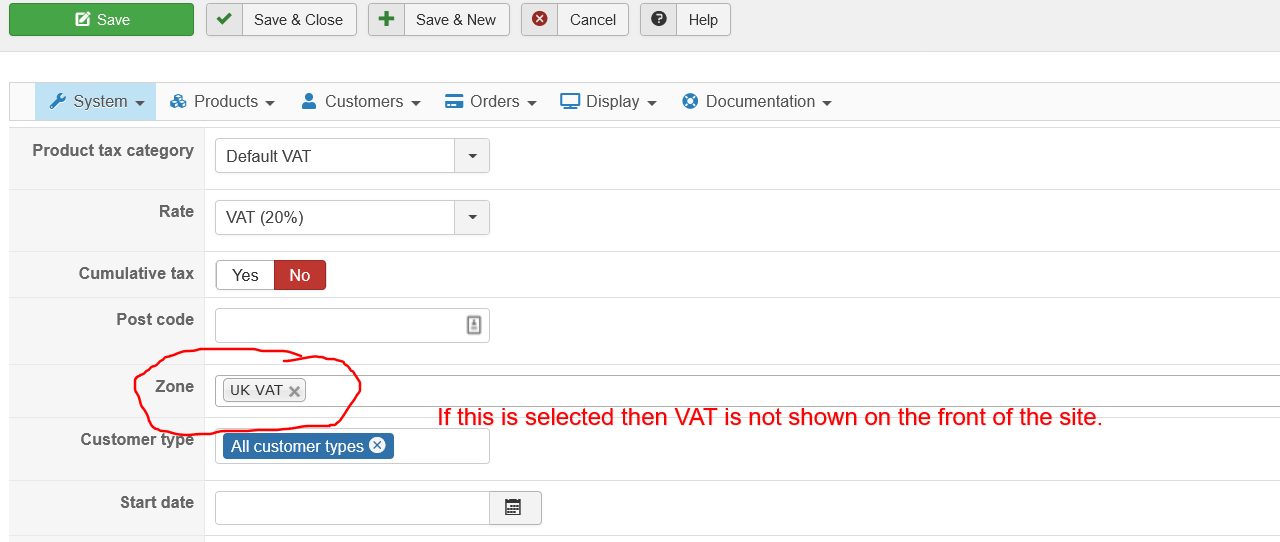

I'm not sure how to see ID 87 when selecting a country?
If I change it to UK VAT then all the prices on the front end are shown without VAT. This is when I'm not logged etc. I need prices to show VAT on the front end please.
Last edit: 5 years 7 months ago by grayt7.

That's normal. In your "main tax zone", you've selected the United Kingdom country zone.
So when you're not logged in, the system will look for tax rules for that zone.
So on top of changing the zone in your tax rule to "UK VAT" instead of United Kingdom, you also need to change the main tax zone setting to one of the state zones of the UK VAT zone.
That's what I explained in a previous message here:
it should ... be a zone linked to a tax rule (a state in UK) if you want the prices to be taxed on your products listings

5 years 7 months ago #329059
Yes that is exactly what I did, but it doesn't work. the VAT is removed from the front of the shop.
The main tax zone I set to the state: Suffolk. In the UK VAT zone Suffolk is in there.
But VAT is removed from the front end.

I checked your website and I can indeed see that it is indeed the case.
And that's because you have the geolocation plugin activated which overrides the main tax zone setting with the zone of the current country.
In that case, the solution we were talking about since the start of this thread is not possible.

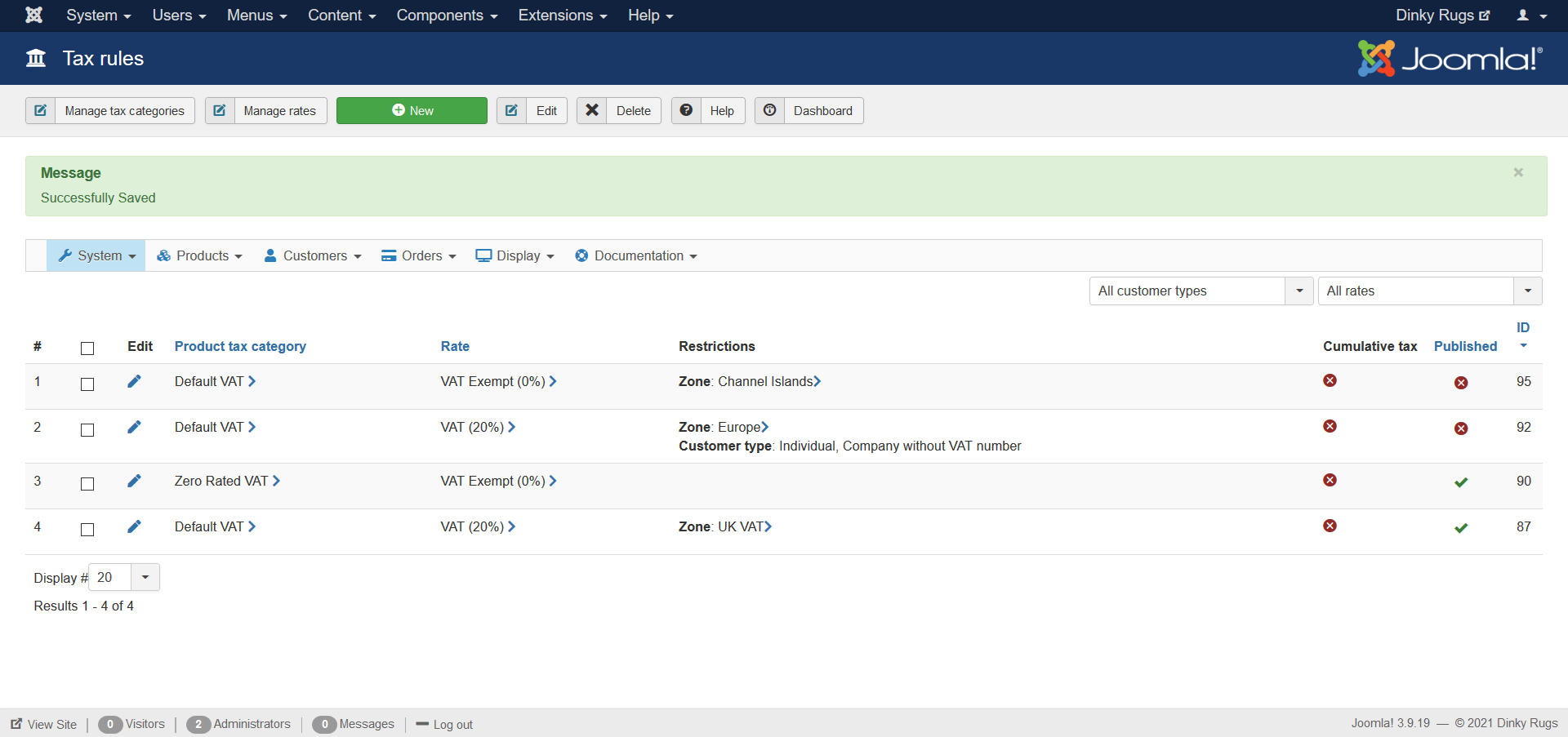

In that case, the last resort is to use the order of the tax rules so that for users with an address in the channel islands, both tax rules will be loaded but the one directly assigned to them will be loaded first. That way, it will be selected for them, and you can keep the other tax rule zone to the UK country zone so that it will be taken into account for users with an IP in the UK.

Thank you for checking. Also thank you for re-ordering the tax rules.
Now when I browse the site the tax is added to the products, which is great thank you.
However, when I login and have a shipping address to the Channel Isles the VAT is still added at checkout?
Many thanks
  • Posts: 86113
  • Thank you received: 14210
5 years 7 months ago #329111
The order had to be the other way around.
