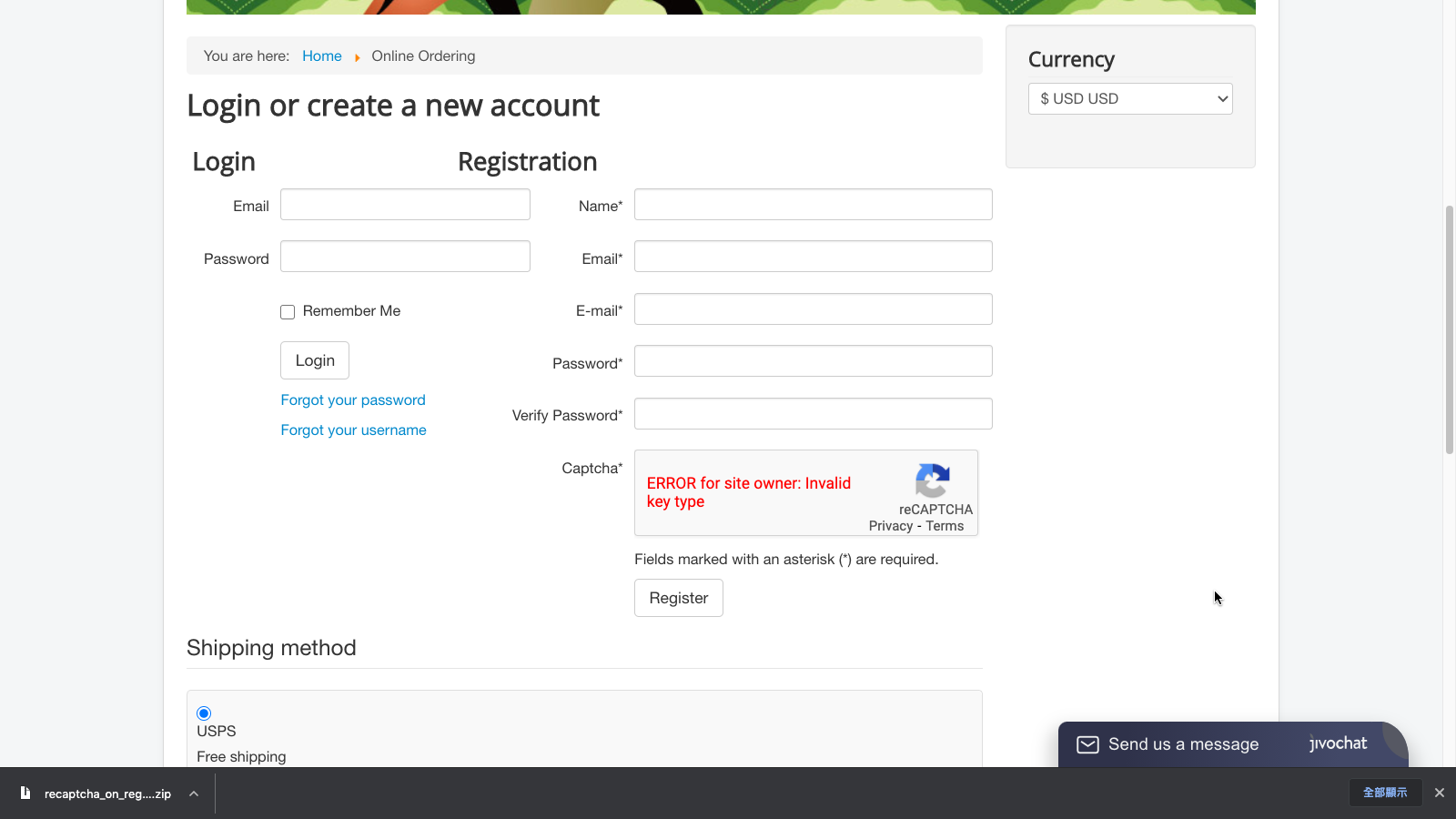

5 years 9 months ago - 5 years 9 months ago #329827
by clairewang
Replied by clairewang on topic Stop registration being hacked
Last edit: 5 years 9 months ago by clairewang.
Less
More
- Posts: 12953
- Thank you received: 1778
5 years 9 months ago #329907
by Mohamed Thelji
Replied by Mohamed Thelji on topic Stop registration being hacked
if you see the "Invalid key type" message, this means that you are using an incorrect reCaptcha key type. For example, V3 keys are not compatible with V2 reCaptcha, and V2 keys are not compatible with Invisible reCaptcha. Key types are not interchangeable.
So make sure you generate the correct key type.
Kind regards,
Mohamed.
Kind regards,
Mohamed.
