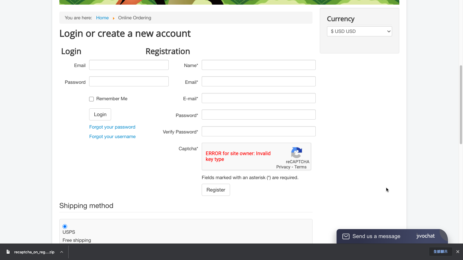

Thank you a lot, Nicholas. I used Hikashop free plug-in. But it shows ERROR for site owner: Invalid key type
Even I used the different no cookie browser. Could you help me? Thank you. See attachment.

if you see the "Invalid key type" message, this means that you are using an incorrect reCaptcha key type. For example, V3 keys are not compatible with V2 reCaptcha, and V2 keys are not compatible with Invisible reCaptcha. Key types are not interchangeable.
So make sure you generate the correct key type.
