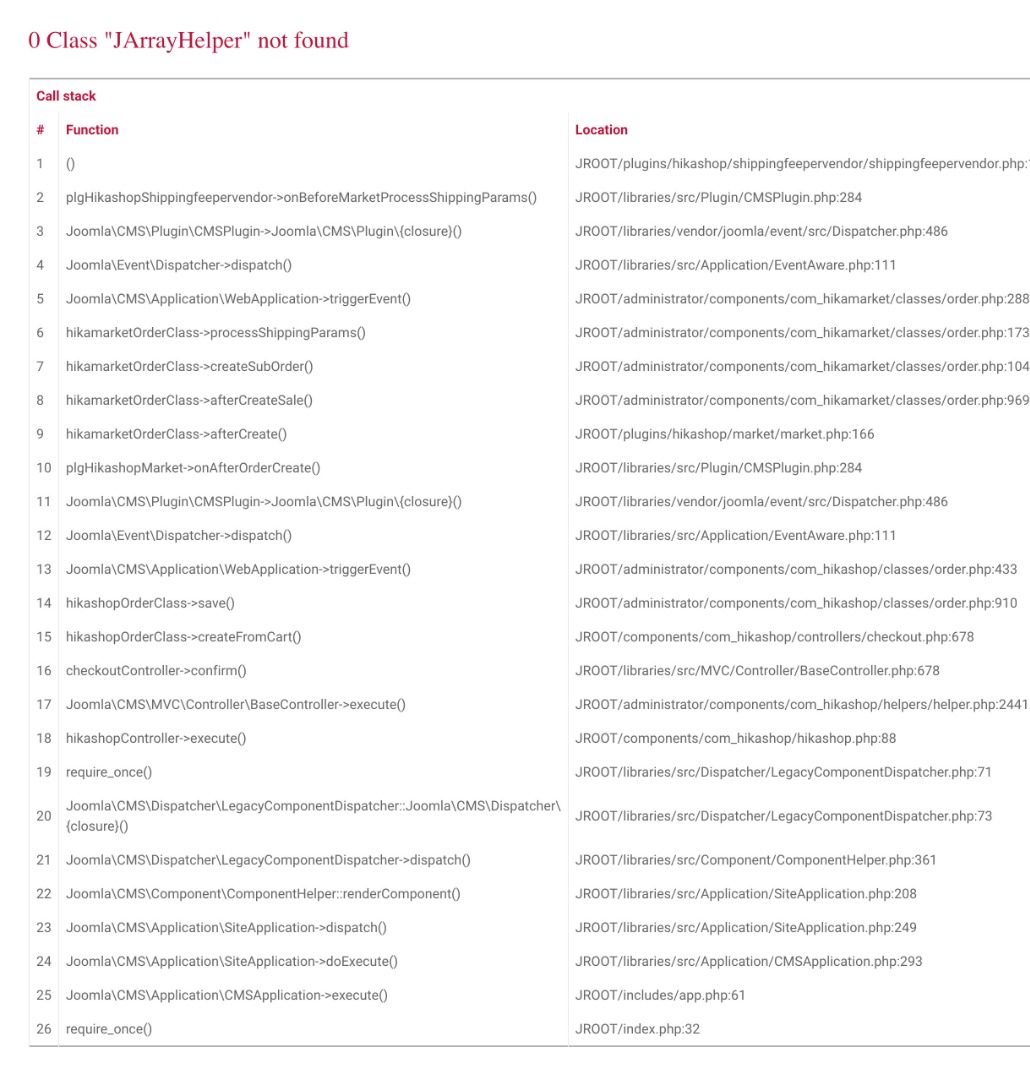

  • Posts: 23
2 years 10 months ago #354371
Here is the full info
  • Posts: 26365
  • Thank you received: 4069
2 years 10 months ago #354375
There is no more "JArrayHelper" in the plugin since October 2018 and the release of HikaMarket 3.0.0
All "JArrayHelper" have been replaced by internal functions from the HikaShop/HikaMarket cores.
www.hikashop.com/support/documentation/1...arket-changelog.html
But the plugin "Shipping Fee Per Vendor" is not part of HikaMarket since it's a custom plugin ; which has been updated in 2018 like the rest of the HikaMarket eco-system.
Please replace the
JArrayHelper::toInteger($shipping_ids);
By
hikamarket::toInteger($shipping_ids);
