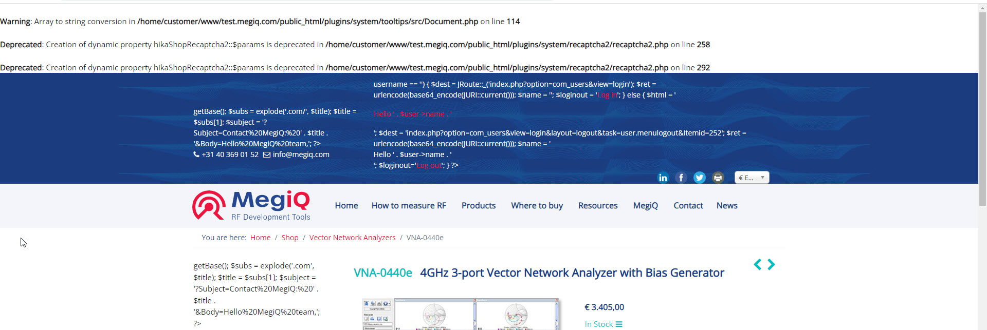

-- Error-message(debug-mod must be tuned on) -- : Deprecated: Creation of dynamic property hikaShopRecaptcha2::$params is deprecated in /home/customer/www/test.megiq.com/public_html/plugins/system/recaptcha2/recaptcha2.php on line 258
Even on error reporting set to default, Recaptcha gives error message.
How can I solve this?
2 years 11 months ago #355424
Can you active the Joomla debug mode and at the maximum level ?
Then reproduce your error message, and make a screenshot.
Provide us this screenshot and take good care to show every details in order to give us clues about your current issue.

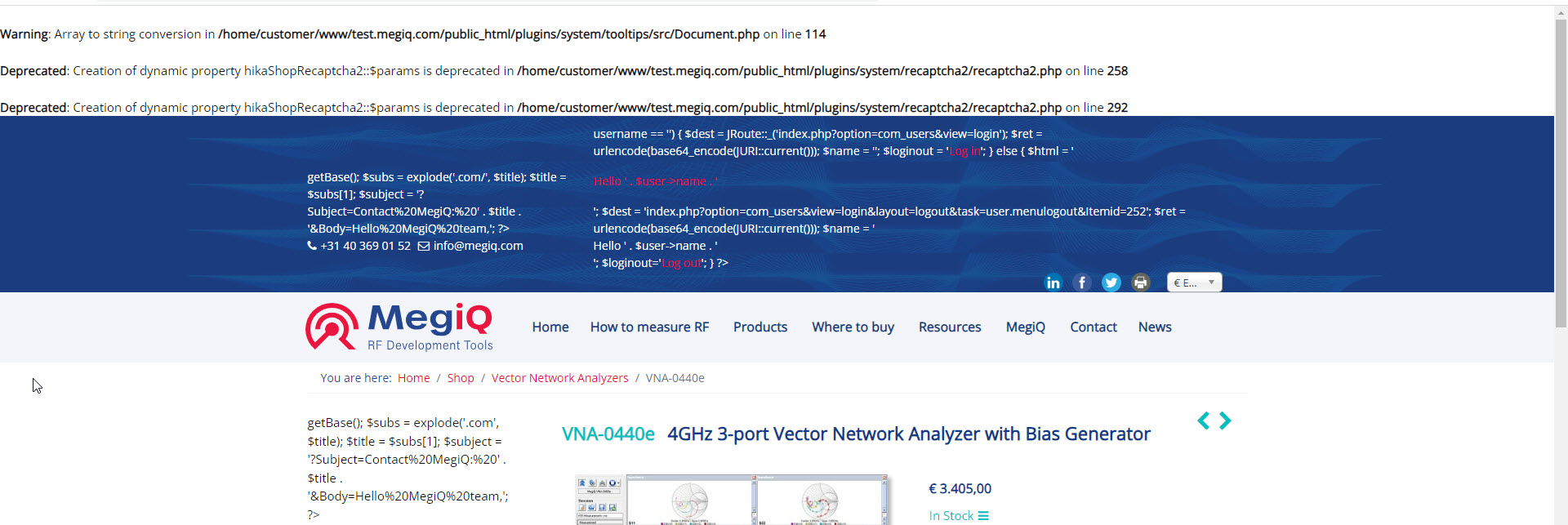

2 years 11 months ago #355429
This is it.

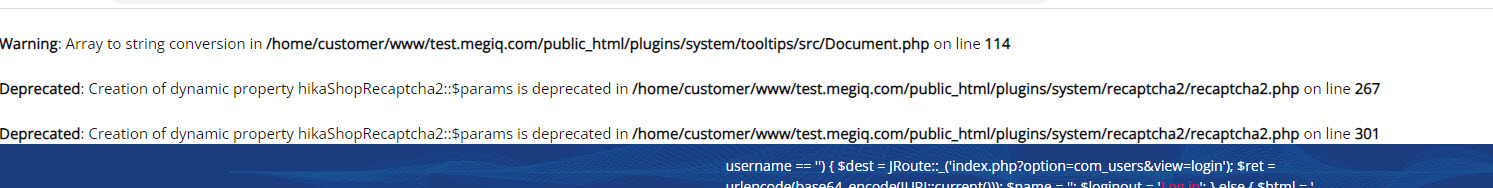

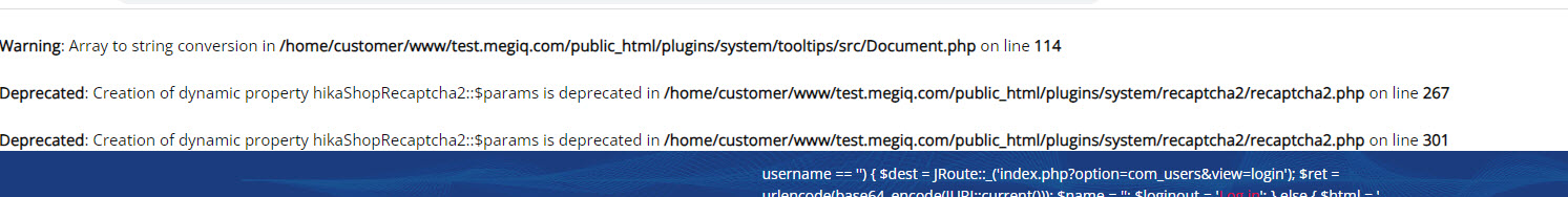

2 years 11 months ago #355500
I installed again the recaptcha plugin ( www.hikashop.com/support/documentation/7...captcha.html#install ) but I still get the same messages. See screenshot.
