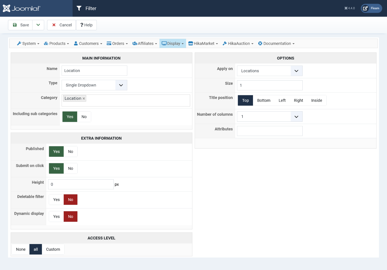

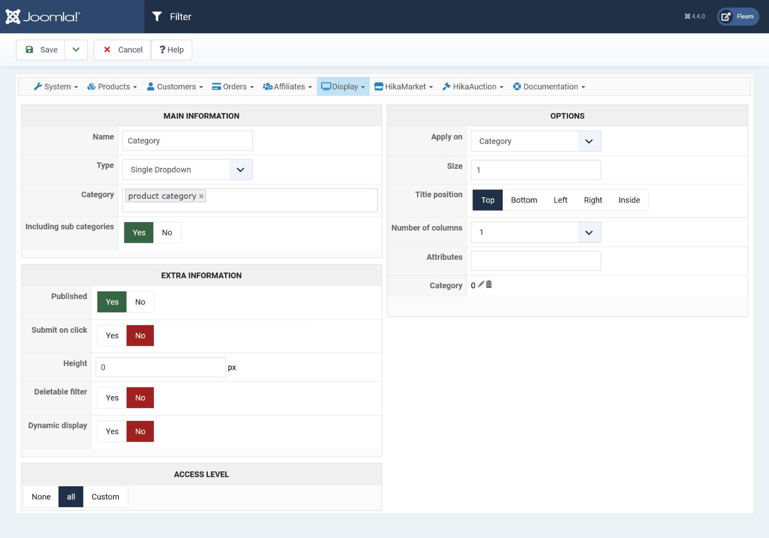

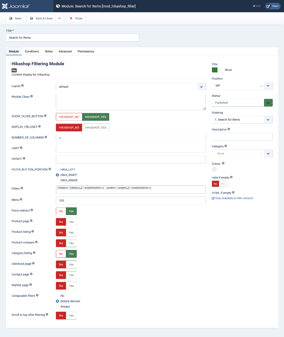

  • Posts: 324
  • Thank you received: 4
2 years 10 months ago #356100
Here are screenshots of the filter setup in the component and the module settings.
Thanks!
  • Posts: 86180
2 years 10 months ago #356102
The "category" setting below the "type" setting is for you to select where you want your filter to be displayed.
So with the brands filter, you've configured it to only appear when the current category is the main brand "location".
I would recommend leaving that setting empty.
