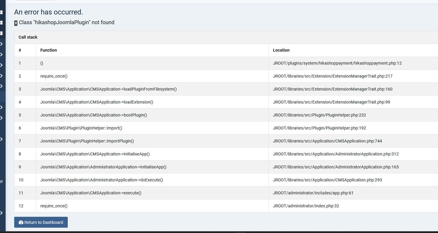

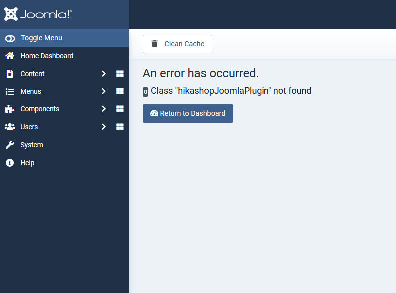

I have had PayPal IPN issues since Saturday? no changes for a while on the system. looked at upgrades an nothing was showing although I know there is an upgrade to Hika 5? I upgraded this manually and still got errors so down graded back to 4.7.5 and now cannot access anything on Joomla at all website is 404 error? cannot upgrade back to Hike 5?
  • Posts: 86180
2 years 10 months ago #356080
This error indicates that a plugin has been upgraded but that HikaShop hasn't been yet.
Because of this the plugin tries to use a class which doesn't exists.
Turn on the "debug" in the Joomla configuration in order to get the full error message. It will tell you which plugin is responsible for this. disable the plugin and you won't get the error anymore.
If you can't access your Joomla configuration page to enable the debug, you can manually edit the configuration.php file via FTP.
and if you can't access your Joomla plugins manager to disable the plugin responsible, you can rename its folder in the plugins folder of your website via FTP in order to deactivate it.

Hi, yes not access but now got "debug"
Had a few to disable but stuck on this one as I cannot find which payment one it is?
Rgds
  • Posts: 86180
2 years 10 months ago #356084
It's a system plugin. You can find it in plugins/system/hikashoppayment/ in your FTP

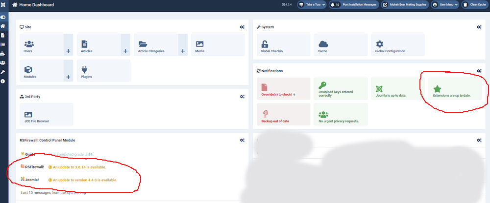

2 years 10 months ago #356085
Hi, I have now got it back working again (when de grading some of the php files had not gone back to 4.7.5 and were 5) sorted those and now back on 5.
However I still have a problem with no IPN's from PayPal and also updating, I'm guessing they are both connected?
See screen dump, Joomla is showing no updates available in one box but you can clearly see there are updates?
I get this message when trying to update Joomla
Update: Could not open update site #30 "Joomla! Update Component", URL: update.joomla.org/core/extensions/com_joomlaupdate.xml
Can you point me in the right direction please?
Rgds

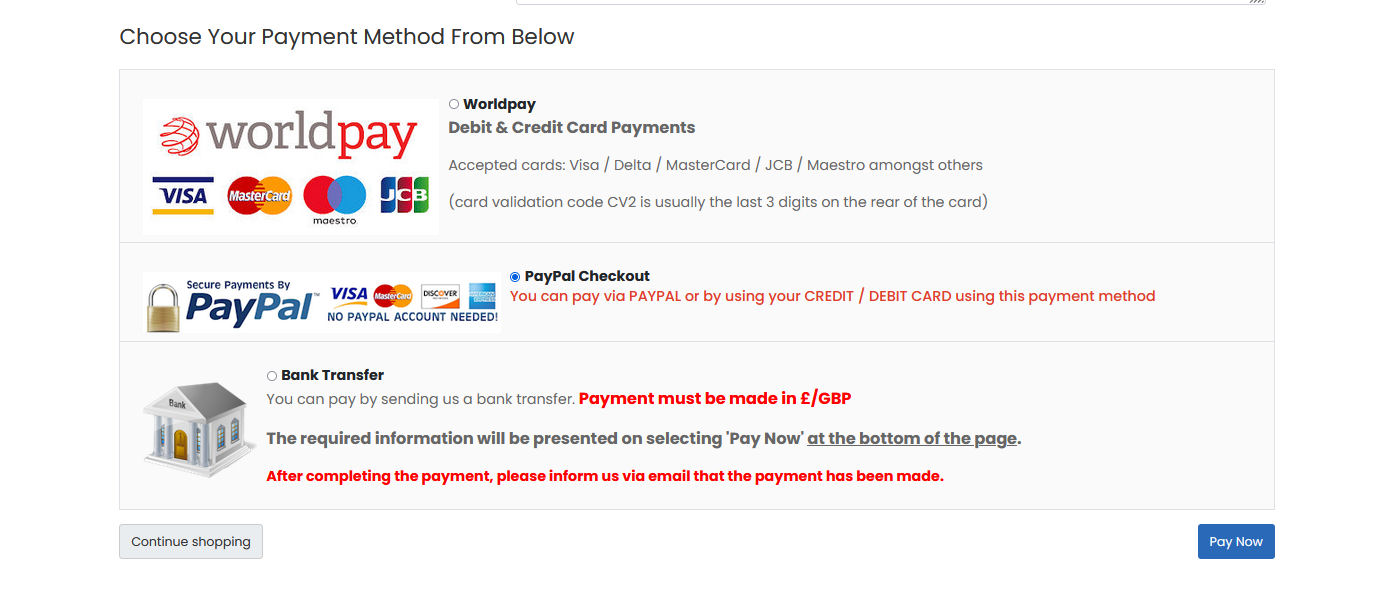

2 years 10 months ago #356091
Hi, Further info. Now that i'm on 5 PayPal no longer works? WorldPay works ok?
See attached screen dumps please
Rgds

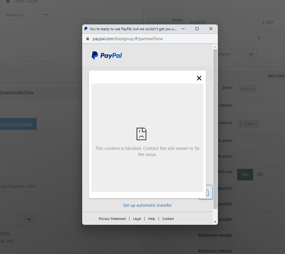

2 years 10 months ago #356131
Hi, I used the "connect to PayPal checkout" to set this up again, went through the procedure with PayPal and all seems ok at that end, should hikashop populate those field auto as your help says it does?
EDIT: just tried a different browser and get the below error message? this is with admintools and RSfirewall turned off just in case they were blocking? if appears something is stopping Hikashop talking to PayPal and updates etc.?
Rgds

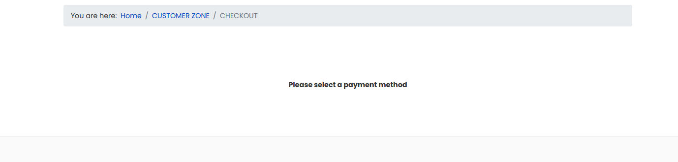

2 years 10 months ago #356143
Now getting this message? cannot update as PayPal and updates don't work on 8.1.24>

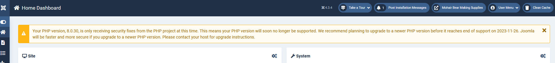

2 years 10 months ago #356182
Hi, Please read the 2 below the connection part. This was solved due to a PHP issue, screen shots included, will updated to Joomla 4.4 solve this?
Rgds
  • Posts: 86180
2 years 10 months ago #356183
Updating to Joomla 4.4 won't fix the warning with your PHP 8.0 version being too old.
The updates of Joomla not working on PHP 8.1 on your website is not something we can help with. You need to ask directly on forum.joomla.org as we don't know what could be the problem.
