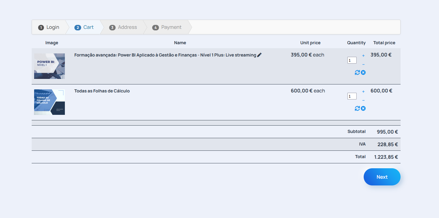

I created a coupoun, but the input box isn't shown anywhere on the cart:
Where is it??

The coupon input box is displayed by the "coupon" view in the "Checkout workflow" setting, under the Checkout tab of the HikaShop configuration.
If you don't see it, it means you previously deleted it from there and you need to use the "add view" green area in order to add it back.
You can read more about the checkout workflow configuration here:
www.hikashop.com/support/documentation/4...eckout-workflow.html
