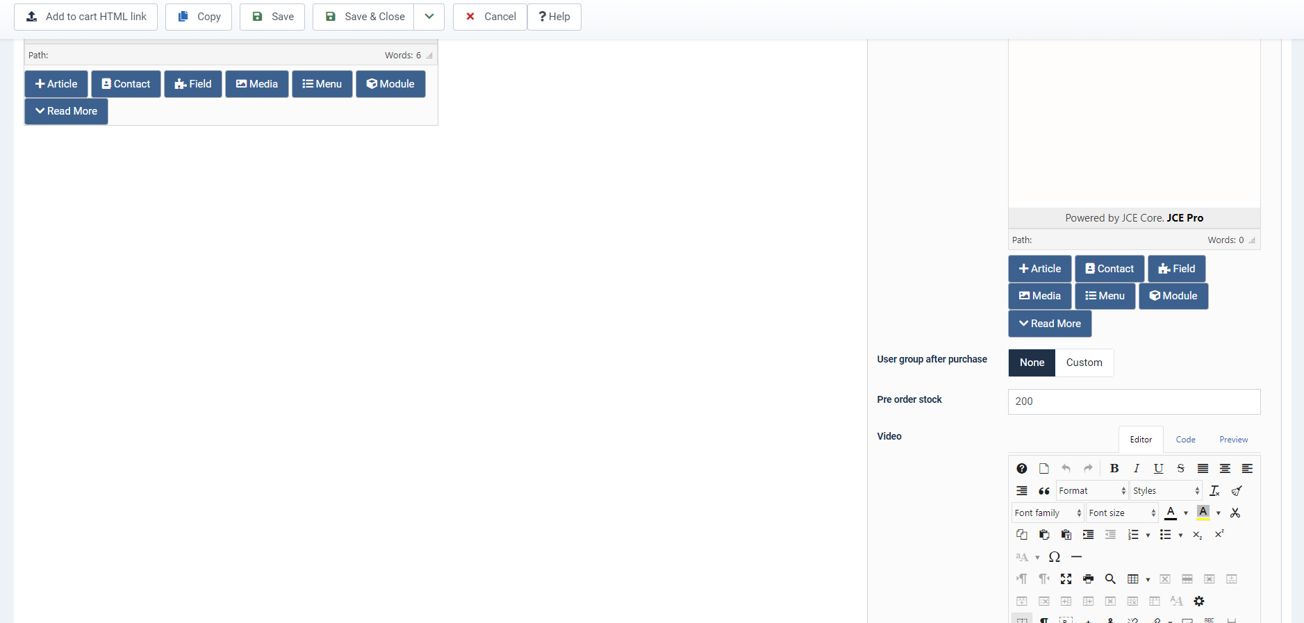

I set 50 in the main product preorder stock field and as you might know, there is no preorder field in variants, which is probably the issue.

The "preorder product" plugin has been developed to be compatible with HikaShop variants ; the field should also be displayed in the backend view "product/variants".

I have finally found the field which was hidden inbetween 2 custom fields Nicolas made for me, but without seems so truly hidden unless you know what to look for.
*Nicolas can you make the custom fields so that the preorder field is seperated from (/out of between) specifications and video field?

The field is not in the middle of the custom fields by default.
And the interface is customizable by drag&drop of the label of the fields:
www.hikashop.com/home/blog/481-hikashop-4-5-1.html#d&d
So I'm thinking you might have moved the fields yourself (or someone else on your end).
I would thus recommend rearranging the fields yourself with the drag & drop interface.
