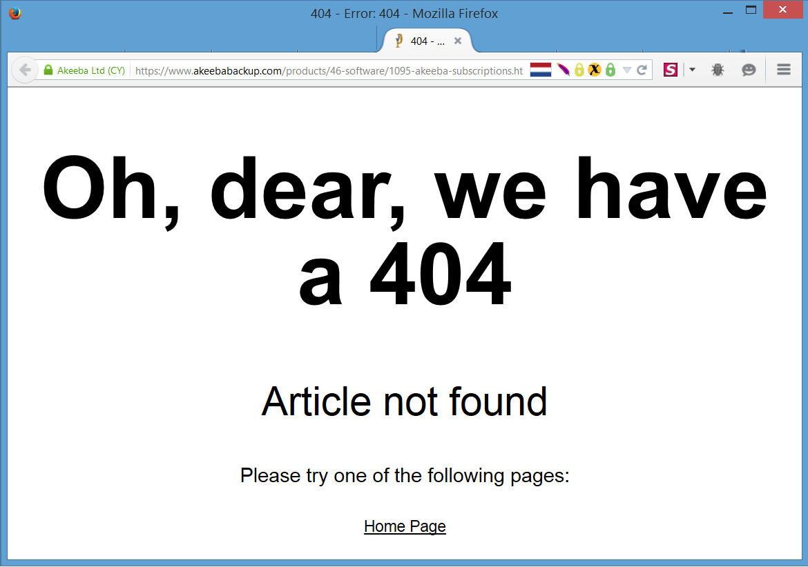

  • Posts: 846
  • Thank you received: 92
11 years 5 months ago #197784
in the www.hikashop.com/support/documentation/1...a-subscriptions.html
if you click on the link of name "Akeeba Subscriptions" in the line
You must have HikaShop and Akeeba Subscriptions installed.
The link is return this page content
Oh, dear, we have a 404
Article not found
Please try one of the following pages:
Home Page
Could you update the documentation : link to old download or confirm Akkeba could not be use now and give some link to other thirs product that could be use instead . I see in JED that there is now many many extension for HKS !!!
Regard's
Attachment not found
  • Posts: 86112
  • Thank you received: 14210
11 years 5 months ago #197812
Thanks for your feedback. I've updated the link.
