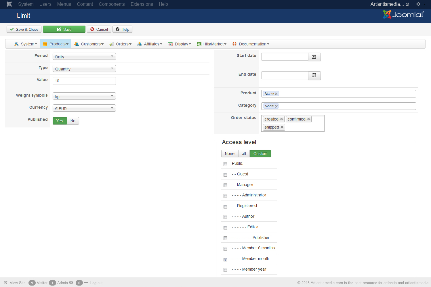

The limit feature sounds interesting. I didn't know of the existance. Since when is this available in Hikashop?
I tried to create a limit. Screenshot attached. A one month member may purchase/download 10 products per day.
With a monthly member testaccount I tried to create an order that contained more then 10 products. The order was created without a problem. All products could be purchased. So it seems the limits are not working. Or am I doing something wrong?
If we can get this working I would like to add something to the limits. My members may purchase the goods that still carry a price unlimited. I want to set the limit only for free products. So a filter for 0.00 Euro products would be needed in my case.
Sjaak
10 years 10 months ago #207476
I just done a local test and the limits seems to be working as expected.
Are you sure that the account used for the tests was in the group "Member months" ?
Regarding the filter, the easiest way will be to create a new category named for example "free products" and add this category to the desired products and finally add the category in the settings of the limit.

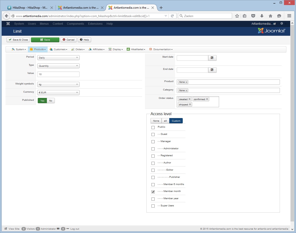

  • Posts: 261
  • Thank you received: 5
10 years 7 months ago #216552
limits do not work. I still have members ordering many more free products per day then they are entitlled to.
Can this be solved?
Attached a screenshot of settings. Do I have my settings right?
Sjaak
Last edit: 10 years 7 months ago by Sjaak. Reason: additional qustion. Screenshot attached.
  • Posts: 85615
  • Thank you received: 14036
10 years 7 months ago #216579
The settings look right and we don't have the problem you're describing since adding the patch above.
So we would need a backend and FTP access to your website, along with precise instructions to easily reproduce the problem on your website in order to debug the problem on your website.
