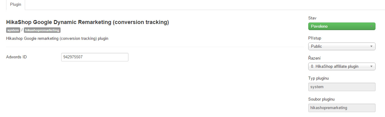

-- url of the page with the problem -- : www.elody.cz
Hi.
Hikashop conversion tracking (remarketing) does not generate any output.
I think I have setuped it well.
Any idea, please?
Filip
