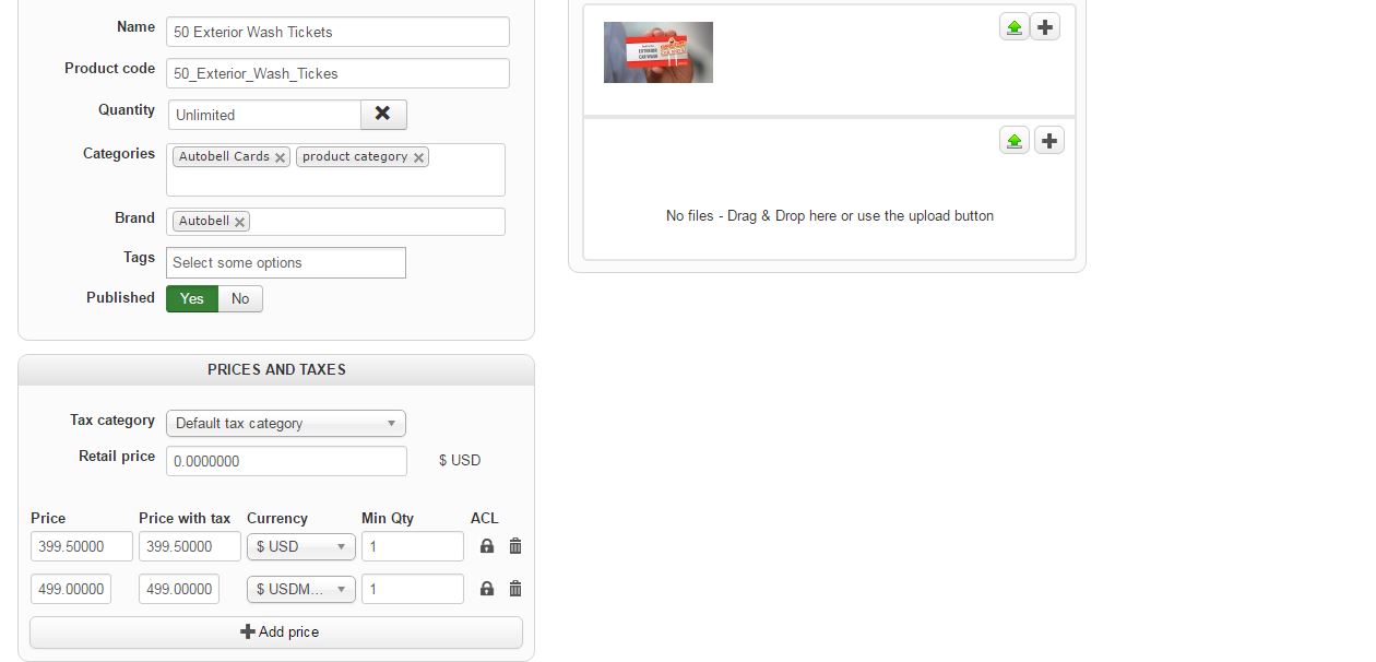

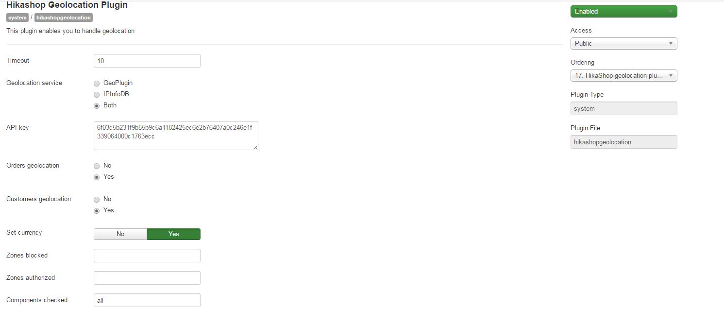

I have tired everything I can think of and read through everything in the forums and i cannot get the hikashop geolocation plugin to automatically switch prices. I have enabled the plugin and created an api key. Set currency is enabled to yes in the plugin as well.

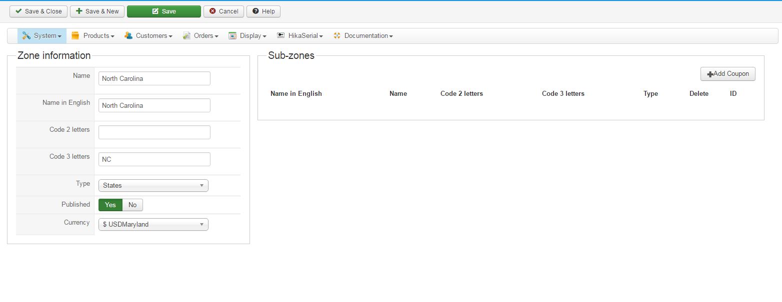

What I need to do is all states have the same pricing except 1 for this product. So I created a new currency and set the new zone to that currency. I set all the other states/zones to USD which is the default currency. However, I have tried looking through proxies, etc. and the currency never changes. I have no idea what I am doing wrong. I think there might be a bug in the geolocation plugin because the currency just will not change.
I did it on this product below and I have the north carolina zone since i live in nc to test this set to the new currency with a new price and the new price/currency does not show up. The rest of the states/zones are set to the default USD currency. However, the prices just stay set to normal USD price no matter what i change. The pricing should be showing as $499 when you coming from a NC location and it does not.

I forgot to attach my settings. Here are my settings for everything.
