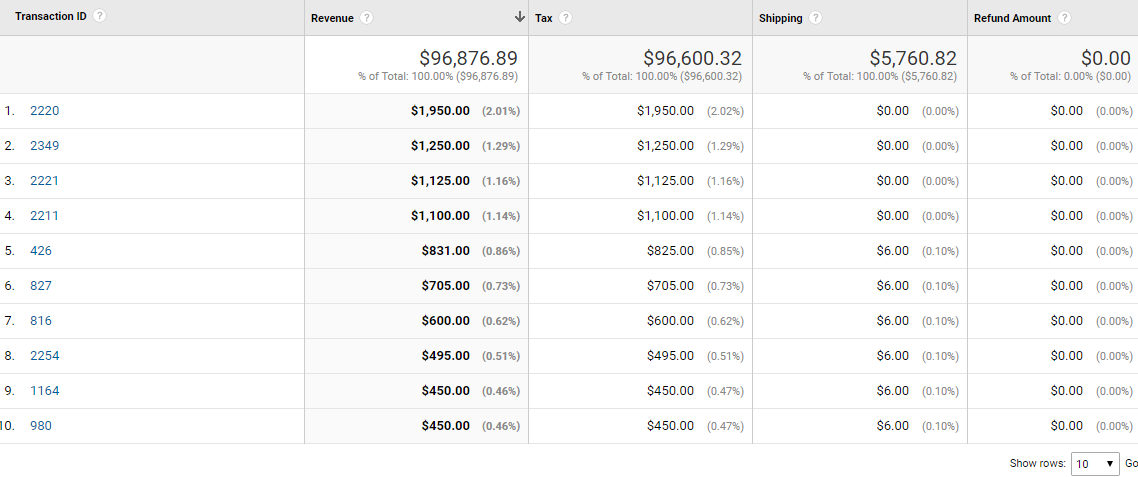

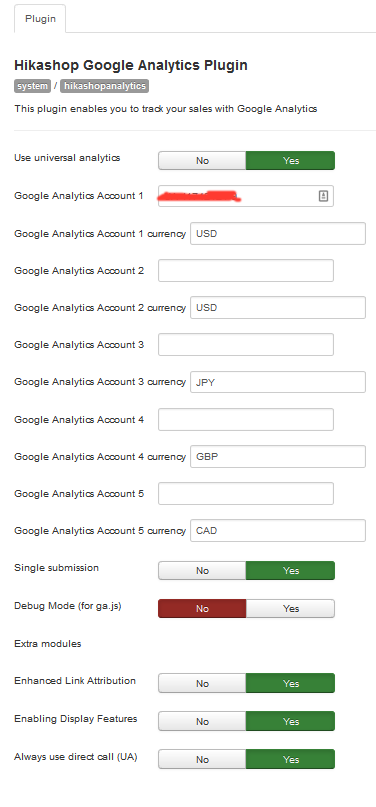

Hi, I am having a very weird issue. I attached a screenshot of both my plugin settings as well as the report sales for analytics. There is something very off in the analytics plugin in hikashop. It is reporting equal values for both the revenue and tax column in analytics. However, I don't even have tax on any product in the entire cart currently so, I have no idea how this could be happening?
The total sales that should be showing up currently should be approx. twice what it is right now and tax should be 0.
Can you please help me, this is a major issue?

We've actually added several fixes to the Google Analytics plugin in HikaShop 2.6.4 in order to fix the calculated amounts sent to GA which could be incorrect in some cases.
So you must be in one of these cases.
I would recommend to update to the latest version of HikaShop and the new data which will be sent to GA should be correct. Regarding the data already sent to GA, I'm afraid there is nothing that can be done.

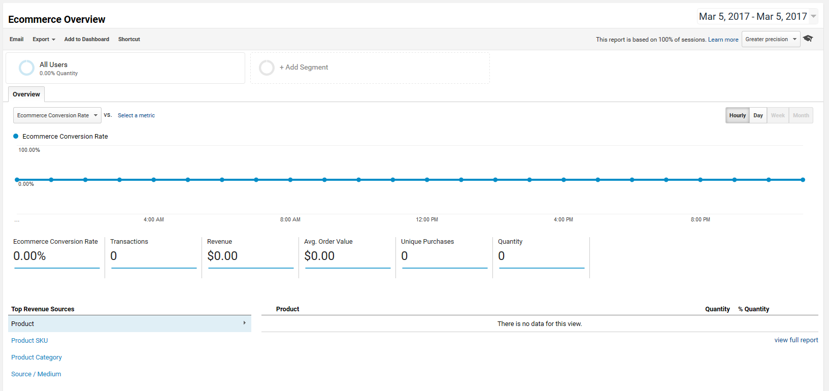

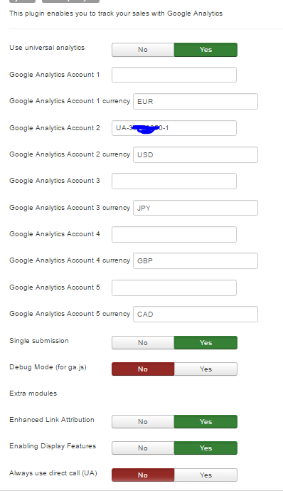

Hello - We updated the site with the latest version of the google ecommerce analytics plugin, and the stats are not quite right yet.
We looked at only new orders placed a day after the code was updated, to make sure we were testing against the newest code.
I'm attaching a copy of our configuration settings. We are using direct call, single submission.
1) When comparing the numbers in Google vs. the HikaShop orders, most transactions are showing up DOUBLED in Google for number of transactions, revenue and product sales. This is happening on almost every new order.
2) When a confirmed order is CANCELLED, it is added to the Google Analytics stats again instead of reversed. Cancelling an order ads the revenue again, increases the transaction count and increases the sales revenue for the products on the order. It should be reversing those stats, not increasing them, when an order is marked as Refunded or Cancelled.

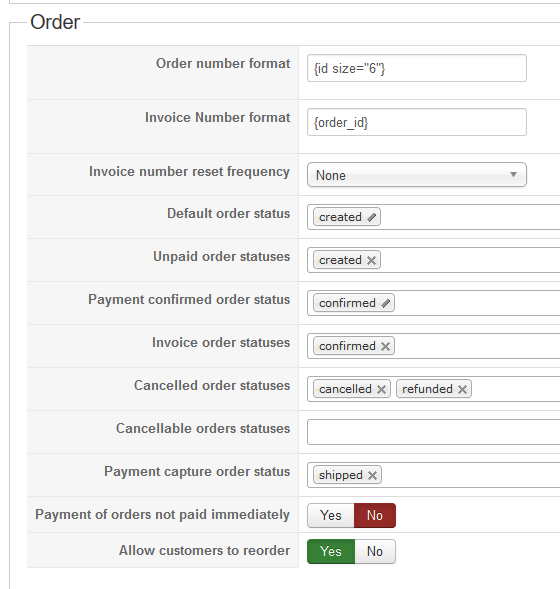

The "single submission" algorithm is based on the HikaShop invoice order statuses setting.
if($this->params->get('single_submission', 0) && in_array($confirmed_status, $invoice_statuses) && !empty($order->old) && !empty($order->old->order_invoice_id))
	return true;
So you have to check that you right have statuses for the "invoice" and that the status "confirmed" is right in that list.
Thus, the first time the order will be confirmed (so the order do not have an "order_invoice_id") the submission will be made.
I don't see any code which allow the plugin to record a cancelled order, nor code to handle that specific order status to send a negative value.
And due to the "single submission" setting, I don't even know how it could be possible to not submit several time a cancelled order... (but I first don't understand how a cancel order can be submitted)
So I think we would need more details about your order statuses configuration.

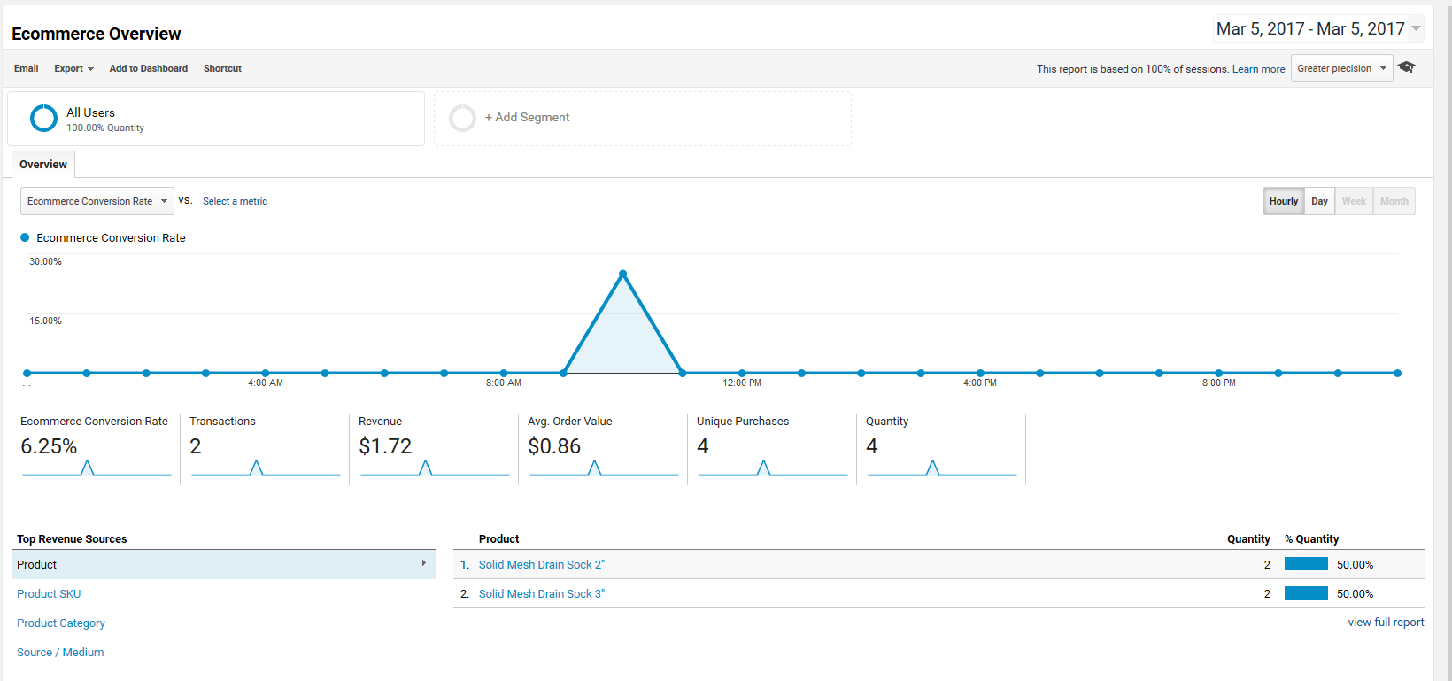

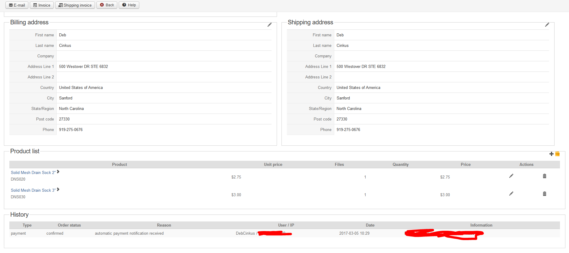

  • Posts: 329
  • Thank you received: 94

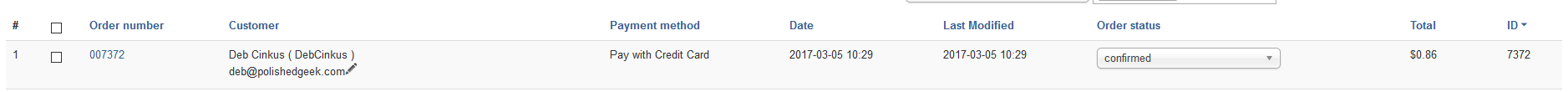

9 years 6 months ago #264172
Hi, Jerome -
Thanks for the reply over the weekend. I've retested and think that I've narrowed down that the cancellation didn't trigger additional analytics, I cancelled it almost immediately after doing the test and the duplication was not immediate, leading me to believe that the cancellation caused it.
Attached are some screenshots, including the order status settings.
Double entries are definitely happening in the analytics. Everything is being recorded exactly twice as much as it should be.
Google Analytics for today, before my test order
My test order information
Google Analytics doubled
~ Deb Cinkus, CEO
Polished Geek: more with monday․com
eCommerce Business Process Automation Experts
Last edit: 9 years 6 months ago by PolishedGeek. Reason: added titles to images for clarity
