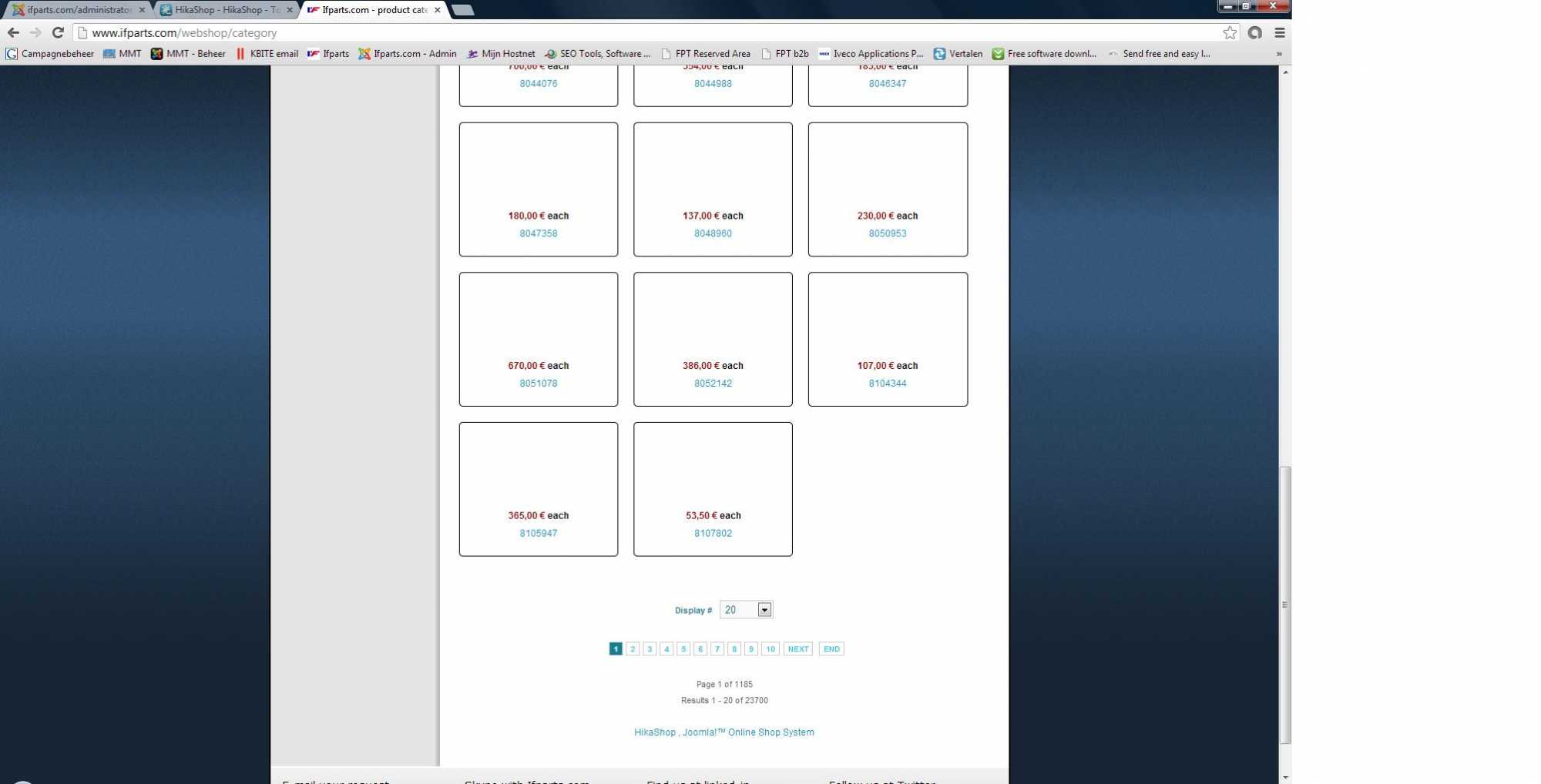

1 st problem see print screen: categories are deleted, but the articles still excist.
2nd: Mass action is not starting any more.
Last edit: 13 years 2 months ago by info@ifparts.com.
13 years 2 months ago #120625 by Eliot
Hi there,
1 - If you're deleting the categories that's normal, you should have deleted the product first and then the category itself. Mass actions are made to process specific data (categories for example) without impacting other data (product).
