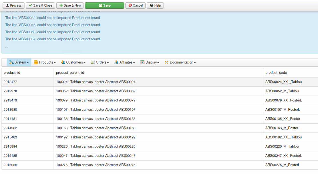

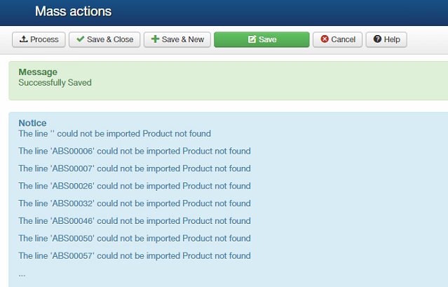

11 years 10 months ago #177607 by lex131
Replied by lex131 on topic Mass delete products
Indeed, now the speed is not an issue - everything works fast.

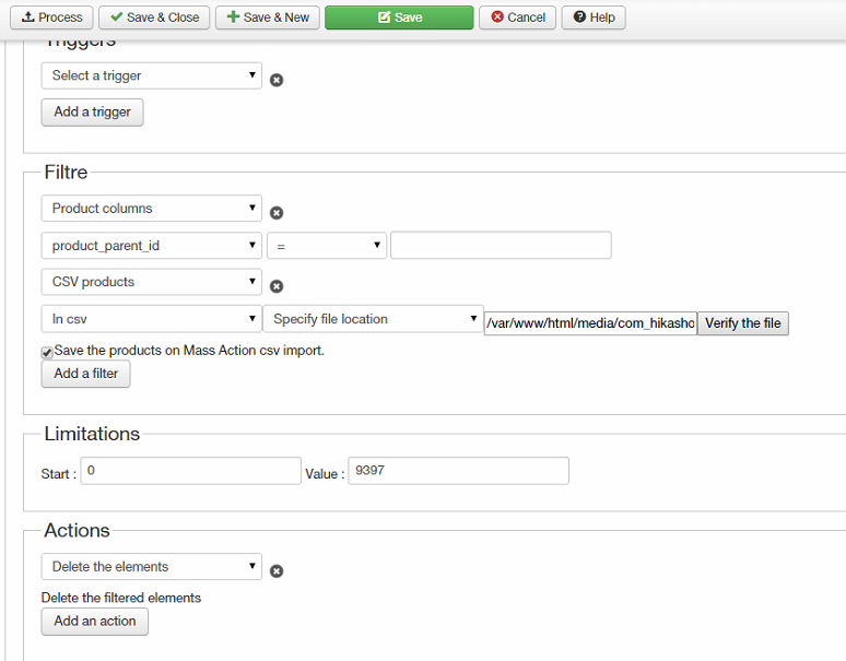

I created a new mass action and you can see the settings - printscreen.

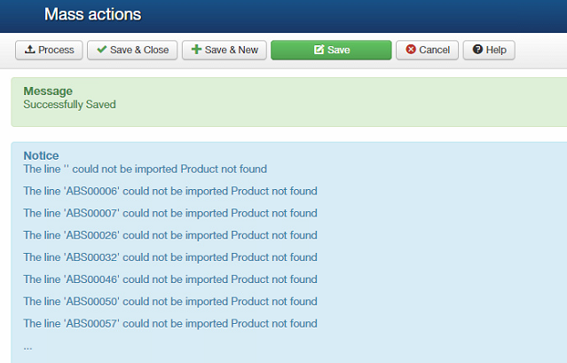

Also you can see the result in the error.png attachement.

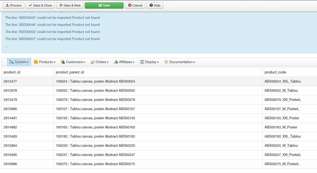

I changed the mass action filter to not delete but to show the results. It gives the same error but it also gives me a table below. I attached for this display-products.png

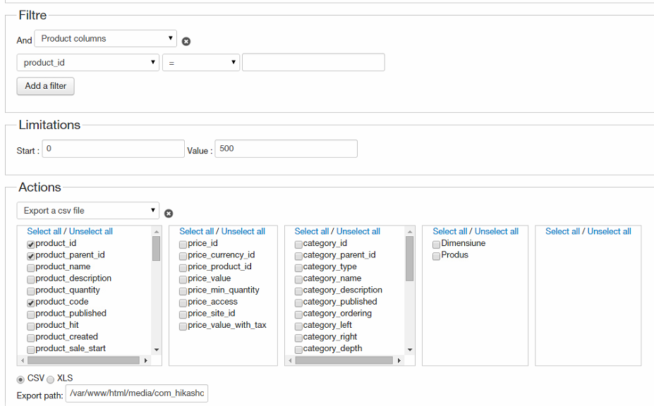

in this image you can see how the app shows the product_parent_id - as a long string, not just the codes in blue above (which are in my csv).
I created another mass-action, to check the correct product_parent_id. You can see the filter attached: export-products.png
This created the csv attached: export.csv
In this export you will see that product_parent_id is the same as in my filter csv - the format ABS00024 for example. Not as it appears in display-products.png
Please help me sort this out - it is really getting on my nerves, it should be something easy to do and I just can't get passed it. I left the actions there, the one set up to delete the products is named ID-to-delete.

11 years 10 months ago #177736 by Xavier
Replied by Xavier on topic Mass delete products
Please uncheck the option "Save the products on Mass Action CSV import".
This option allow to add the products in your shop, but in your case the products are already in, and needs to be deleted.
Having the full name in display-products.png is normal, to be more understandable we display the product full name, but we check only it's code.
If unchecking the option is not enough, please tell me and on Monday I will go back on your extplorer in order to debug that.

11 years 10 months ago #177737 by lex131
There's no difference upon checking or unchecking that option. The error is the same.
