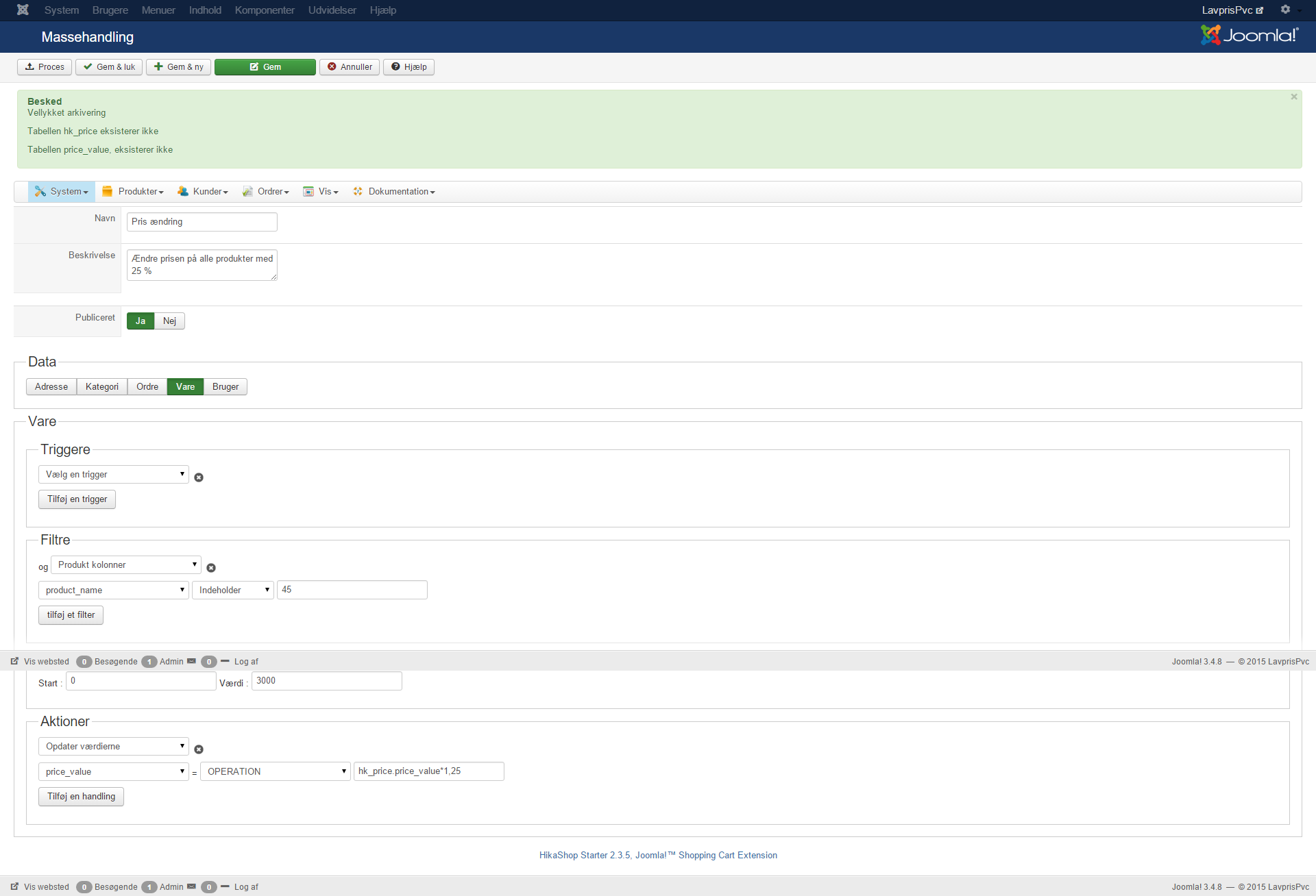

10 years 8 months ago #225285
We had an issue with the current version of HikaShop for the decimals and regarding the column names.
This will be fixed in the next release but for now please use the code:
hk_price.price_value*1.25

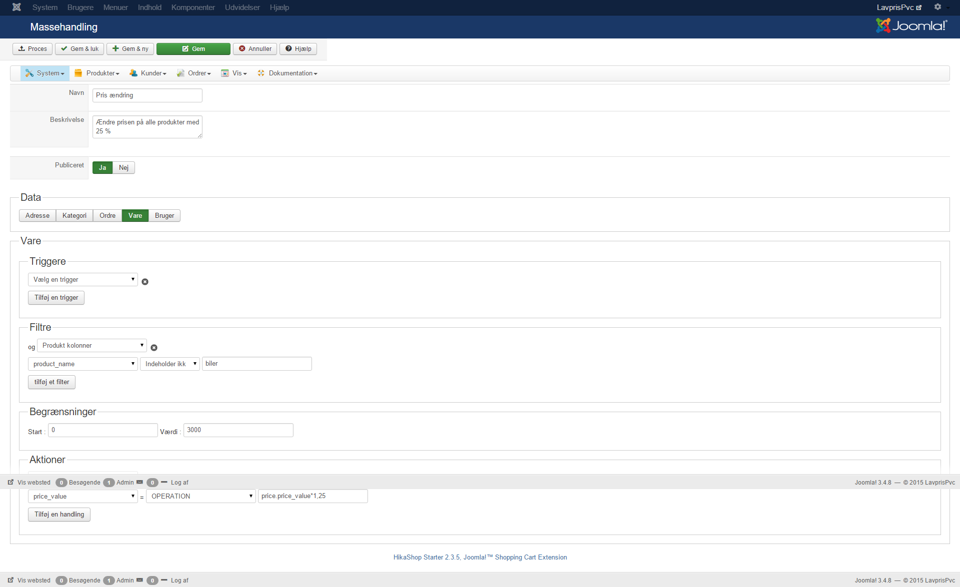

  • Posts: 3
10 years 8 months ago #225381
Then I got this:
10 years 8 months ago #225391
Please edit the file "administrator/components/com_hikashop/classes/massaction.php" and replace the function "updateValueSecure()" by:
