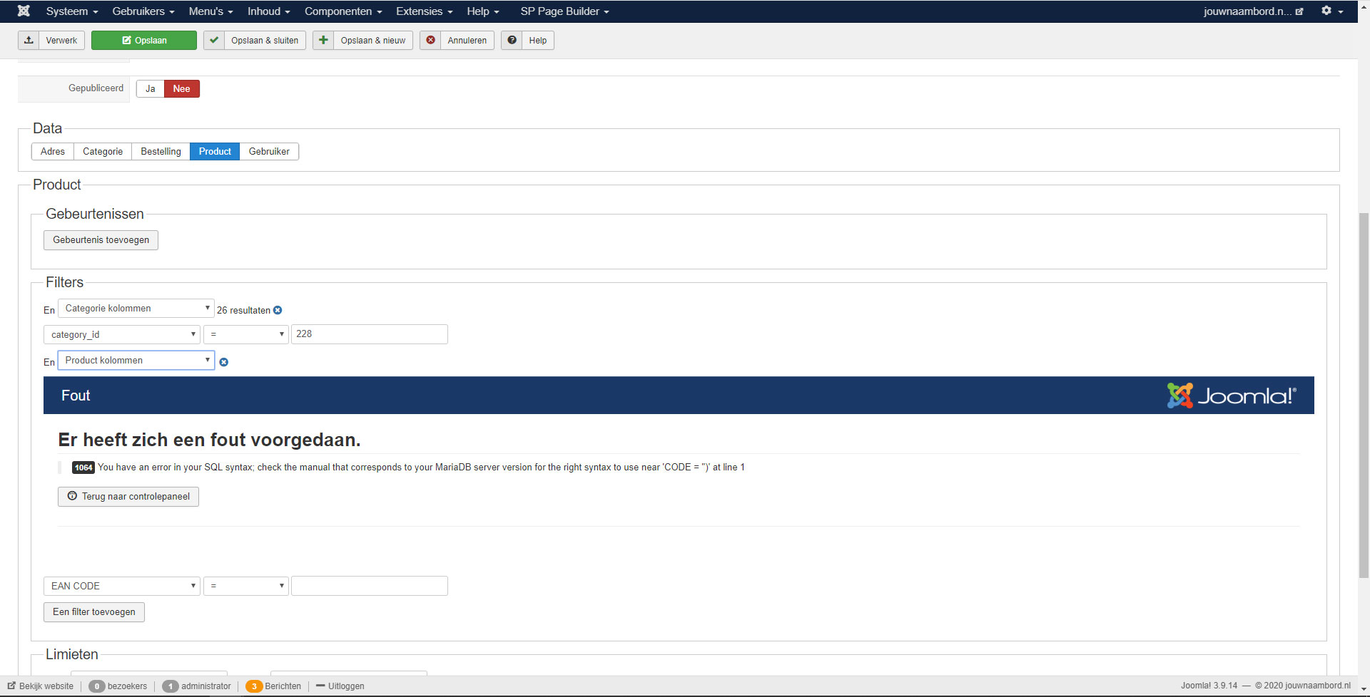

I'm trying to create a mass action to add a priceupdate for several products. After assigning a category I want to filter on a part of the product_name, but when choosing the product_column in the dropdownmenu of the filters I get this errormessage:

Could you please do that screenshot again after:
- activating the "error reporting" and "debug mode" settings of the Joomla configuration in order to get more information on the error location
- applying this change in the code of Joomla in order to get the full MySQL query generating that error:
www.hikashop.com/support/forum/product-c...eld-list.html#304882
That will help us understanding the situation and providing a solution.

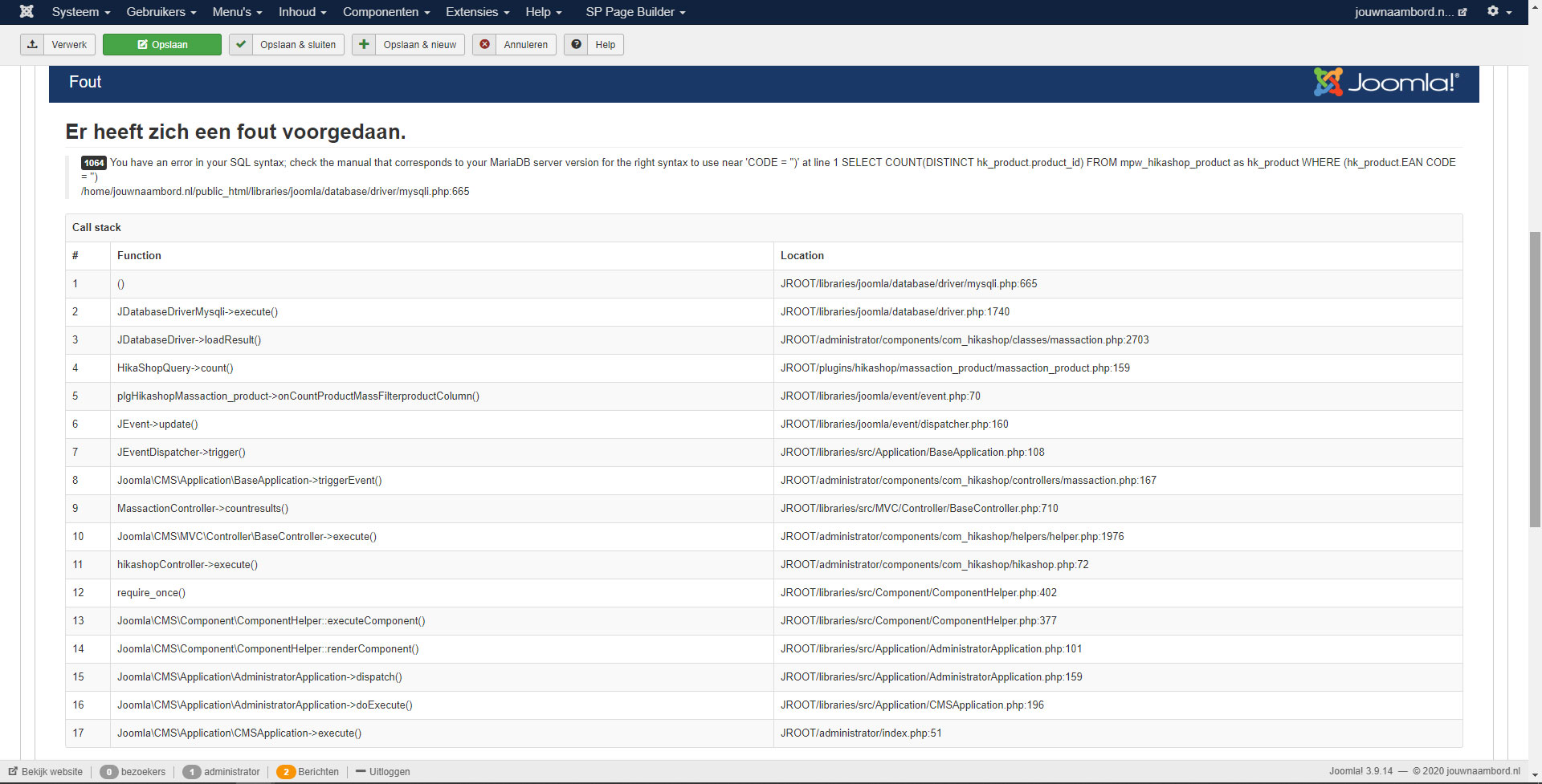

6 years 8 months ago #314756
Here's the new screenshot:
  • Posts: 86212
  • Thank you received: 14220
6 years 8 months ago #314758
Thank you, I see what is the problem.
Add the code:
$filter['type'] = '`'.$filter['type'].'`';
after the line:
$filter['type'] = strip_tags($filter['type']);
in the file administrator/components/com_hikashop/classes/massaction.php and that should fix the problem.
