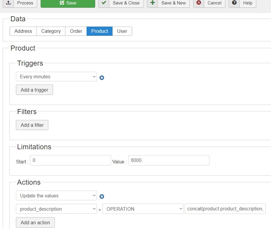

Could you provide a screenshot of the settings of your mass action ?

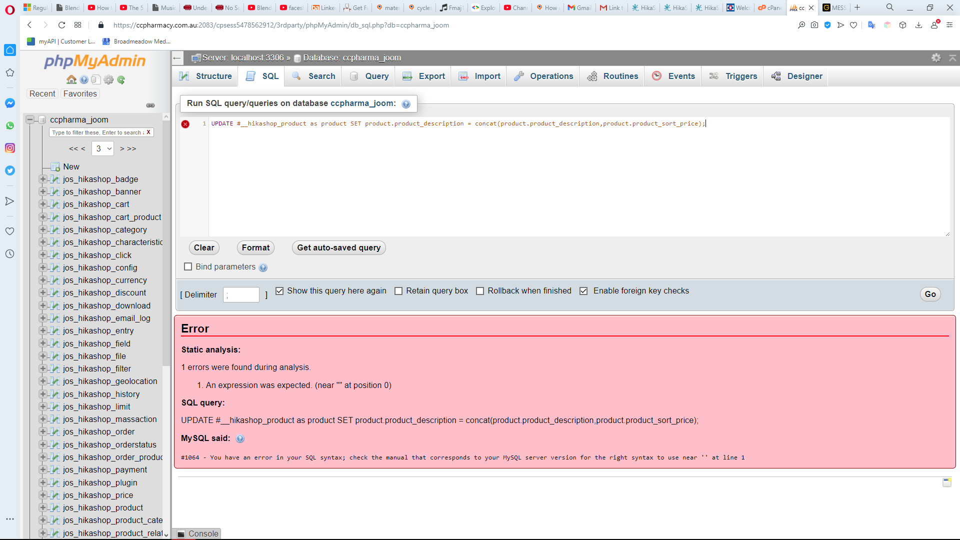

Note that you could actually also do the same in your phpmyadmin with a MySQL query:
UPDATE #__hikashop_product as product SET product.product_description = concat(product.product_description,product.product_sort_price);
Basically, the mass action will just run the MySQL query for you.

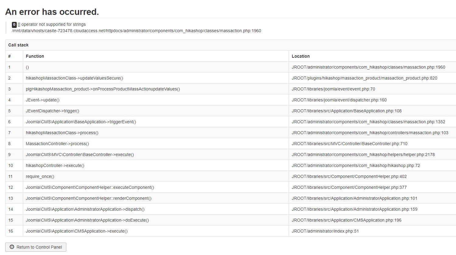

I've attached a screenshot. Unfortunately the field isn't large enough to see everything but the statement is the same as the one you recommended. I get the 403 error when I hit 'process' or when I hit 'save'.
Strangely, I AM able to copy single values between fields. The 'concat' statement causes the problem.
I hope you can solve this for me. It will help greatly. (edit) We have 8000 products and I'm happy to do this is smaller increments if it is possible.

8000 products in one go can be a lot. I would indeed recommend to do it in smaller increments. You can do that using the "limitations" area.
By default the "value" field there has the value 500, so that means it will only process 500 elements. And the field "start" allows you to set a starting point. So the first time you run the mass action, you want to keep that field set to 0, and the second time, you can enter 500. Then, the third time, you can enter 1000, etc. That way, you'll run the mass action in increments of 500, which should avoid any hosting restriction issue.
Regarding the error "[] operator not supported for strings", could you activate the "error reporting" and "debug mode" of the Joomla configuration and try again ? It should display more information along with that error message which will help understand what's going on.

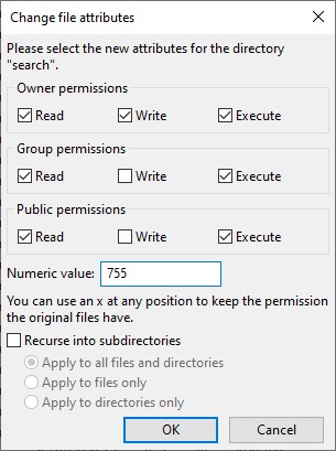

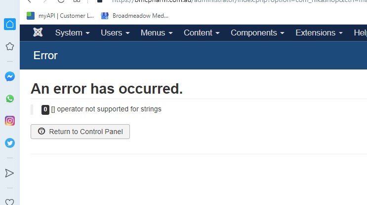

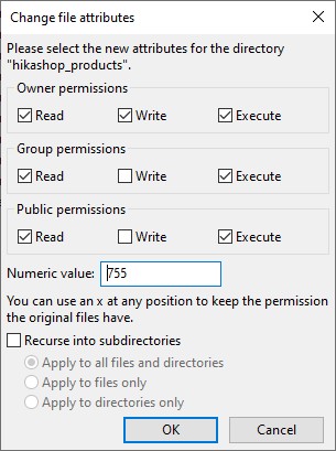

the 403 error remained for our cpanel based site saying 'access forbidden'. I didn't see any debugging info. I did select 500 items.
A different error occurred on Cloudaccess.net. i used 500 items with it, The outcome is below. I've also attached the error message from trying to run the sql query via myphpadmin.

That error indicates that what was written in the input field is invalid.
However, I just tried to run the same mass action with the text "concat(product.product_description,product.product_sort_price)" in the input field and it worked just fine.
So either it's a bug of the 4.3.0 and updating would help, or you made a typo in the input field.
And regarding the error with the MySQL query, it's because you didn't change #__ by the table prefix of your joomla tables. That prefix, which is apparently jos_ on your website, is normally generated dynamically when you install Joomla and thus it's a convention in the Joomla community to write #__ instead as Joomla's MySQL interface automatically replaces #__ by the table prefix you can see in your Joomla configuration when you send MySQL queries through it.

Thanks for that tip. I'll try the query again. What version of php should I be using? I'm asking this because the 'concat' operation used to work for me about a year ago.

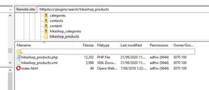

5 years 11 months ago #325022
Hi and thanks;
my version of the files is a bit different and as follows. Hopefully you can point out the necessary changes. Thanks, Ian and Stu

  • Posts: 203
  • Thank you received: 16
5 years 10 months ago #325081
I'm able to set the permission. What do you recommend?
With the attachment. It is being uploaded via the cron which has the function to convert the names of columns. However,
I'll double check if the value are getting through.
Ian, Stu
edit:
I've got ;
  • plugins folder permission 755
    search folder permissions 755
    hikashop_products folder permissions 755
    hikashop_products.php file permissions at 644
Let me know what to change it to. How high up and if I should change it recursively.
Thanks,
Ian and Stu
Last edit: 5 years 10 months ago by smithshop123. Reason: Adding in the permissions information
  • Posts: 86218
  • Thank you received: 14222
5 years 10 months ago #325094
The correct permissions to set to your files and folders depends on how your hosting server is configured.
If your FTP user is the same as the web server user, then you would use 755 and 644 or even 700 and 600.
But if the users are different, you might have to set the permissions to 777 OR to change the owner on the files/folders.
If a file is uploaded by the user "FTP" with the permissions 755, then only the user "FTP" has the right to modify the file. If later on the user "web server" wants to update the file, it will be denied.
In that case, the best would be to change the owner to "web server" so that you can keep permissions of 755.
But the quick and dirty move is to set the permissions to 777 so that you're sure the "web server" user will be able to update the file.
  • Posts: 203
5 years 10 months ago #325114
let me know what folders/files to change to 777 to ensure the successful update..The current setting for folders is 655 and it is 644 for files.I only ask because there are a lot of files, Only some of which can be updated recursively via ftp.
Ian and Stu
p.s. I'm also happy to PM you the ftp and admin access to undertake the process
  • Posts: 86218
5 years 10 months ago #325119
Since, your issue is with the products search plugin, you can just do it for the files in the /plugins/search/hikashop_products folder before installing HikaShop again.
The following user(s) said Thank You: smithshop123
