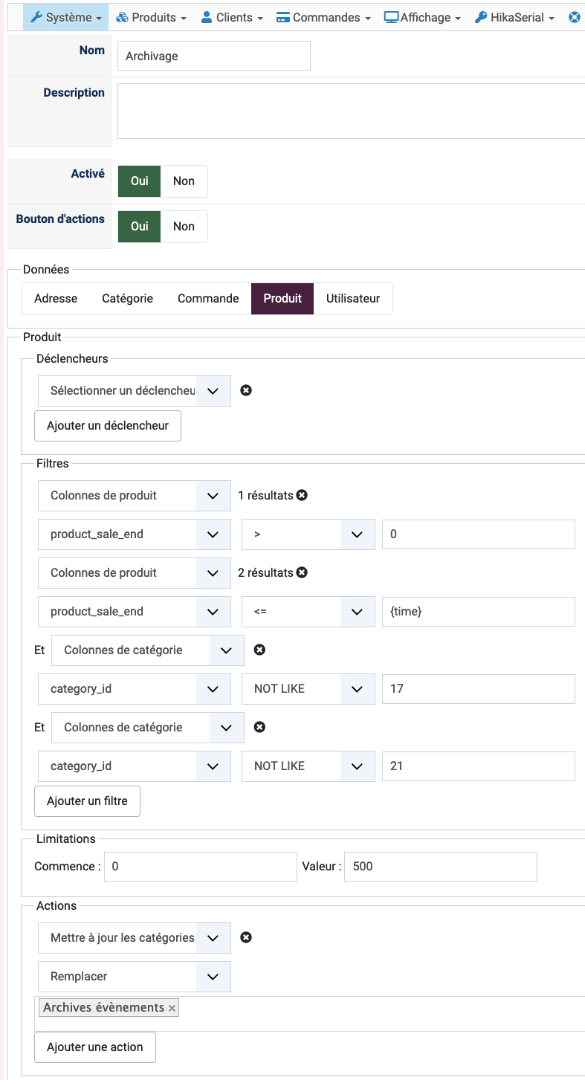

I want to create a massaction to change products category when the product_sale_end is over.
For testing purpose, I've 3 products.
Product 1 is in category 17 and has no sale end (product_sale_end = 0)
Product 2 is in category 13 and has a sale end at 2024-06-02 15:00 (product_sale_end = 1717333200)
Product 3 is in category 13 and has a sale end at 2024-01-01 04:00 (product_sale_end = 1704078000)
I want to change category of products to category 21 (archive)
- if product_sale_end exists (>0)
- if product_sale_end is over (<= to the current date and time)
- if the product's category is not 17 or 21
Given my filter:
Only Product 3 should be affected
Problem:
the 3 products are affected and their category is changed to 21
Why?

I've tried the same filters on my end and it works fine. However, I would recommend using != instead of "not like" for your category filters, although it didn't change anything on my end.
What I would recommend is to first only is a "display the results" action and select the columns product_name, product_sale_end and category_id and category_name.
That way, when you process the mass action you can see what products the system finds and if the values match with your filters.
And if they do, then you can change it to another action to update the category.
If you find an issue, I would recommend you to build your mass action like I do usually:
- first, I only have a "display the results" action with the columns I want to see. I process the mass action without any filter, in order to check that it can display what I want.
- Then, I add the first filter. I process again the mass action, in order to make sure that it properly filters the products based on what I think the filter should do.
- I then add another filter, process the mass action, check the results, etc until I added all the filters.
- Once I have all the filters I need and the results I want, I can add the real action I want (I even usually add a temporary extra filter on the product_id being equal to one product on the list so that I only process one product when testing the action. That way, if I make a mistake in the action, or there is a bug, it only affects one product which I can easily revert).
This avoids processing many elements at once, only to find out that I've messed up somewhere. And also, if there is a bug somewhere, I'm not impacted, or only marginally, and best of all, I know when the problem happened. So I can narrow down the issue, and it will be easier to understand what's going wrong.

Ok, it works now, thanks.
I haven't seen the "display the results" action, it helps!

I've just seen why my massaction didn't work: when triggered with the action button in the product listing the filters are not filtering! So it's the action itself which is triggered, not the massaction plugin as a whole.
Last edit: 2 years 8 months ago by marcmarc.

3. When you activate the "actions as a button" option of a mass action, it will add a button with the name of the mass action on the listing. However, as the name of the option implies, only the actions of the mass action will be triggered on the selected elements. The filters will be ignored. So that is not a good way of testing the filters of a mass action. For that, you want to use the "process" button of your mass action as I was recommending in my previous message.

I've understood, it was what I did before your explanation. I was only explaining why it didn't work for me and the same settings worked for you.3. …So that is not a good way of testing the filters of a mass action. For that, you want to use the "process" button of your mass action as I was recommending in my previous message.
