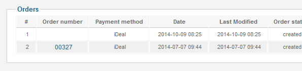

-- url of the page with the problem -- : www.nfornails.eu
-- HikaShop version -- : HikaShop Essential: 2.3.3
-- Joomla version -- : Joomla! 3.3.1
-- Error-message(debug-mod must be tuned on) -- : I can;t see order numbers .

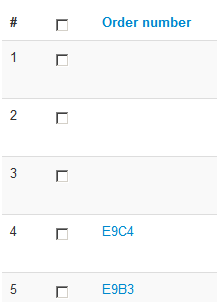

As the image show the order number work perfect till E9C4 order. Without that number I can;t see the order itself , only at my mail as it is created.
11 years 10 months ago #174410
Please update Falang. The version you got have a problem.
See : www.hikashop.com/forum/install-update/87...3-urgent.html#173554
(Or other thread which talk about a "order number" problem during the last two weeks).
The following user(s) said Thank You: RobertC
  • Posts: 32
11 years 10 months ago #174594
Thank you Jerome and Stephani from Falang. The update fix my problem.

I had smae problem, and it's fixed now with update of Falang.
But I can't see ordernumber/invoicenumbers yet from the ones that where effected. How can I solve that?
I'll keep on trying!
Last edit: 11 years 10 months ago by gasoline.
  • Posts: 32
11 years 10 months ago #174949
How it is fixed when you cant see order code numbers?? Update again Falang module. If doesn't work contact Falang. Did you try to test a new order?. Because the old empty field is not gonna fill up with the fix. Only effect new orders.
11 years 10 months ago #174954
In order to fill the missing order number, please see : www.hikashop.com/forum/install-update/87...ng-1-4-2.html#173692

Yes, already figured it out. Added them in the dbase by phpmyadmin.
