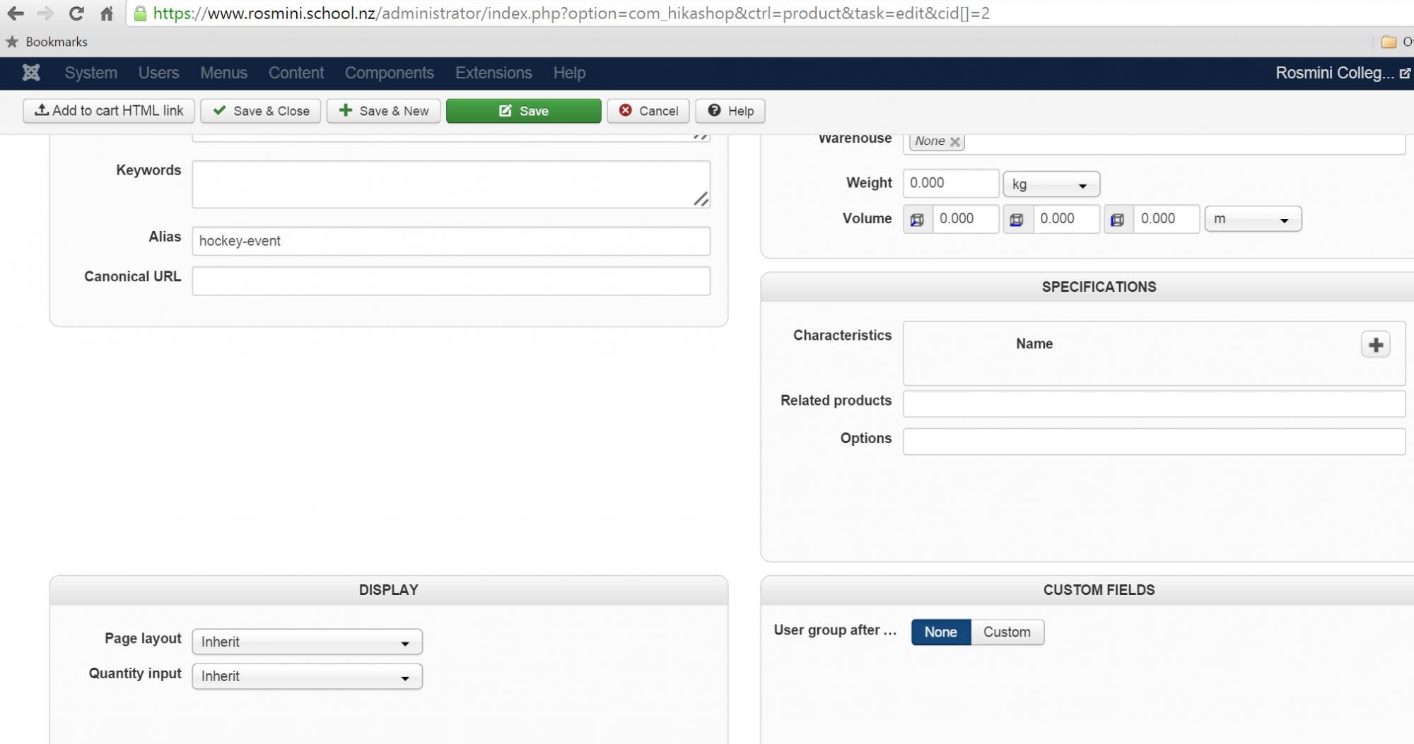

Hi, I have HikaMarket installed but my product does not have that option.

10 years 10 months ago #212354
This requires HikaMarket Multivendor, not HikaMarket Frontend.
With HikaMarket Frontend, you only have one vendor and thus no need to select a vendor in the products.
It seems that you're using HikaMarket Frontend, which would explain the issue.
You would need to upgrade your HikaMarket in that case:
hikashop.com/component/hikashop/product/cid-194.html
