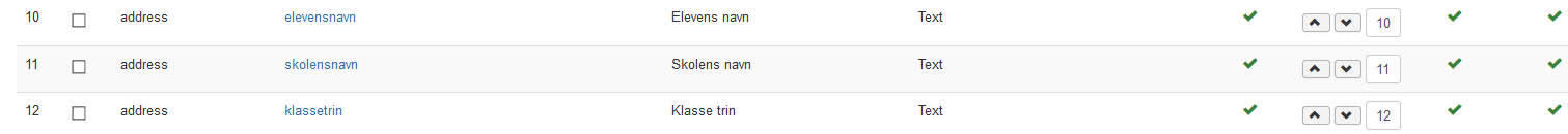

i cant figure out what i should write when i want to have extra fields i have made in the checkout.
i have added 3 new address fields.
goal:
Getting it to the invoice and in the backend in orders.
Do you have an guide i can use ?

6 years 3 months ago - 6 years 3 months ago #321811
by Philip
Replied by Philip on topic addrees fields on the invoice
Even if I read that you want add an address custom field, maybe you are going to have to used an Order type custom field.
After, you can put your fields block close to address block in your Checkout Workflow settings.
The advantage of Order custom filed is that it can be displayed in several view, and among this possibilities Invoice and backend page.
Note : Have a look on this documentation about display option per custom field type.
Hope this will fit your needs
Last edit: 6 years 3 months ago by Philip.

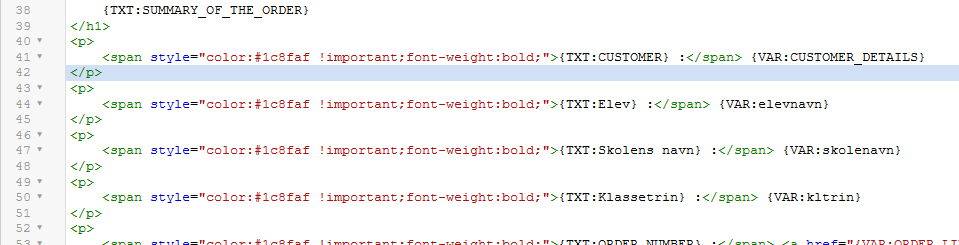

Replied by Nowweb on topic addrees fields on the invoice
i have made this in the administrator notification mail

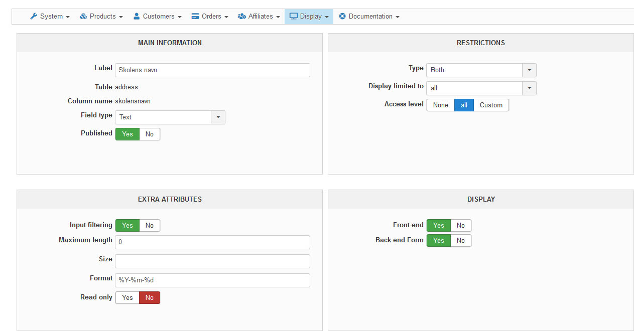

And i have made this in the Display > Custom fields
What do i do wrong here ?
I do not get the {VAR: } on the email fot the administrator notification
Code:
</p>
<p>
<span style="color:#1c8faf !important;font-weight:bold;">{TXT:Elev} :</span> {VAR:elevensnavn}
</p>
<p>
<span style="color:#1c8faf !important;font-weight:bold;">{TXT:Skolens navn} :</span> {VAR:skolensnavn}
</p>
<p>
<span style="color:#1c8faf !important;font-weight:bold;">{TXT:Klassetrin} :</span> {VAR:klassetrin}
</p>

6 years 3 months ago - 6 years 3 months ago #321856
by Philip
As said in my previous message you have to use order type custom field, address type can't be used in email (and several other HikaShop pages).
Keep same idea, but with order type custom field.

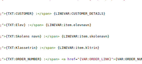

Now i have tryed to change the line to {LINEVAR:item.elevnavn} and {LINEVAR:product.elevnavn}
but it does not show on the administrator e-mail notification.
I have done your suggestions and followed the instructions on the website.
What am i missing or misunderstood.
Best regards
Brian
6 years 3 months ago - 6 years 3 months ago #322451
by Philip
As your custom field is an order type (or table), you have to follow to build your email tag, example :
{LINEVAR:TABLE.XXX}
=> In your case to follow your example :
{LINEVAR:order.skolenavn}
{LINEVAR:TABLE.XXX}

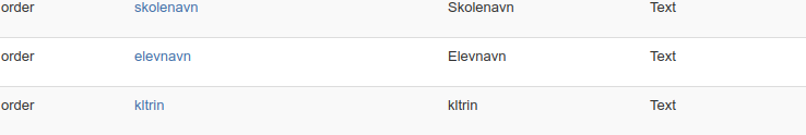

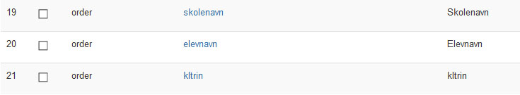

i still cant it to work
I have made the code like this

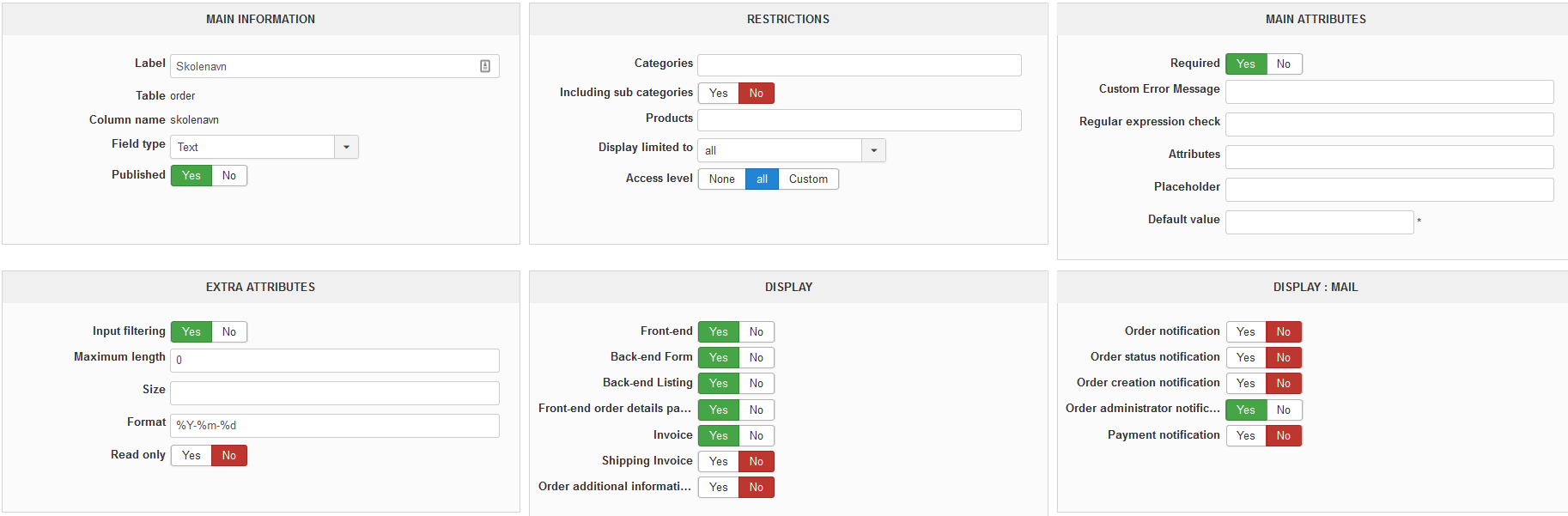

then i have made the custom fields like this

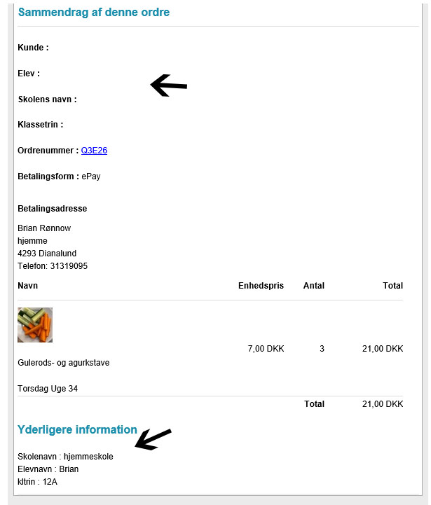

now the email notification look like this, the goal is the get the text from the buttom to the top.. but that do not work.
What can i do for move the text up??

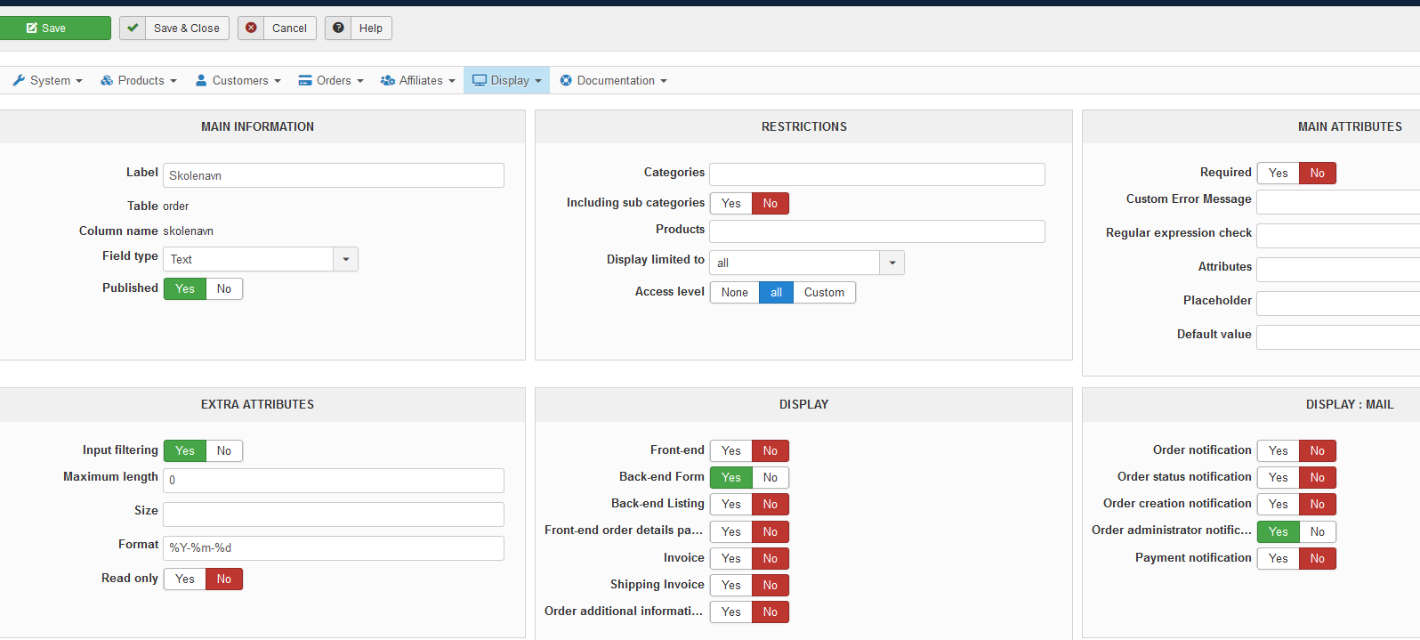

6 years 2 months ago - 6 years 2 months ago #322874
by Philip

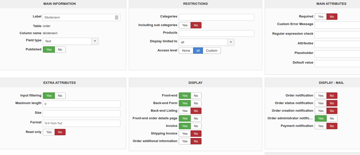

Among your elements there are something that I really don't understand, which is how you can have a "format" in Extra Attribute part, this type of parameter is normally only for date type custom filed...
we don't understand how it's possible, for some reason it looks like your custom field is "malformed", database manipulation, bug while you created it, so far we don't know...
The best move is to recreate your custom field, can you try this please ?
Last edit: 6 years 2 months ago by Philip.
6 years 2 months ago #322903
by Nowweb
Best regards
Brian
Thanks you, now it i solved.
Best regards
Brian
