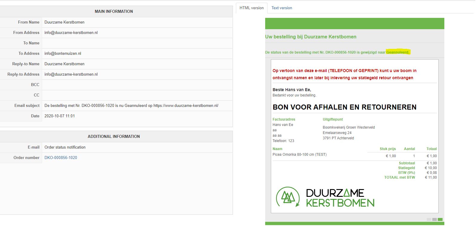

Now I can have a look too. Could you go in the menu Customers>Emails history, open the email that you got and provide a screenshot of the details of that email ?
It's likely that the email you got is not the "order status notification" email, but the "payment notification" email which is sent to the administrator when a payment notification is received, be it successful or failed. So you'll receive it, as administrator of the shop, even when the order is cancelled, so that you can check the situation if you want/need.

Hi, I am using cciDEAL at the moment, configured for Mollie. After you mentioned I just discovered there is a specific Mollie payment method for Hikashop, right? If I use this one, you are 100% sure that I won't get an email after cancellation?
About the emails: I'am 100% sure that it is about the "order status notification" since I have customized it :-) I also receive the "payment notification" as an administrator. So I wonder: what is the "Per status override" used for in case of cancellation if no email is sent anyhow?
Nevertheless I hereby send you a screenshot of a cancelled order of today. "Geannuleerd" is Dutch for Cancelled.

The "order status notification" email can be sent when an order goes from an order status to "cancelled". For example, if you manually change the status to cancel in the interface and click on the "notify user" checkbox.
So the email can handle all the order statuses, and that's why there is a "per status override" even for the cancelled status.
All I'm saying is that usually payment plugins don't send that email to the customer when the order is cancelled automatically by a payment notification.
Now as you're using a third party payment plugin, you should report the issue to the support of that payment plugin. Maybe they have a setting you can change to avoid that, or maybe they need to do some modification in the plugin.
HikaShop does not come with a Mollie payment plugin. I suppose that you're talking about this plugin:
www.hikashop.com/marketplace/product/153...ie-by-skyspider.html
While it is sold on our marketplace, we are not the developers of that payment plugin, it's the SkySpider development team.
I can't say how that payment plugin behaves regarding the cancel email.
I would assume it doesn't send a notification to the customer, like we do in our payment plugins, but I can't guarantee it.
