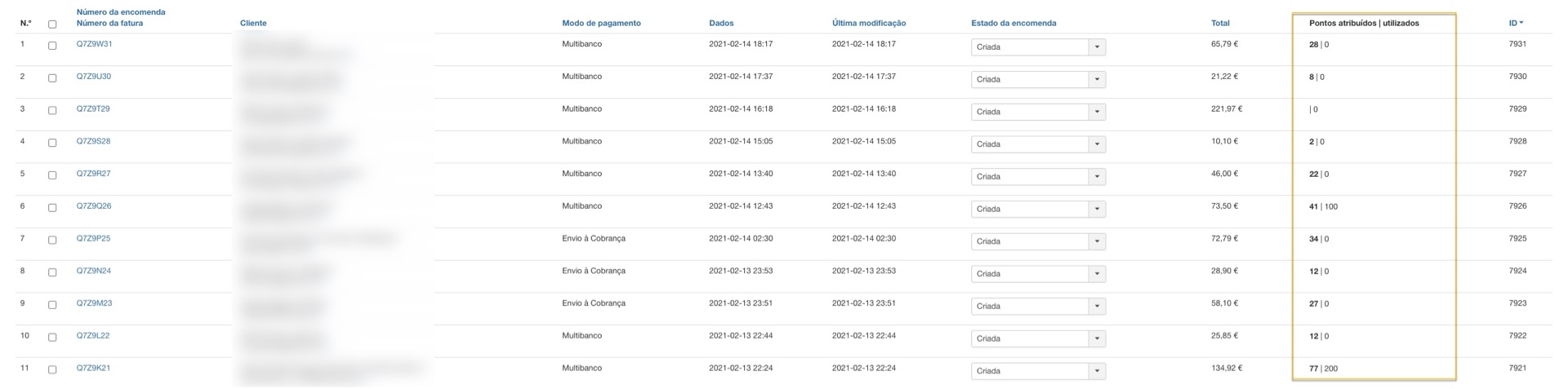

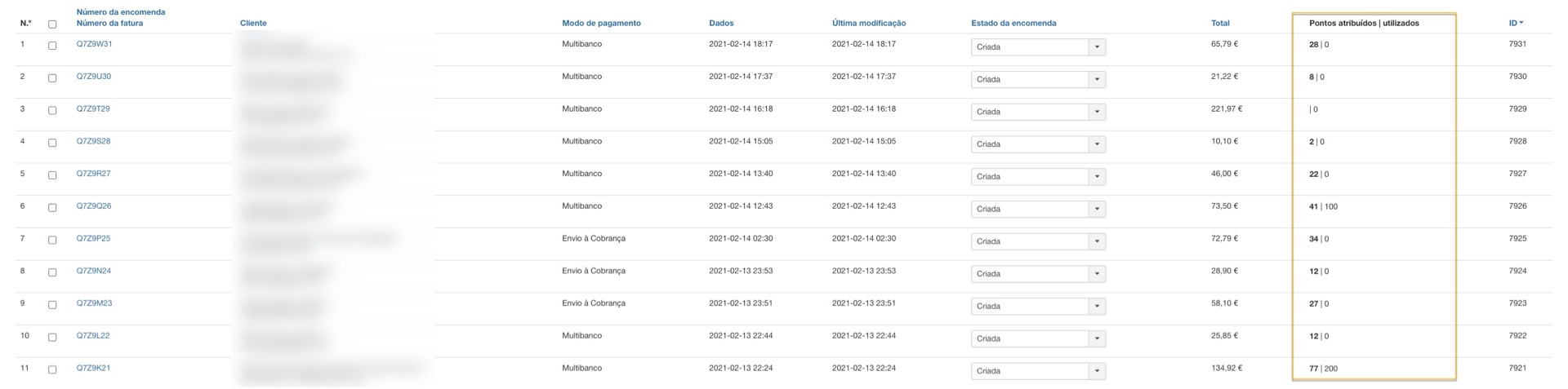

  • Posts: 45
5 years 6 months ago #329552
Hello Jerome,
As I said in my first message, I’m looking for a simple solution to see the user points changes (earns and used) in the backend order. Why? Because I detect that in some moment of the second quarter of 2020 some users earned much more points than they should in their orders. I detect this now as I told in my second message. As I said in another post ( www.hikashop.com/forum/orders-management...ts-issue.html#329245 ) there are other issues with Hikashop user points. So, I’m looking for something simples and visual that shows the earn and uses of points without the need to dive into the database.
I appreciate the quick answer from Nicolas, I tried and how it didn’t work I tell here.
If you want a suggestion, you may consider in future updates add the points earned/used in order details.
At this moment a have a simple solution as you can see in the image attached (Pontos atribuídos: earned points | utilizados: used points).
Best regards,
Bruno
Last edit: 5 years 6 months ago by bsimoes.
