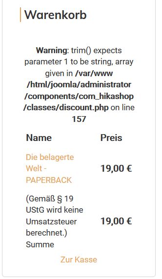

-- Error-message(debug-mod must be tuned on) -- : Warning: trim() expects parameter 1 to be string, array given in /var/www/html/joomla/administrator/components/com_hikashop/classes/discount.php on line 157
When trying to order with discount, the discount is not calculated. The following error message is shown.
Thanks for help

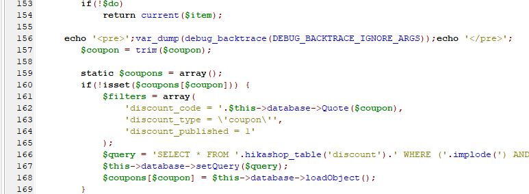

Could you temporarily add the line of code below:
echo '<pre>';var_dump(debug_backtrace(DEBUG_BACKTRACE_IGNORE_ARGS));echo '</pre>';
Just before that line 157 in /administrator/components/com_hikashop/classes/discount.php and reproduce the error ?
That should display a callstack of the situation until where the error happens so that we can better understand why it's displaying that error.

The error happens in both areas. It first occurred in coupons. Then I changed and entered a discount for some customer. But got the same result.
The error message appears on top of the summary of the shopping cart.

Well, I told you to add the code just before the line number 157 in the file /administrator/components/com_hikashop/classes/discount.php
So I don't know what more information I can give you regarding the "what file at what position", since that's precisely what I gave you.

4 years 9 months ago #337196
OK, first I tried to implement the newest version of the shop. But this did not change the situation. Then I added the line mentioned before line 157 in discount.php see pic.
And the result was:

popping up over the error message
Is this helpful?
Last edit: 4 years 9 months ago by nicolas.

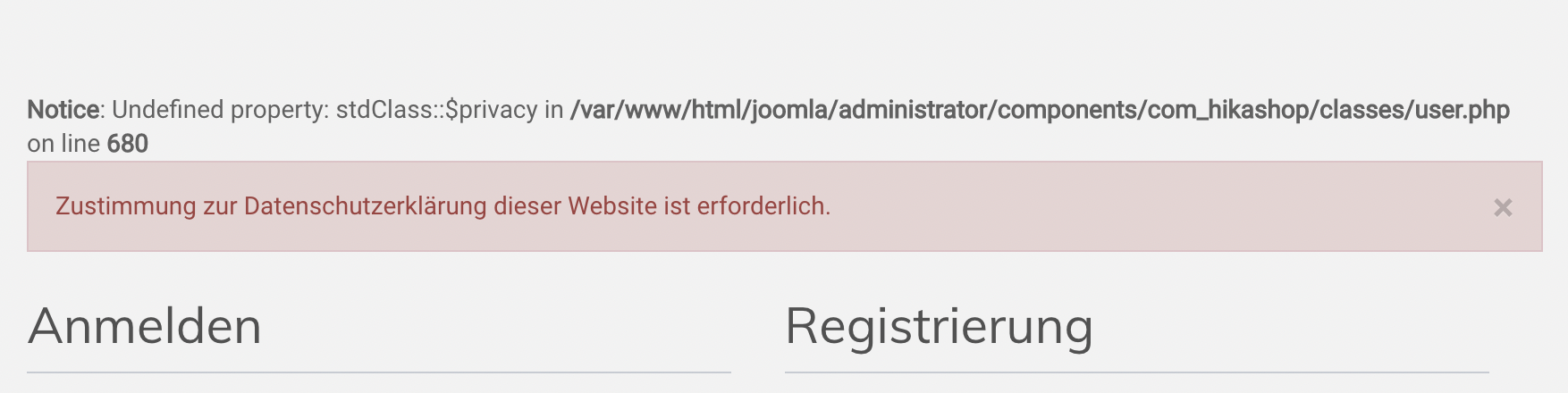

Since yesterday, we get complaints from customer that registration or shopping failed. I could not really understand what happened, but they sent me the attached screenshots.

  • Posts: 86077
  • Thank you received: 14186
4 years 9 months ago #337231
Thanks for the details. Maybe you have something like opcache on your hosting server ( wp-rocket.me/blog/what-is-opcache/ ). This will make PHP automatically cache the compiled versions of the PHP files for a while so that it saves resources.
But in that case, it's possible that after an update the cached version of the files are not taken into account immediately.
It's possible to manually flush the opcache cache : ma.ttias.be/how-to-clear-php-opcache/
I looked at the code but besides the fix I was talking in my previous message, I don't see any reason for these to happen.
So if it's now working properly, it just mean that the update fixed the problem.
The red error message upon registration indicates that you've activated the privacy consent plugin in the Joomla plugins manager but that for some reason you didn't agree to the privacy consent when asked on the registration form.
It could be that you missed it, or it could be that it wasn't added to the registration form.
This last case could happen if you have an override of the sub_block_login_registration.php view file via the menu Display>Views based on an old version of HikaShop which didn't support the privacy settings.
The following user(s) said Thank You: politikchronist

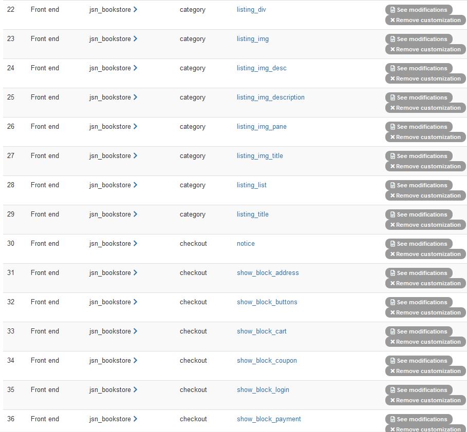

  • Posts: 69
  • Thank you received: 5
4 years 9 months ago #337238
uups. I may have a problem. I used JSN_Bookstore template, and now I see that they did many modifications. And I fear to change anything in here.
The nice guys, who helped a lot from Vietnam, announced just a few weeks after I was proud having realized the site, that they are only giving support for some more month. So may be soon I need to switch to a new template. May be we will be in a mess without a Joomla specialist. But as a non-profit organization, we might need to collect money to finance it.
I liked the easy way of defining the pages very well. But now may be I have to switch soon to another template. If you have any proposal what template might make the less issues when changing from JSN_Bookstore, I would appreciate your mentioning it.
My own small overrides were only on the language file.
  • Posts: 86077
4 years 9 months ago #337246
So you confirm that you don't see the privacy consent area on the registration form of the checkout and that the red error message says that you need to validate the privacy consent option ?
If so, then yes, yt's probably linked to an override in your template.
Search for the file templates/YOUR_TEMPLATE/html/com_hikashop/checkout/sub_block_login_registration.php via FTP.
If you find it, rename it in order to deactivate it and check your checkout registration form. You should now see the privacy consent area. Hopefully, the registration form still looks the same without the customized override and so you can keep the view file override renamed.
  • Posts: 69
4 years 9 months ago #337247
Thank you very much. I found it, renamed it, tried it, and it showed up in firefox as expected. So hopefully this will solve this problem.
Thanks again!
