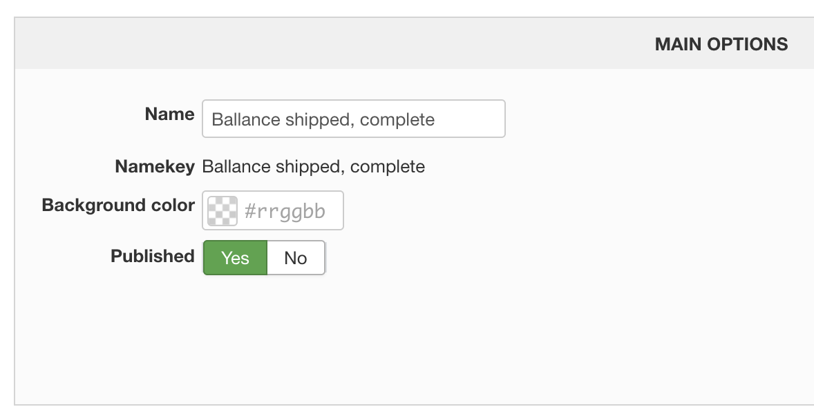

I was able to create a per status override with a status I first created in System>Order statuses.
I suppose it might be might to special characters in the namekey of the order statuses you created maybe ?
Could you provide more precise information on the situation ?
A screenshot of the settings of the status and your version of HikaShop, PHP, Joomla and your browser would be great.

You mentioned special character sin the namekey, and taking a look at what the client created there is a comma in the namekey. Could this be the issue. Is it possible for me to change this directly in the database table or would it affect other areas if I just chnage it there?

I did try on my end with a comma in the namekey and I didn't have a problem either. I used the order status namekey "Test , with , commas" and the modification of the HTML section worked fine in the "per status override" popup:
i.imgur.com/HPVvjQ2.png
And I got the file media\com_hikashop\mail\order_status_notification.testwithcommas.html.php created on my test website. As you can see, the makeSafe function stripped the commas and spaces and force the lowercase.
