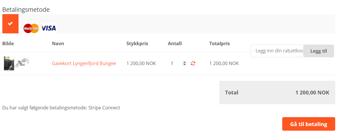

Could you also point me in a direction for addressing an issue with the position of the coupon field/button on the checkout page? It's sort of hanging between two rows (attached).

1. The position of the coupon field on your checkout is changed by the CSS of your template.
The file /templates/r_glamour/custom/css-compiled/hydrogen_19.css has this CSS:
body .hikashop_checkout_page .hikashop_checkout_coupon {
    display: block;
    margin: 1rem 0;
    float: right;
which forces the coupon area to hang there.
Since that CSS is compiled by your template, I'm not sure what's the best approach to change it in an effective manner. I would recommend contacting your template provider about this question.
