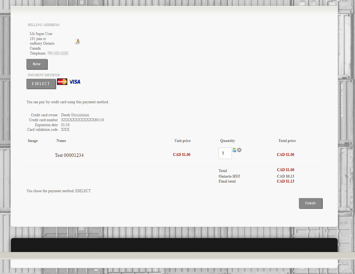

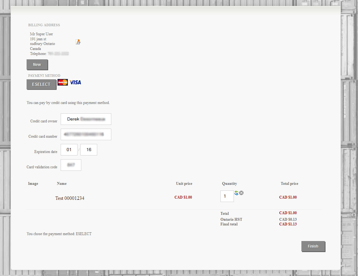

Regarding your screenshots, the first one is the one where the customer enter his information and the second one when HikaShop display the summary of the credit card info.
So you have to click once more to validate the payment.

11 years 11 months ago #152213
Yeah, no matter how many times I click finish in the check out, it brings me to the second screen shot. With the error at the top. This problem seems similar to ben_whitney's thread near the end.

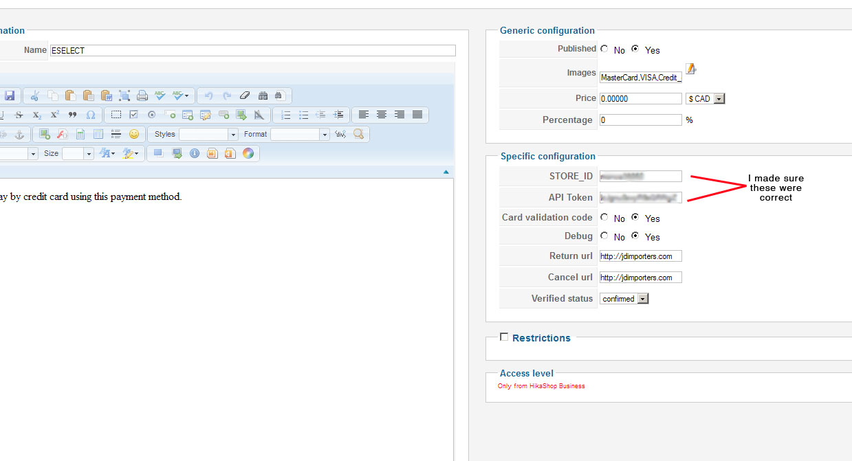

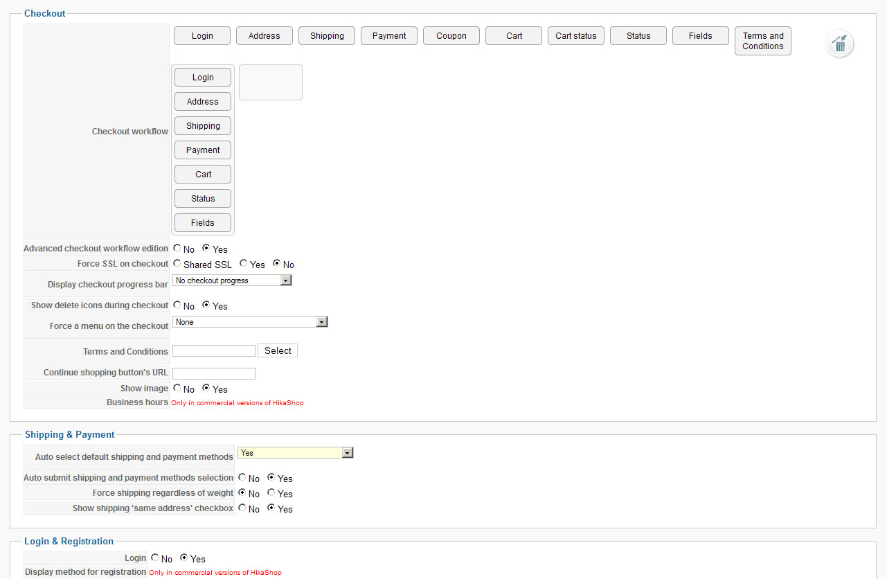

  • Posts: 40
11 years 11 months ago #152378
Sure. Here is the screenshots for my payment set up and my checkout flow. Can anything else be affecting it?
