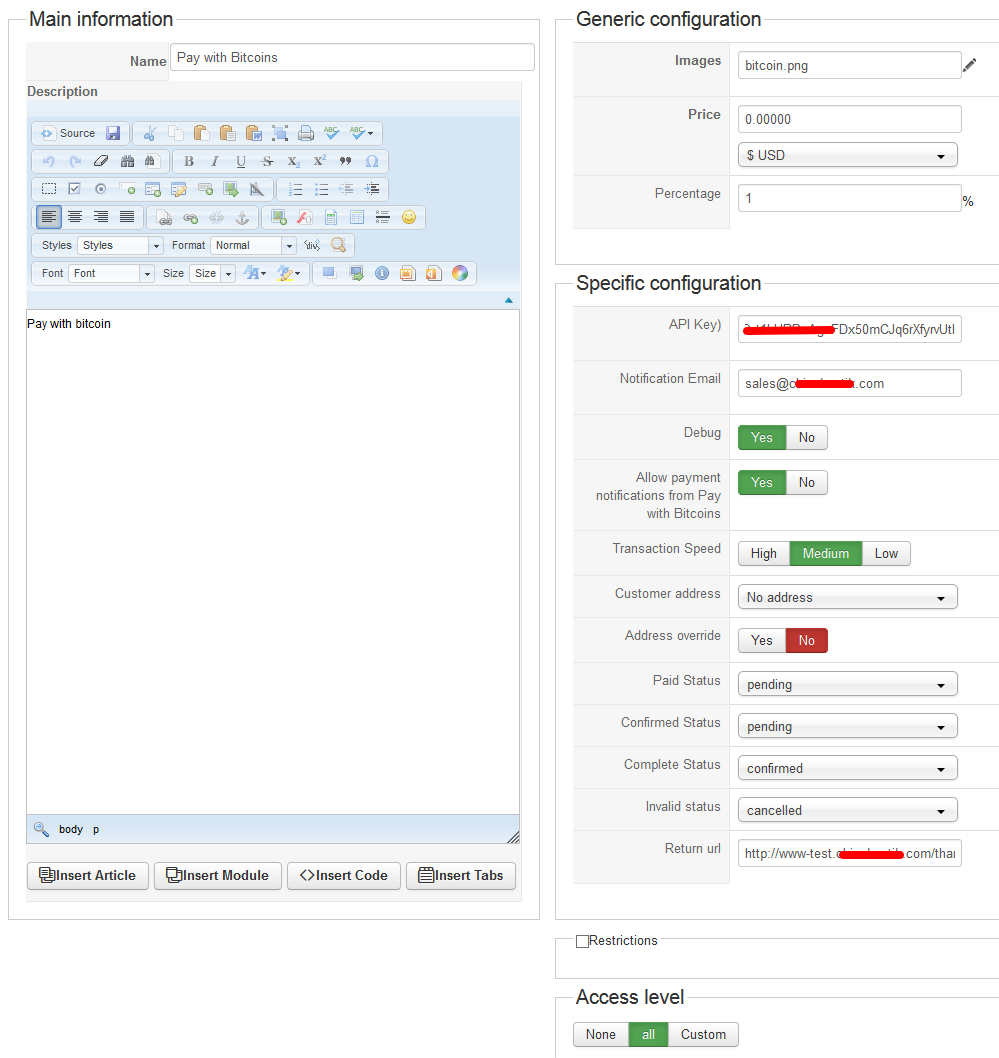

Additionally here is a screenshot of my plugin configuration,
Last edit: 12 years 2 months ago by cbadmin. Reason: Added screenshot

Order status still stay on 'created' and never change. Check screenshot of my configuration in previous message.
