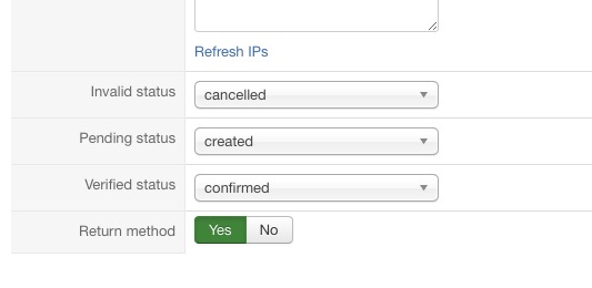

  • Posts: 112
10 years 4 months ago #231878
For some reason, it does not work the way you describe it. I just did a test order and closed the paypal window without completing the order or cancelling it. The order was marked as "confirmed". But, as you have described, the order should have been marked "incomplete". I am sending you a screenshot of the Paypal settings that confirms this. The "Return Method" is set to "Yes". Is that the correct setting?
I just ran another test order on a different website with the same result. The other thing I noticed is the confirmation email is being sent prior to the person being sent to the paypal page. The email confirmation should not be sent until the order is completed beyond the Paypal page. If an email confirmation is sent prior to the completion of the order, that is incorrect. There needs to be a check in the PHP code such that if it is a Paypal order, the confirmation email is not sent until the "confirmed" order is returned from Paypal.
I have unpublished the Paypal payment method on the website until we can get this figured out. So, I cannot ask you to test it on one of our sites. But, it should work the same way if you test it on one of your test sites. But, as I said, I just ran a test order and the setting appears to immediately be set to "confirmed" when the visitor is taken to the Paypal page.
  • Posts: 85952
  • Thank you received: 14142
10 years 4 months ago #231902
Of course, we don't have the problem on our end.
Orders are created with the status "created" before the payment.
And after the payment, when PayPal notifies the website of the payment, the payment plugin changes the order status to "confirmed".
HikaShop and the PayPal plugin have always worked like that. And they work like that on our own website too.
If the order is with the "confirmed" status even though the payment hasn't been made, it's probably that you changed the "Default order status" setting of the HikaShop configuration to "confirmed" instead of "created", or that you have a mass action configured which automatically confirms the orders when they are created, or that there is a third party plugin messing with the order statuses.
  • Posts: 112
10 years 4 months ago #232016
You are correct. The order status was set to "confirmed" on order. That has been corrected.
