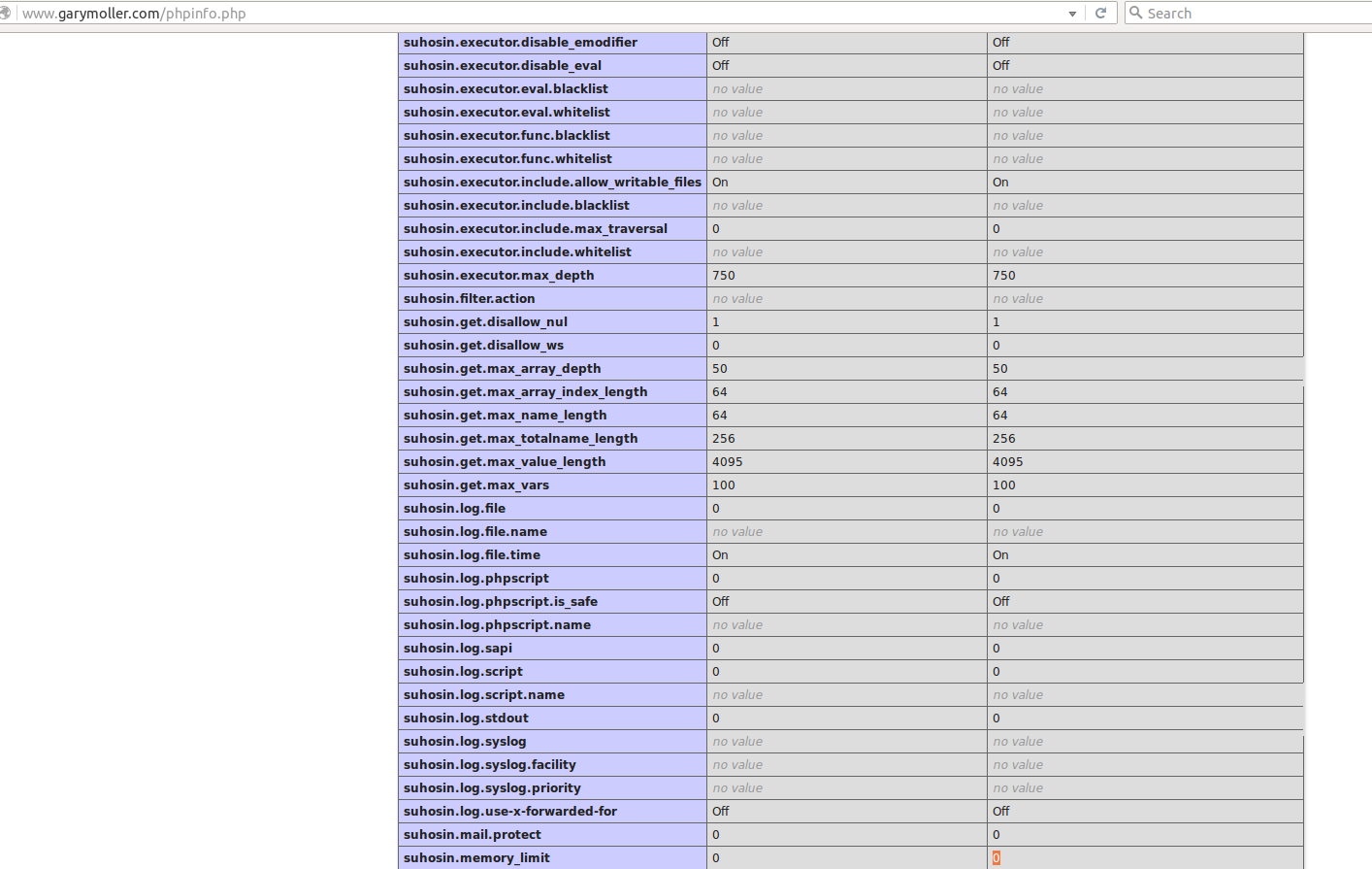

I've set up PX Pay exactly as my other client and set the php.ini values to:
suhosin.get.max_value_length = 4095
But still getting the return URL error.
The PX Pay payments are going though, just can't return back to the website.
Here are the suhosin values:
