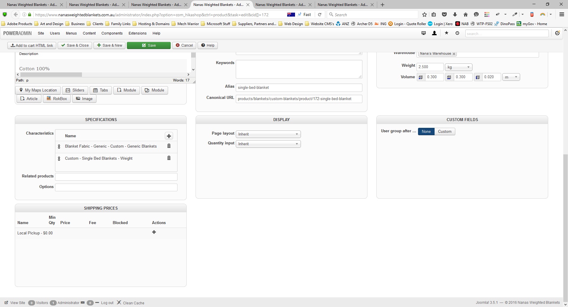

10 years 5 months ago #236480
1. Could you provide:
- the link you get on the products listing for one of these products
- a screenshot of all the settings of that product
2. The error message is on the alias, not the name nor the code. So you're not checking the correct field.
You need to check the value of the "alias" field of your product. It too needs to be unique.
  • Posts: 127
  • Thank you received: 8

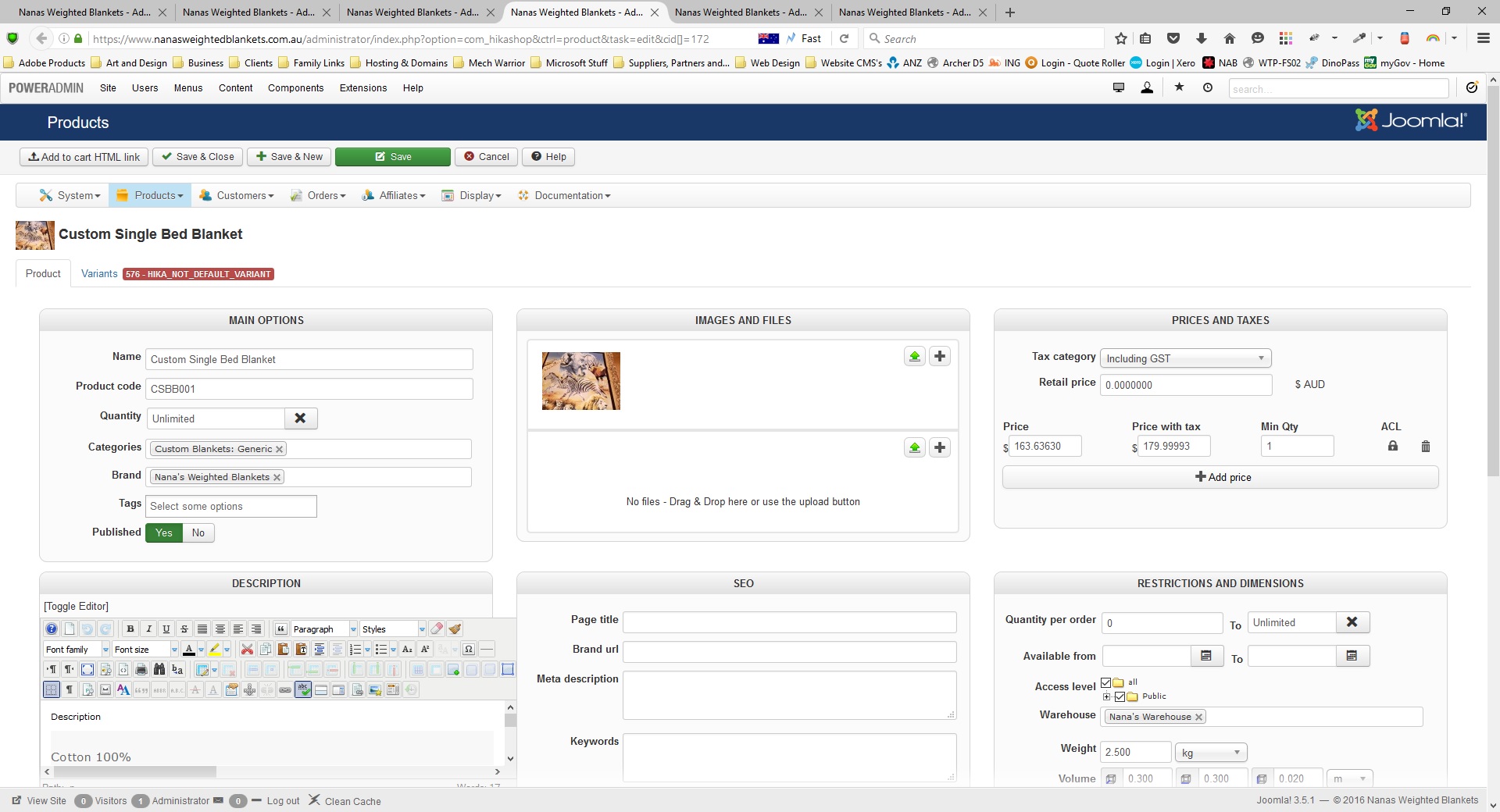

10 years 5 months ago #237276
If you select the from this menu;
Custom Blankets: Generic
Custom Single Bed Blanket
redirects to
Single Bed Blanket
Also we are now seeing this message on the product;
'576 - HIKA_NOT_DEFAULT_VARIANT'
Last edit: 10 years 5 months ago by twhcreations.
  • Posts: 86216
  • Thank you received: 14222
10 years 5 months ago #237554
1. I don't see what you mean.
It's normal that you first link doesn't work. There is no product with that alias in them.
And regarding the link directing to another product, it just means that you have two products with the same alias.
2. Regarding the error with the variants, go in the Variants tab and click on the default icon for one of the variants and that will solve the problem.
