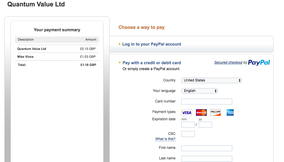

Currently it is adding the 15% of Quantum and the 3.4% Paypal fees to the product price of £1, bringing it to £1.18. See Screen shot.

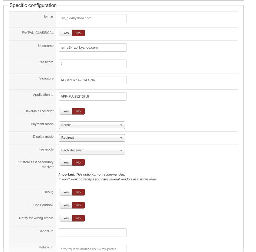

I also attach my configuration screen shots.

4. click Finish on the right bottom and you should be directed to the Paypal screen showing the £0.15 and £0.03 being added on top of the £1. - www.paypal.com/webscr?cmd=_ap-payment
I figured you were referring to Hikamarket in your second point. Well the store has always been set to be paid directly. See attached screen shot.

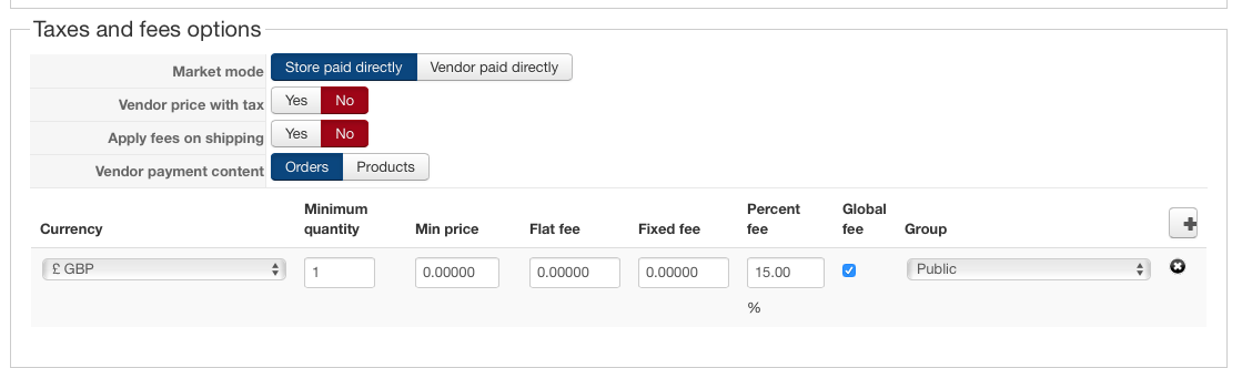

I am attached the top part of that configuration screen, which clearly has the 15% in there, indicating that the balance 85% should go to the seller.
Please also check on the earlier hockshop screen shot i sent, it clearly show that the 'Fee mode' is 'Each Receiver'

I didn't notice it the first time but yes ; your Paypal method have a "payment price" configure with "15%".
So if your order product total is "£1", the order total will be "£1.18" (£1.15 without taxes)
pasteboard.co/13Foa0id.png
So, the data you have in the plugin Paypal Adaptive is right according to the HikaShop order total.
HikaMarket goal is to split the order total to the different vendor and you can configure if you want to include shipping or payment fees.
As far as I can see ; there is no issue with HikaMarket or the Paypal Adaptive plugin.
But you need to know what you want to do with the payment price.
Please notice that the "payment price" is handle directly by HikaShop and that setting is something to add extra fees in the customer order ; exactly like the shipping price to include customer fees on the shipping delivery cost.

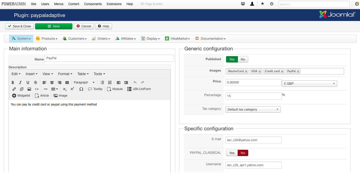

So just remove the setting "percentage" in your Paypal Adaptive configuration (in the section "General configuration")
Cf your screenshot : www.hikashop.com/media/kunena/attachment...5-19_at_17_51_59.png
So HikaShop won't add the "15% payment fee" in the order.
