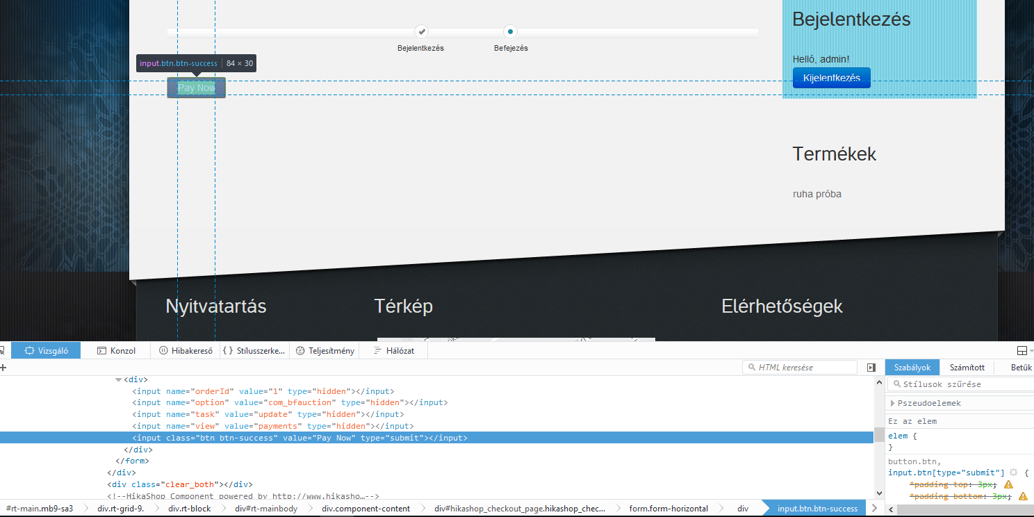

  • Posts: 85
9 years 11 months ago #248126
I attach a print screen about the Pay Now button what I would like to disable in the Finish section of order.
  • Posts: 26376
9 years 11 months ago #248129
It looks like your "Pay Now" button is coming from "bf auction" and not HikaShop.

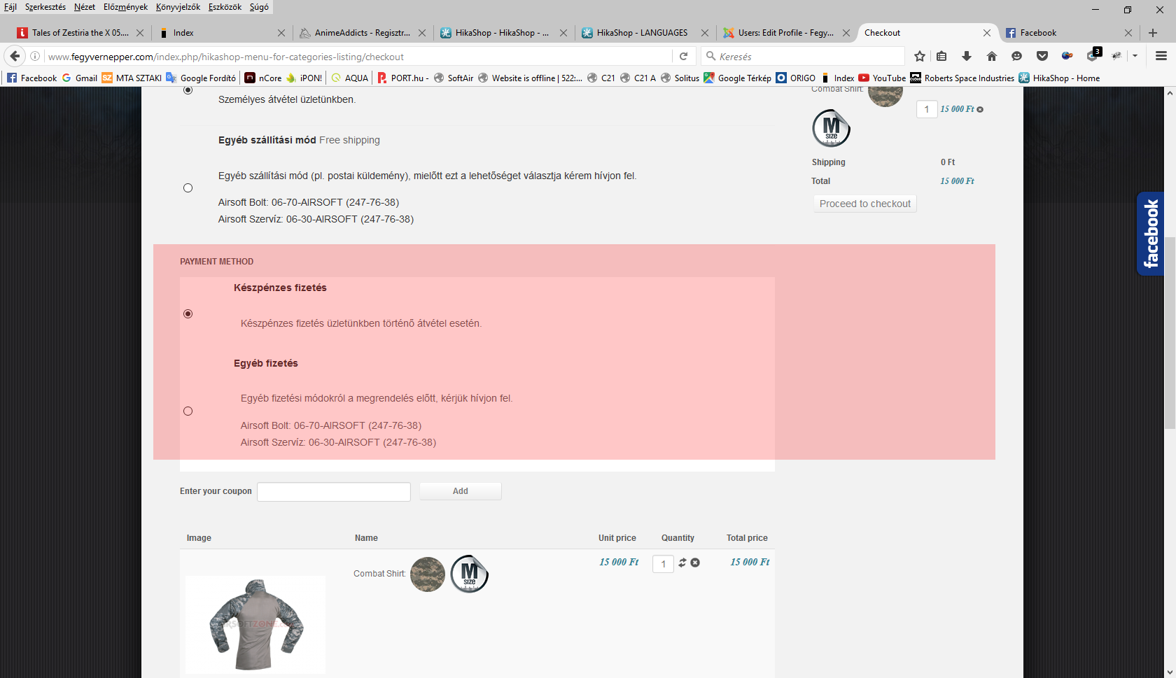

  • Posts: 85
9 years 10 months ago #249630
Finally I have finish lots of work, so now I can reply much faster, Sorry.
I wrote a mail to BF auction and seems BF Auction and HikaShop uses code from Tech Joomla's common payment API.
Sure, If I disabled the "HikaShop common payment API plugin" than I will lost the Payment Method section on the frontend, like the attached screenshot named payment_method.
Because in the System/Payment I use the HikaShop common payment API plugin.
I try to use something else.
Last edit: 9 years 10 months ago by palee3.
