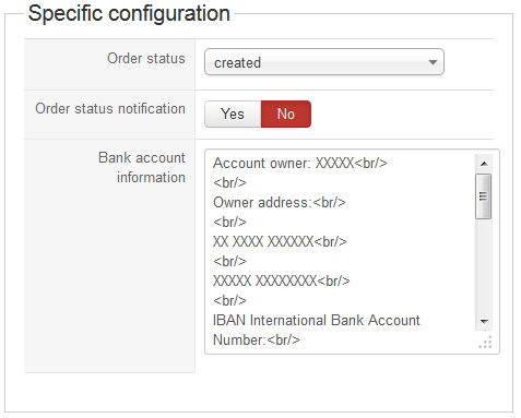

Additional Information
- Order status : As HikaShop cannot know when the payment is received by your bank, you will have to set the appropriate status after checking you bank account incoming transfers. In the mean time, you have the possible to set the order to another status than the one that you can configure in the menu System>Order statuses. For example, you could create a status "pending" and use it here instead of the "created" status which is set by default to any order created.
- Order status notification : When you set the order status setting above to another status than the one that you can configure in the System>Order statuses menu as default one, you can choose if you want the order status notification to be sent or not when the order status of the order is changed.
- Bank account information :Here, you need to write your bank account details so that your users will be able to send you the bank transfer. You can of course, write anything you want, the default text is just an example of how you might want to do it.
