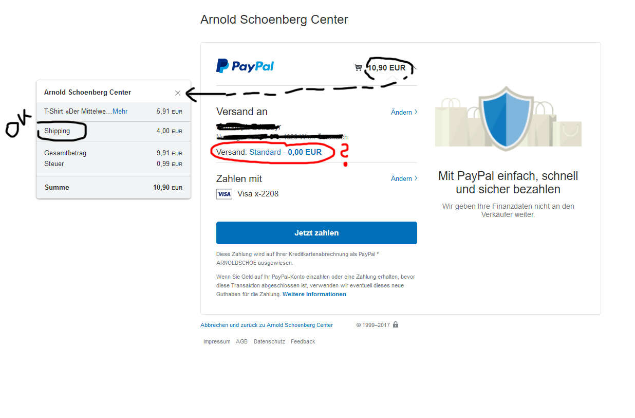

2. Doubled display of the shipping cost: Yes, you provided me with a link on how to setup taxes and shipping in paypal, but that is not the point of the problem. As paypal described to me, the problem is that Hikashop transfers the calculated shipping costs as "normal" cart items to paypal and not as a specific shipping cost variable. Paypal cannot detect and recognize these costs as shipping costs, that´s why it adds shipping costs again. (In paypal you cannot deactivate the shipping cost, you can only set them to 0). You said it has something to do with the paypal API, and paypal says it has something to do with Hikashop.
So, I don´t have a clue whose fault it is. Maybe it is my webhost?

Also, as I said before, please check that you didn't configure any shipping cost in your PayPal merchant account. It's possible that the shipping fee of 0 could come from a shipping cost of 0 configured in the merchant account.

Concering the problem with the doubled shipping cost, it seems to work now. There are no more doubled shipping costs displayed twice. I think the problem was a wrong/right setting and/or a cache problem. Anyway.

However I was now getting an extra shipping charge when I was already charging for shipping on the website. The solution was to remove all shipping options from my PayPal account. Under "Profile and Settings" go to "My Selling Tools" and "Shipping Calculations". Remove any shipping calculations here.
I had added USPS Standard Domestic because that was how I was going to ship. But this told PayPal to add a shipping cost because it did not receive a shipping cost from HikaShop. The shipping cost in HikaShop comes through to PayPal as another item purchased, not as a shipping fee. So if I purchases one item from my website, which includes shipping, PayPal sees that as I purchased TWO items, and tallies a shipping fee for two items.
