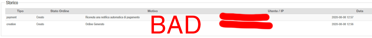

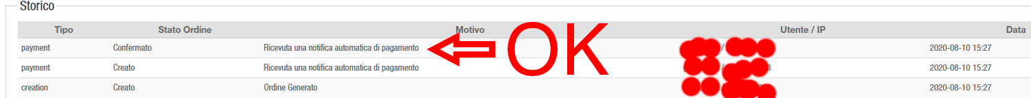

Hi, some customers have placed orders on my site. They paid by credit card through the Plugin Stripe V3 with connect 1.0.5. The problem is that Hikashop, in some cases, did not register the payment confirmation. In the history of these orders, I only find "payment created" but I do not find "payment confirmed" even if I received the payments on Stripe. I sell courses online, if payment confirmation does not arrive, users are not automatically enrolled in courses after payment.

Hi, unfortunately I don't know what elements to provide you to understand what generates the problem. Is there a log file that I can check?
