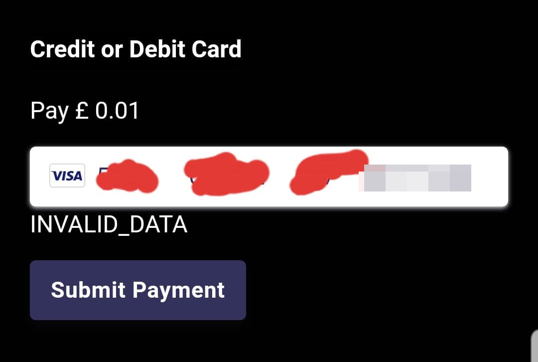

I have a site which uses PayPal and Stripe. I take a small deposit 1p so it registers as an order . However with Stripe I am now getting an invalid data message. It appears that a couple of customers have tried and they get the same message.
I would appreciate some feedback please?

  • Posts: 447
  • Thank you received: 20
5 years 5 months ago #329238
sorry I missed the last reply, don't seem to have received a notification. Link to a screenshot below.
The customer says that the option was working prior to making some changes to taxes.
Has there been an update to the plugin?
David

  • Posts: 26376
5 years 5 months ago #329260
Yes your issue is related to the amount of your order, as trevsmiff and I wrote you previously.
