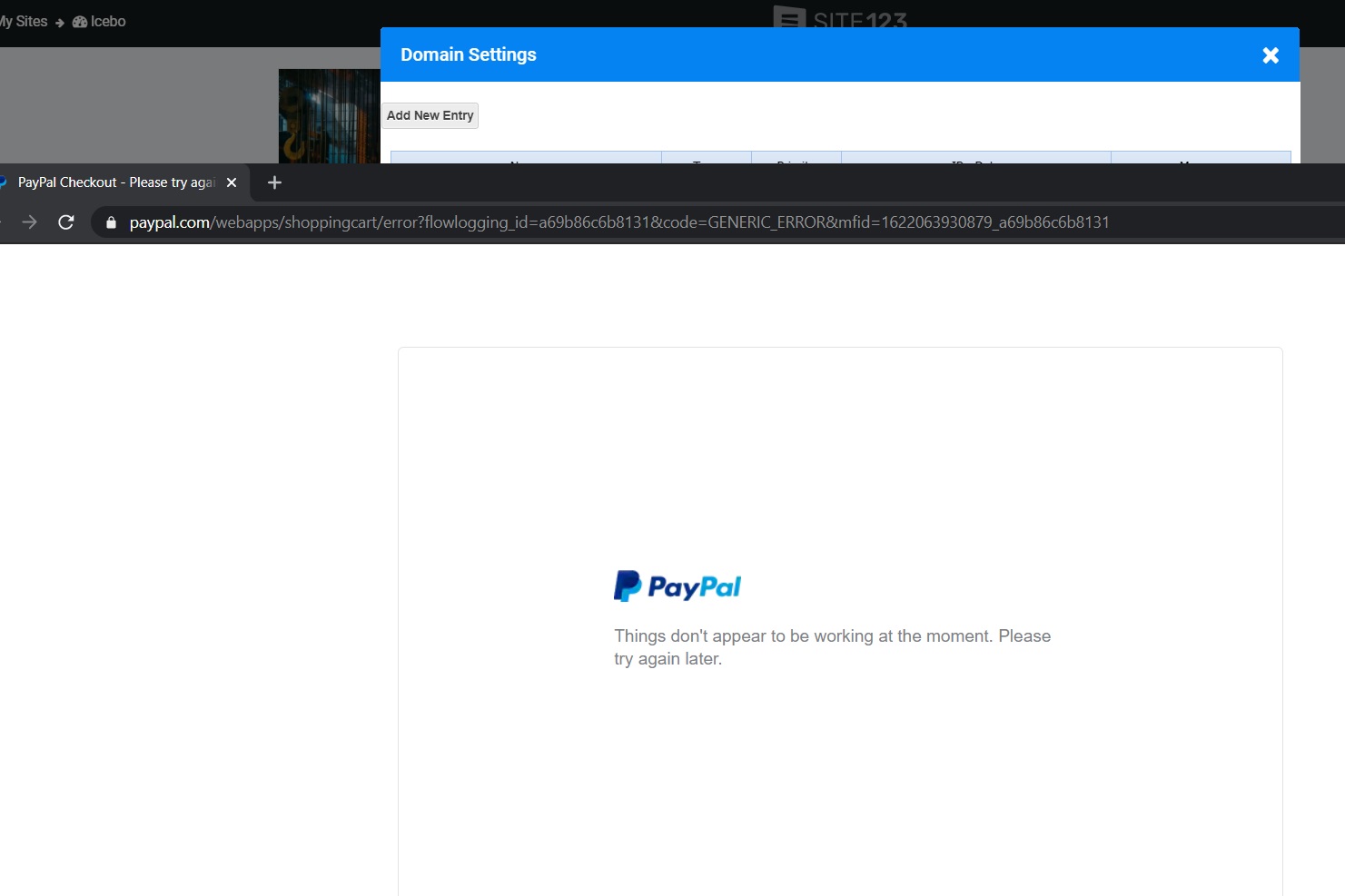

  • Posts: 12
5 years 3 months ago #332936
I can't figure out what I need to do with the express plugin. I don't know how to create an API that works in paypal. I thought the one I got was provided by paypal.
I have unpublished the express plugin and changed the workflow to remove customer login. Everything appears to be working but when a customer checks out to be redirected to paypal the error message I get is
'Things don't appear to be working at the moment. Please try again later.'
Encrypted payments are set to 'off' in paypal. I am not sure what I need to do. Any help greatly appreciated!!

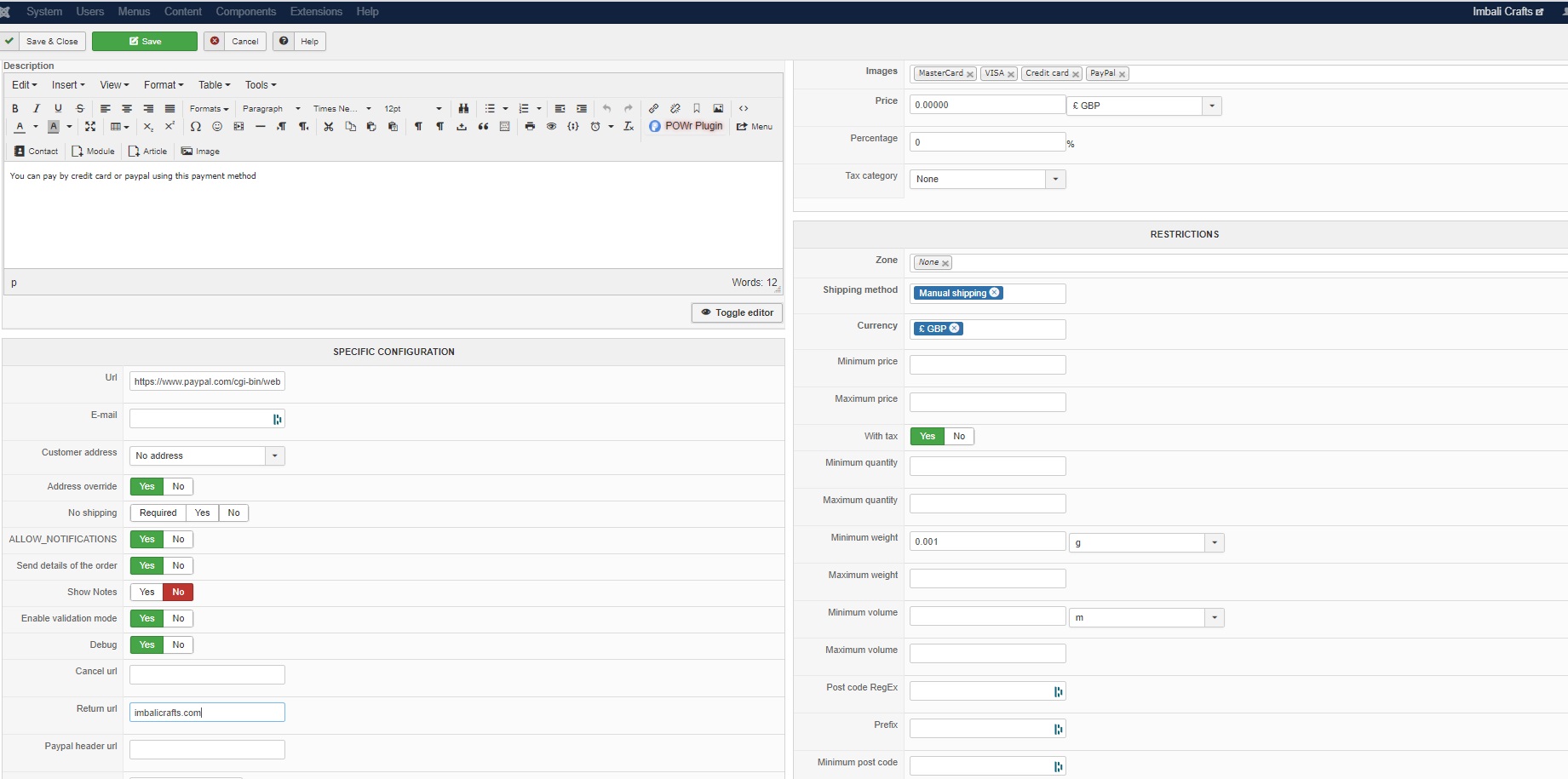

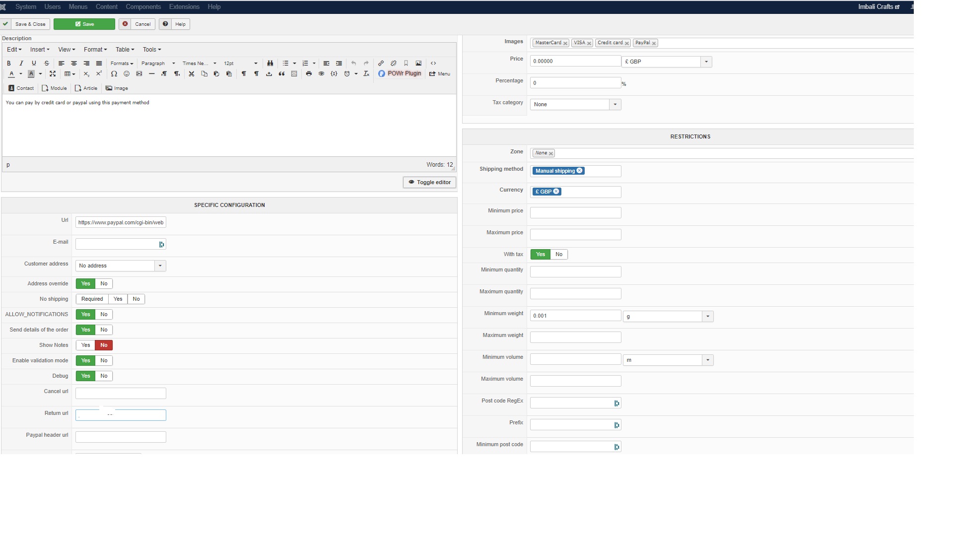

This kind of error generally occurs when payment methods are not properly configured, can you show us screenshots of how you configured your:
- Payment plugin via "Hikashop->System->Payment plugins"
- Checkout workflow via "Hikashop->System->Configuration->Checkout workflow"
Kind regards,
Mohamed.
  • Posts: 12
5 years 3 months ago #332968
I managed to fix the 'Things don't appear to be working at the moment. Please try again later.'
error and want to post my solution in case someone else runs into this issue. I have several email addresses associated with my paypal account and use one particular one all the time so it was the one I used to populate the plugin with. The problem was that this email address may be registered with paypal but it is not the primary email address. Only the email address used as the default email in paypal will allow the transaction to go through.
  • Posts: 12
5 years 3 months ago #333013
Hi Mohammed, sorry I missed this reply!
You were right of course. I had the 'Enable validation mode' set to yes in the paypal plugin. Finally fixed all the errors except for error code 10002, but I have just disabled express checkout for now. So the shop is up and running. Thanks for all of your responses and trying to get this sorted for me, it's much appreciated.
