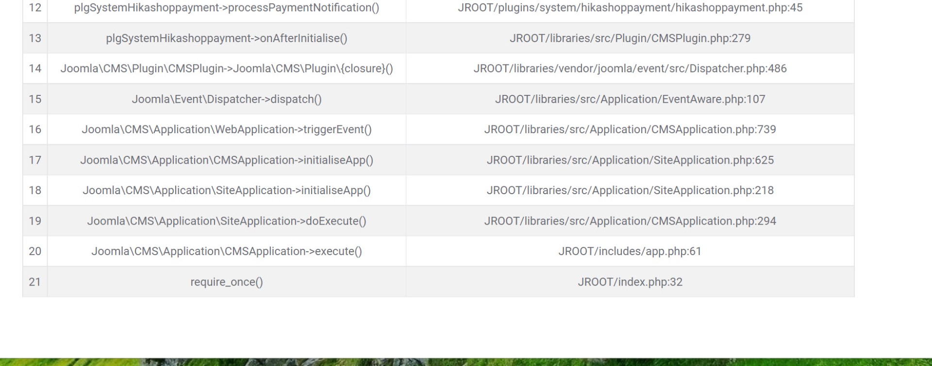

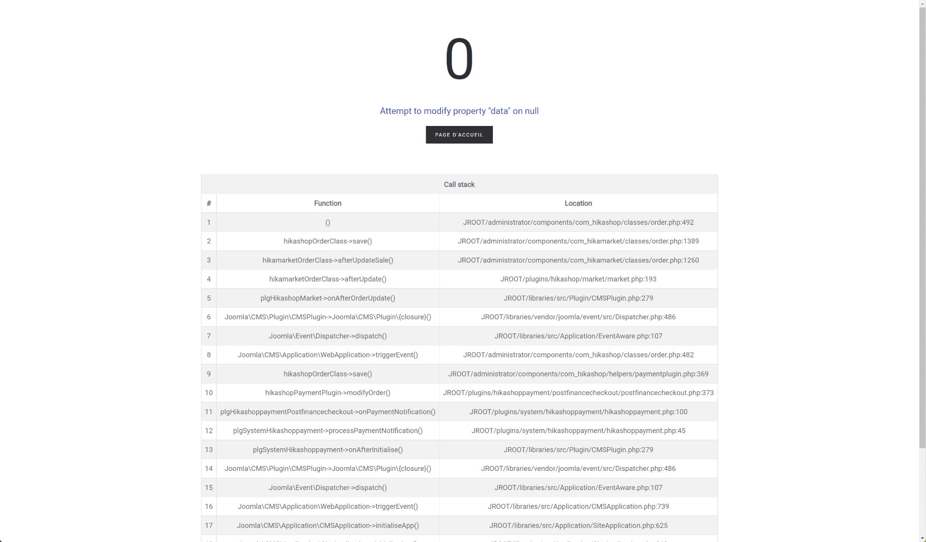

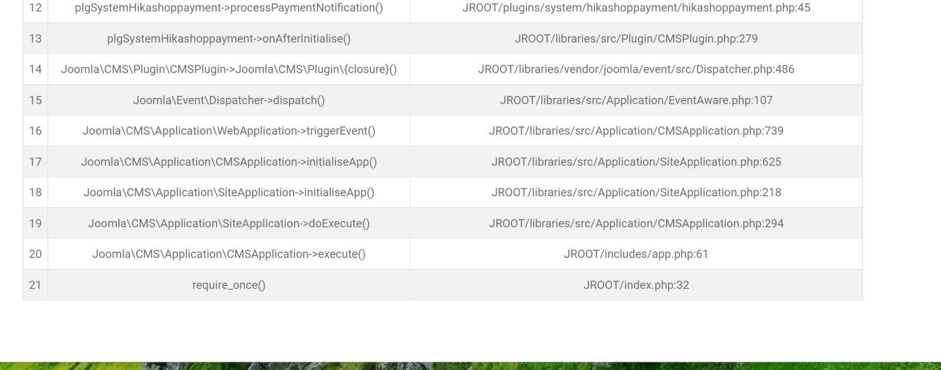

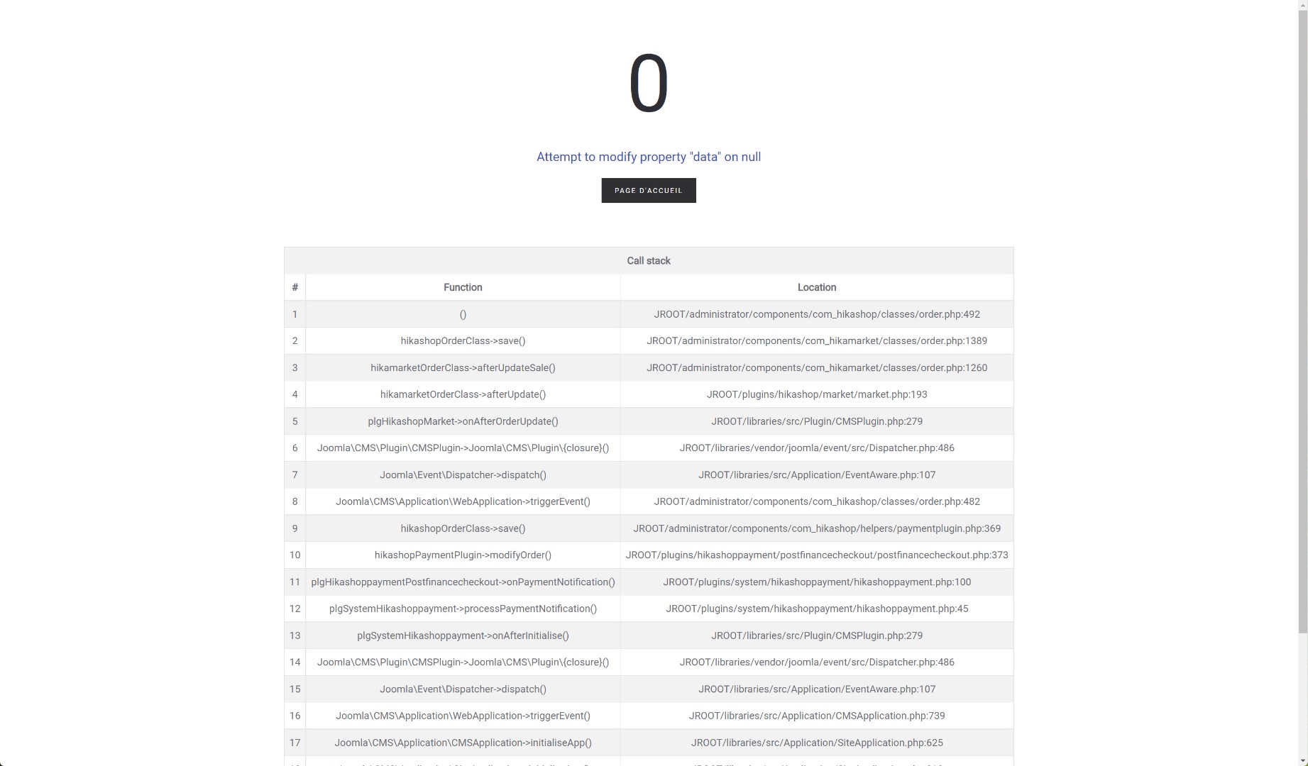

So I was able to do a test and there is a problem when ordering. It is well validated in Hikashop, but not updated in the cart. I have an error when I return to the shop after ordering, see my screenshots.
“Si tu ne travaille pas pour tes rêves, quelqu'un t'embauchera pour travailler pour les siens" - Steeve Jobs
"La sagesse, c’est d’avoir des rêves suffisamment grands pour ne pas les perdre de vue quand on les poursuit." - Oscar Wilde
  • Posts: 86220
  • Thank you received: 14223
3 years 9 months ago #347747
Thank you for the report of the error. In seems to be a special case, which happens only with HikaMarket, only on PHP 8 and only with some payment methods.
I've made a patch in HikaShop for that error. Download again the install package of HikaShop on our website and install it on yours and you should not have that error anymore.
Regarding the label of the options in the PostFinance plugin, I'll let TsukiDev answer.

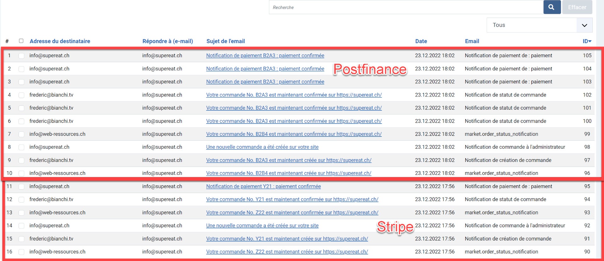

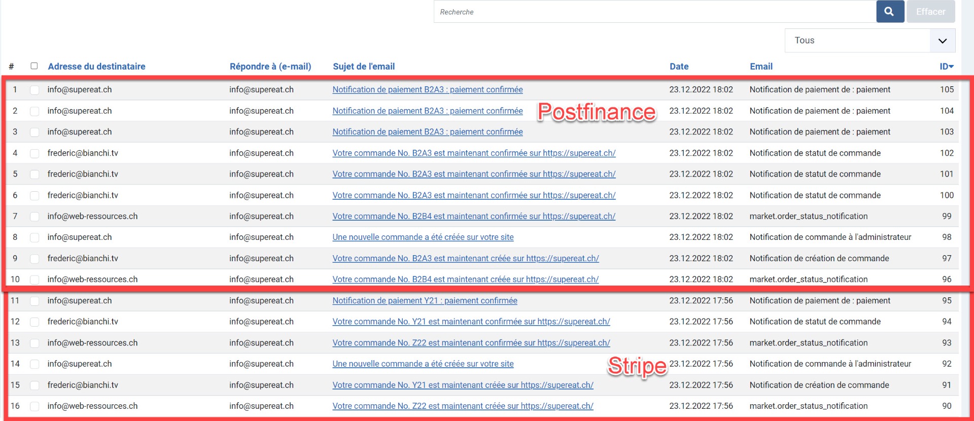

OK, so I did some testing.
I deactivated the multi-basket function and emptied my current basket.
Test with Stipe payment in test mode:
- Order creation OK, redirection on payment OK, redirection after payment OK, on white page with info "Thanks for your order, you can see your order here".
- Empty shopping cart.
- Order confirmed on admin side.
- No email sent (but email in email logs).
Test with Postfinance checkout (test mode):
- Order creation OK, redirection to payment OK, redirection after payment not OK, on homepage, no confirmation message.
- Shopping cart not emptied, with still the product.
I did a test of the contact form I have on the site, the email is sent by the server, so everything is OK on the Joomla side for that.
To summarize:
- The emails are not sent via Hikashop
- The Postfinance checkout does not work properly.
I precise that in the postfinance dashboard, the orders are here and confirmed. So it seem there is a problem with the confirmation to Hikashop.
Last edit: 3 years 9 months ago by thefbi.
  • Posts: 86220
3 years 9 months ago #347774
You said "No email sent (but email in email logs).". Do you mean that you see the emails of that specific order in the email history ?
In that case, the emails were sent by HikaShop to your email server.
If the emails didn't arrive to the recipient, then the reason is logged in the log of the email server.
You should contact your hosting company support and provide a screenshot of the details of an email from the email history of HikaShop which wasn't delivered and ask them to check in the log of the email server why it didn't arrive.
Regarding Postfinance checkout, I'm not sure as I don't know the details of how it works. TsukiDev will have to answer as to why the redirection to the thank you page wouldn't work. It's probably linked to the cart not being cleared as the cart is cleared on the thank you page.

EDIT : Sorry, i just make an other test now, and the emails just works...
I will make some other tests to see if ok now. Very strange...
So with Stripe all is OK.
And with Postfinance, i receive 3 times the same confirmed email. There is too 3x in the logs. Screenshots.
In that case can you :
- Enable the "Debug" option through your Hikashop PostFinance configuration page
- Test it again
- Send us an email with a temporary access to your back-end via tsukidev.contact[at]gmail[dot]com
Thank you.

Thank you for the fix. The order work now, but i have again the email problems.
I emailed you back but didn't get a response, so I'm not sure if you got my answer.
I always receive 3x the "confirmed order" email instead of one...
On the admin side: 3x the email
Customer side: 3x email
Seller side: 2x email
It works correctly if I test with Stripe
Thanks for help on this.
