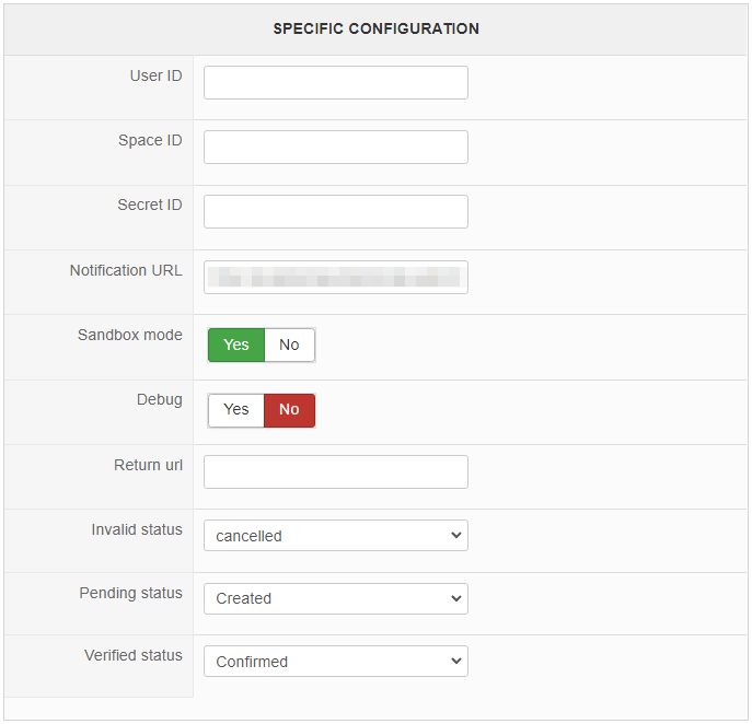

Additional Information
  • User ID: Your PostFinance Checkout application ID number
  • Space ID : Your PostFinance Checkout access token number
  • Secret ID : Your PostFinance Checkout location ID number
  • Notification URL : That link should be used to create a Webhook through your PostFinance merchant space
  • Debug : You can activate the debug mode of the PostFinance Checkout payment plugin. If you do so, informations about each transaction made with PostFinance Checkout will be logged in the payment log file. You can see and modify the location of this file in the configuration page of HikaShop.
  • Return url : The url you want your users to be redirected to when they finish their payment on the PostFinance Checkout interface. By default, they will be redirected to the after_end page of the checkout process which will thank them for their order.
  • Invalid status : Here, you can select the status to set to an order if the plugin receives an invalid notification from PostFinance Checkout for an order.
  • Pending status : Here, you can select the status to set to an order if the plugin receives a pending notification from PostFinance Checkout for an order.
  • Verified status : Here, you can select the status to set to an order if the plugin receives a successful completion notification from PostFinance Checkout for an order.

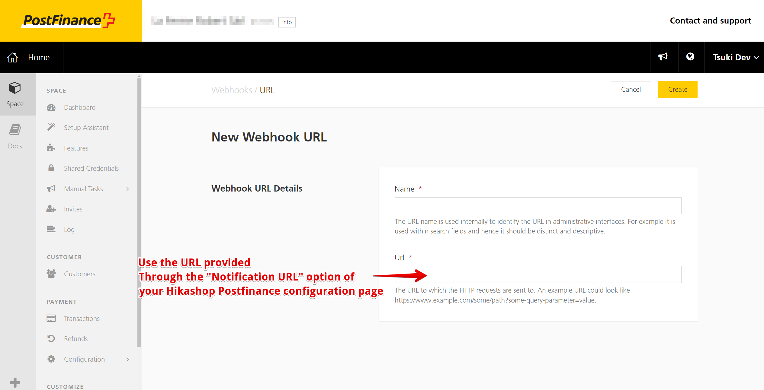

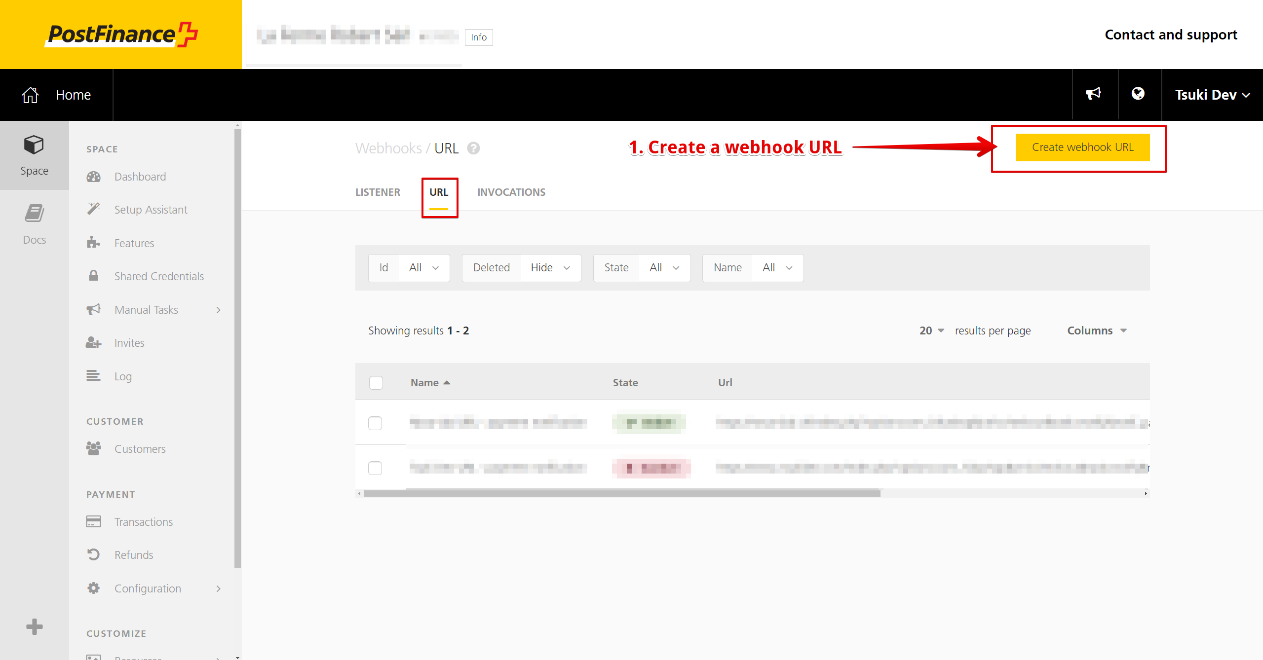

1. Webhook URL creation
The Webhook URL creation page is accessible through that button :
To properly configure it, you'll just have to name it and set the "URL" option to the "Notification URL" value that you can find through your Hikashop PostFinance configuration page :

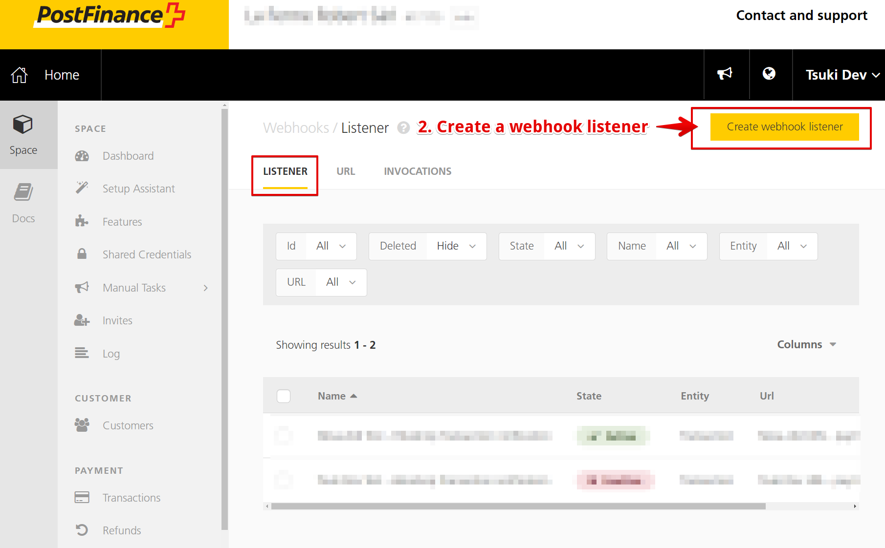

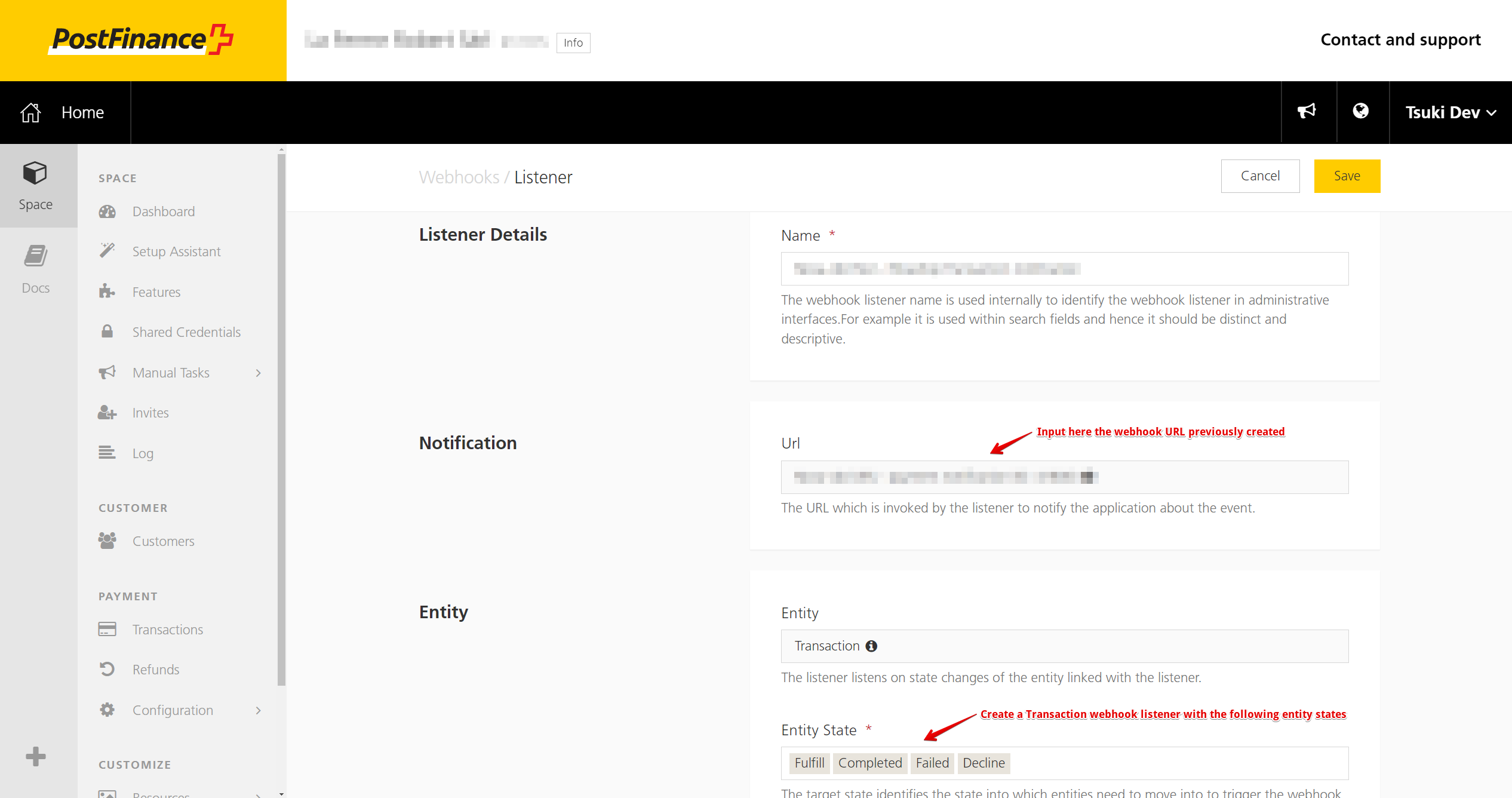

2. Webhook Listener creation
The Webhook Listener creation page is accessible through that button :
To properly configure it, you'll just have to create a "Transaction" Entity listener, and set it like this :
