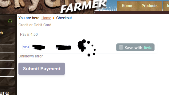

We use Stripe for our payment gateway, but this has stopped connecting the last 3 days. Customers are able to add their card details but the system then freezes and a small message 'unknown error' shows.

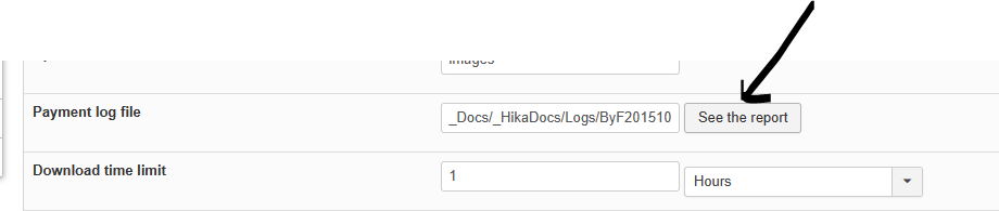

Regarding the logs, you have to open your HikaShop configuration page and click on the button "see the report" as visible/explained in the documentation page I gave you.
That log is there to store the error for payment plugins, its helps the debugging since it contains data that we don't want to let the customer see.

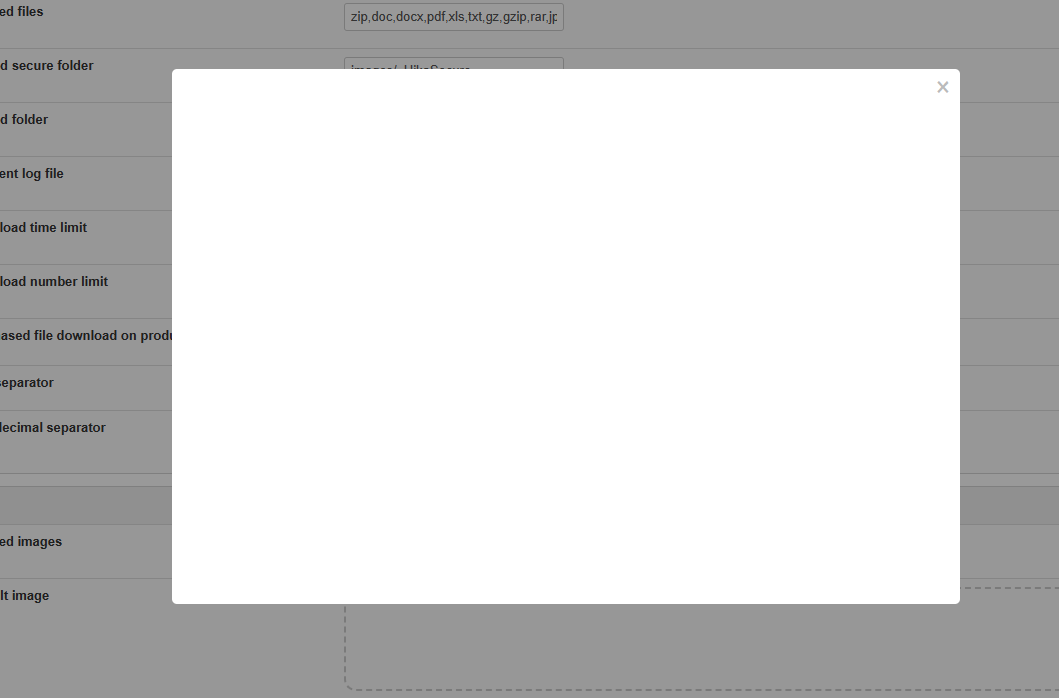

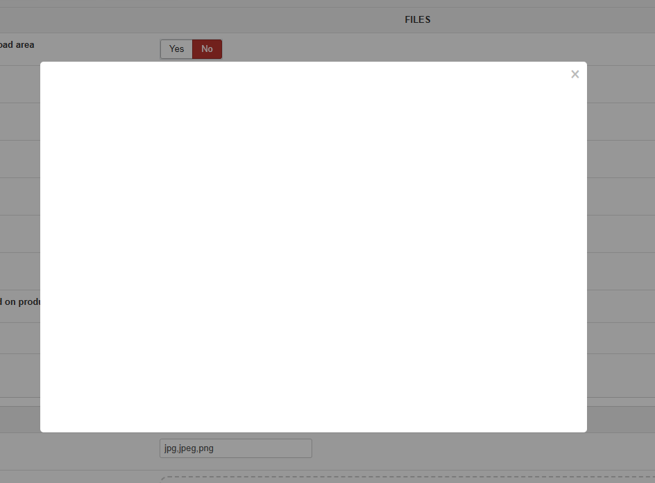

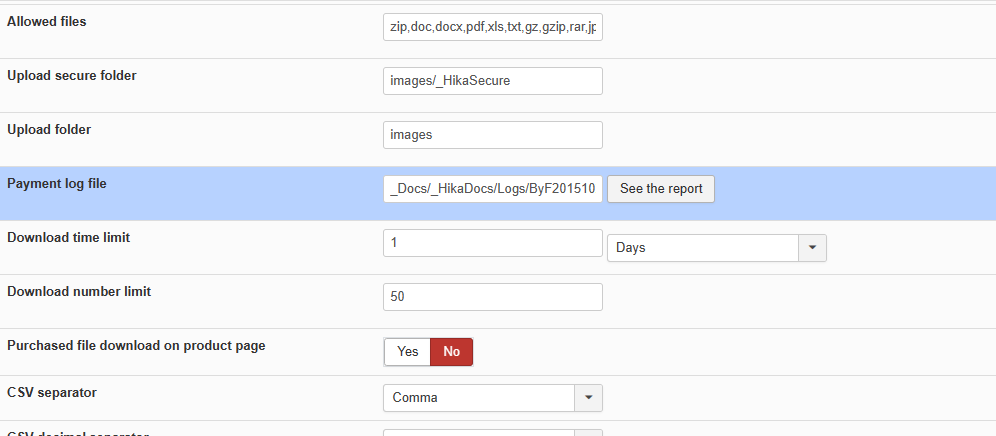

  • Posts: 60
2 years 11 months ago #356004
Hello Jerome
II think I may have found the area to which you refer , please screenshot attached.
1 is the pay file section to which I think you are referring
2 is when I click on 'see the report; and this is blank - so unfortunately gives no information at all

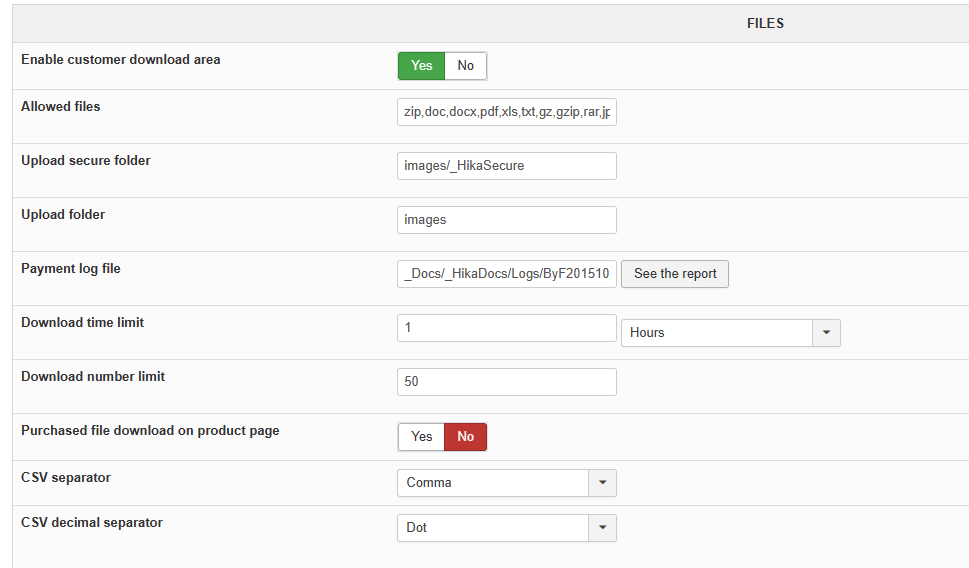

Please enable the debug mode to store more Stripe data in the logs.
www.hikashop.com/support/documentation/2...ipeconnect-form.html

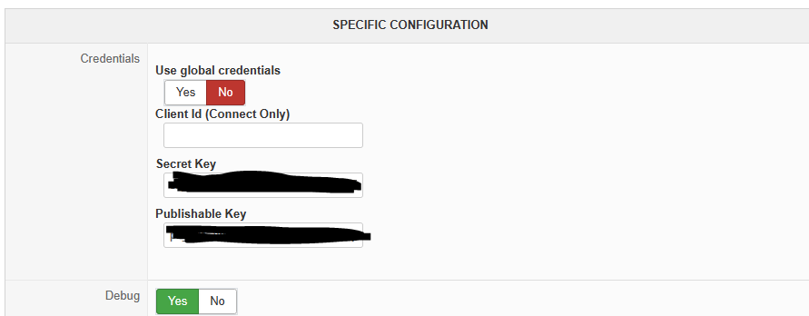

  • Posts: 60
2 years 10 months ago #356281
Hello, We have followed the guidance and made a test purchase, but the issue remains the same and nothing shows in the report.
If you could please provide some further guidance. We have been without the shopping cart for over a week and desperately need this working.
I have reverted the 'allow customer download' setting' to 'No' for now as this is how it has always been set.

  • Posts: 86220
  • Thank you received: 14223
2 years 10 months ago #356292
Once you activated the "debug" setting of the payment method and made a test purchase with the issue, you can click on the "See the report" button of the "Payment log file" setting on your screenshot.
It will open a popup with the debug information.
We'll need the debug information in there to understand what's wrong.
  • Posts: 60
2 years 10 months ago #356310
Hello Nicolas, That is exactly what we have done. see attached snapshot of Stripe configuration clearly showing Debug switch on. The issue seem to be that it is not actually reaching Stripe - just remains in an unknown issue status. It doesn't go through or fail just the 'wheel of doom'.
I have done another test payment now, same issue and nothing showing in the log.
